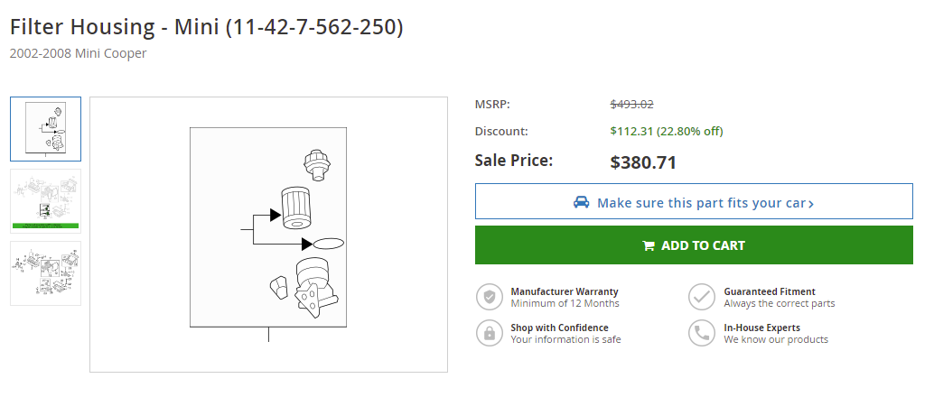

Was this the part # you bought?
https://parts.miniofkennesaw.com/oem...ng-11427562250
Expensive Lesson: Oil Sender Replacement-mm4gqle.png
Not much cheaper really, but every little bit helps.
Very curious to hear what brand of headers failed on you if you'd care to share.

Yes, that's the part I ordered from Pelican Parts. I wanted to do a more detailed search but my lousy internet connection here in the countryside limits me to just 10GB per month (exorbitant overage charges, thanks Verizon!) and I was already at 9.9GB so had very limited amount of searching. I had some other small items I was ordering from Pelican as well so just bit the bullet and placed the order. Next time I'll be more diligent. The header that failed was the Flashpoint I bought from Way Motorworks. I had it on for about 3 years when the flex joint failed causing a loud exhaust leak from there. I originally removed the exhaust and welded in a replacement flex joint. Unfortunately, the cheap Amazon coupling failed within 6 months. So, I again removed the header and welded in another Amazon coupling which fell apart as I was installing the exhaust!! Love that Chinese crap they're selling these days. Ordered the more expensive Milltek header and cat from Way Motorworks and it looks to be very good quality. I had just installed it when I decided to replace the oil sender since I had the header heat shielding removed giving slightly better access. Concerning the torque value: you're correct in that there isn't room down there to fit a torque wrench. I was using a stubby little 3/8" drive to limit the amount of force I could place on the sender but it didn't work. Now I have to drain the coolant and remove the entire filter/cooler housing to solve the problem. Only good thing is the new housing comes with the oil sender already installed so there's no risk of a repeat disaster.
