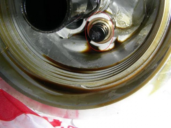

I have an oil filter nightmare I want everyone to know about so you may not run into the same hellish problem I have had…
So last weekend I figured to do a little routine maintenance, general look under the bonnet and a simple oil change. Things where going well and some how managed to spill only a few drops of oil, quite a feat for a MINI as the oil loves to drain out everywhere when you remove the oil canister… Everything when back together smooth and figured as with a thousand other oil changes that was that… Until I started it back up… oil light came on, as usual with an oil change as oil fills the canister for a few moments… but in this case the low oil light stayed on… Oh crap… must have left the plug out… Expecting to see oil everywhere, got out and nothing… Double checked everything very closely, everything looked fine, plenty of oil, no reason for it… Try again… Same thing, oil light wont go out… several different checks later and decide to take the oil canister out… low and behold under the filter is a small plastic part, that turns out to be the oil bypass valve… Checking on the net reveals the same problem in one other post:
https://www.northamericanmotoring.co...d.php?t=113820
Folks this is a cheap snap in part that could be replaced for less a $1.00. Not any more sophisticated than a simple PCV valve. Attempt after attempt resulted in being unable to get the bypass valve to stay into place. (turns out later the retaining clips that hold it in place had broken, causing it to fail) I don’t know specifically what caused mine to fail, but seeing how cheaply it is made, it could have been heat fracture or as easily broken from removing the oil filter. More digging on the net came up nothing. And of course out of warranty by 2 months… Ok bite the bullet, take it to the dealer, what maybe $65 to fix it, plus another oil change, right? Hell no, they informed me the entire housing would have to be replaced at a cost of $300+ with the labor brought the grand total for the repair to over $1000! We are talking about one hell of an oil change. Feeling like a complete idiot for what I had done to my car and really not knowing any better, I told them to go ahead and fix it… Holy crap I just spent over $1000 for a weekends worth of simple maintenance. On second thought I called back and asked them to reassemble and I would attempt the repairs myself, I figured If broke it, I can fix it… Not only that but we are talking $1000! It still ended up costing me $164 for “an hour’s labor”, considering removing the canister cover takes approximately 5 min to remove. What customer service, considering I walked in telling them exactly what the problem was, I guess I got a deal. Looking around, I found the canister new for $179 and later used for $100 at a local wrecker. Bought the used canister, unsnapped the $1.00 part and fixed my car myself in about 2 minutes…
In my opinion this is absolute highway robbery, I am really pissed off and feel betrayed by MINI. I have loved this car the whole time I have had it. Having this experience first hand has really put a sour taste in my mouth and has changed my opinion. Not only is the part so cheaply made to begin with, but MINI has to know what is going on here, why not make the cheap little snap-in part available for purchase by itself? This smells very fishy to me… Not to mention, but a real ticking time bomb, I was lucky it happened my garage, if this cheap part where to fail under load, it would result in immediate oil pressure loss, I can only imagine that there have been engines that have seized due to this cheap part failure.
The single biggest issue I have is what MINI causes you to go through to replace it. Sure you may make a simple flaw in the design, but to rape your customers for a cool grand when the part could be replaced by a 4 year old just doesn’t seem right to me… Sorry if this is such a long winded post, I am hoping this experience may help someone to avoid the headache I have endured…

Pics to come...

As far as what could damage this part... Honestly a brisk brush with a rag, a errant feel in the filter housing or maybe a sneeze could break this part, it is just that poorly made... I can only imagine as time passes these parts will become more and more brittle in the presence of hot/cold, hot/cold oil, I don't think my experience will be the last we have heard of this issue, by a long shot. My suggestion would be to be very cautious when doing an oil change and touch nothing inside the housing or risk a $1000 oil change... I don't know that I will ever risk doing a change again myself, of course I am also contemplating passing my MINI on to some other soul after this experience...

1. You are upset mini doesn't sell the part seperately. News flash, they don't make most of the parts in house. The valve is sold to mini with the housing, therefore it is to you with the housing. Also, the price is always highest at the dealer, all car dealers. It is higher because they source, stock and employ someone to look the part up for you. You also get a warranty with it. Do that work yourself and you save some money.
2. You are upset with the labor price. Well again, labor at a dealer is always higher and the quote you got was for replcing the entire housing (see line 1) not the repair that you did. Dealers repair cars by replacing parts, they don't repair parts.
3.YOU broke the part. It is held in place not only by it's clip, but the pressure of the filter on it. There isn't any way for it to brake unless someone reaches in with a rag and brakes it themsleves. Yeah, I said it!

It's probably not designed to handle any significant side-to-side pressure, so if you were to hit it from the side while wiping out the inside of the housing with a rag or something, it would probably be pretty easy to snap off. But if all you're doing is screwing the filter canister into the housing, you're not going to put any significant lateral load on the bypass valve.

Scott you bring up an important point, but I any friction on the head of the oil filter against the bypass valve when installing or removing could potentially create side pressure that could damage this part. Maybe a good idea to put some oil on the front of the oil filter when installing. It looks like MINI has recognized this problem because it appears the valve was changed in later versions. BTW I have an 2004 MCS
pics included that show the back with the clips and the housing with the missing bypass valve. Sorry but the pics with it installed didn't come out, but it does look exactly like the previous post.
