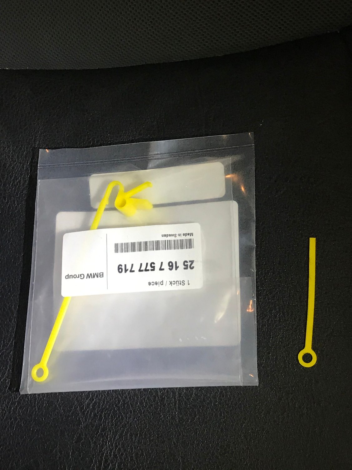

I’ve purchased the piece already. It looks like I snapped about 2.5 inches off of it.

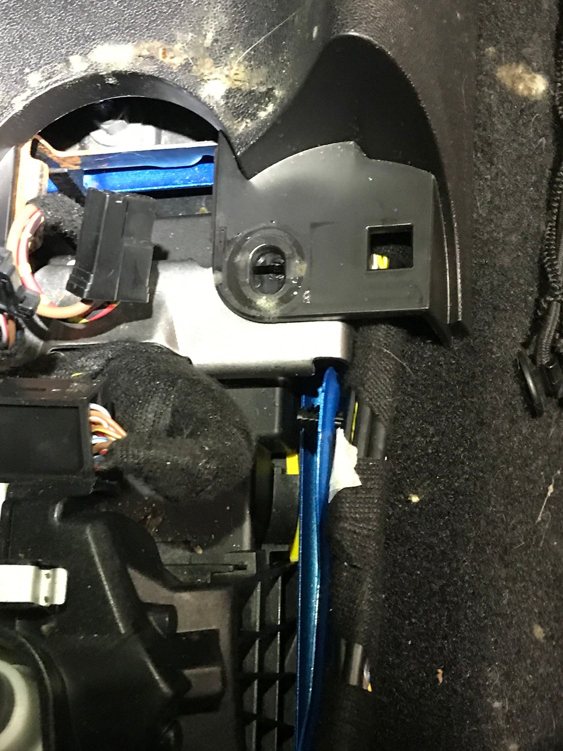

Thanks! I was able to take off the trim to expose the silver piece and remove it with your instructions. Under that is a black box that snaps out from the front first. Then I snapped the replacement in half trying to feed it in from the front!! There is not enough clearance between the guide for the yellow tab and the frame at the point I circled in red in the pic attached for the circle on the yellow tab to fit through. So I ended up dropping the exhaust and gear shift bracket and installed (yet another) new one. I appreciate your guidance!
