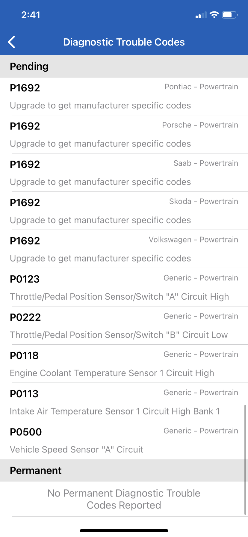

Hi there, I have an 05 Cooper s and I Just replaced the sc in my car, and a few other components (ball joints, radiator, all cooling lines, oil cooler, heater core, shifter bushings, crank sensor, belt tensioner, oil filter housing gaskets, water pump). The car started fine ran for a bit then developed a bit of a rough idle after a bit, so i shut it off and made sure everything looked okay, went to turn it back on and it would just crank with no rpm signal. I found out im not getting spark, I changed the coilpack and still nothing. What next? Here are the codes coming off the car. Thanks in advance.

Change the crank position sensor (in the front of the engine). Also, do you get a spark now?

tried 2 different crank position sensors but still no change and no spark
