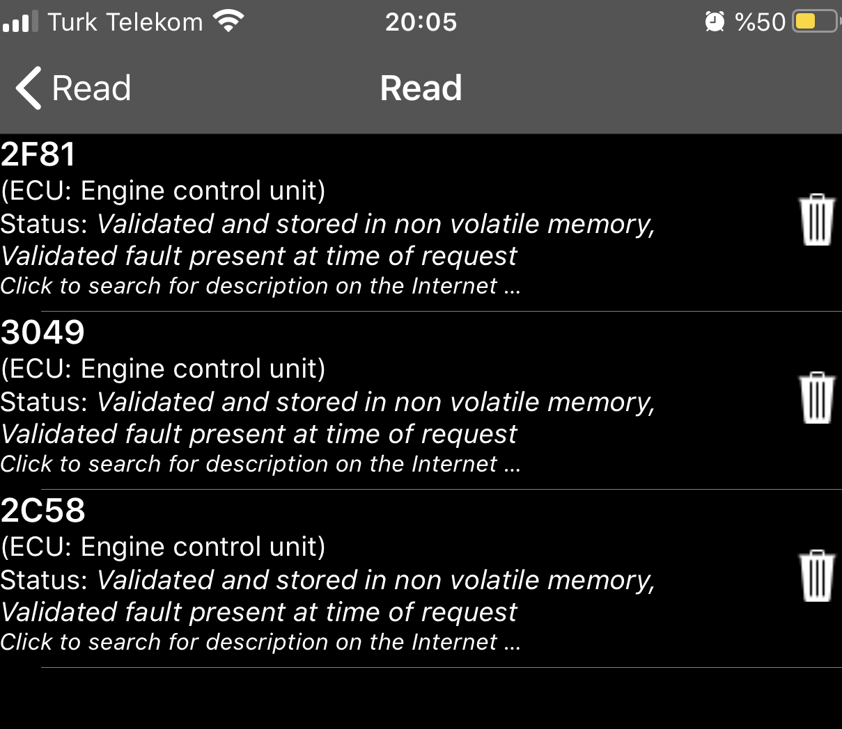

I think I found the problem. When I removed the knock sensor on my engine timming(I didn't unplug it), then it is well.(I am getting code about knock sensor, and turbo boost code(2c58)) I saw there is no red threadlocker on my sensor nut. what kind of red threadlocker value I should use on the knock sensor nut. I tried locatite, now timing is better then before but isn't well yet. I am getting still negative timing. Can you give me your greatful ideas about my issue?
(I changed to the knock sensor new one, sympthoms are same.)

you should try walnut blasting to fix super knocking if you can. i am also a fellow turkish mini lover but there aren't many people around that knows how or even why you should do it. my n14 is around 200k kms and it barely works good anymore and i believe this is the biggest issue. you can check "minipassion forum" and ask to the guys out there, mini community in istanbul is luckier than other cities since there are bunch of knowledgable guys around. but still, generally turks are not aware of this problem. even borusan and other authorized services.
also, for 2c58, check vacuum lines, tighten every clamp you can see and maybe do a smoke test to see if there are any leaks anywhere. also, this might be related to the vanos selonoid, remove it and clean it, see if it helps.

But they didn't resolve my issue about timing. I went to couple of services ( without local mini service.)
My mini engine and other components are new. Almost everything are changed or tested even ECU. I got fault code (2c58 and others) when I removed the knock sensor on my engine. Normally I don't get any fault code. I ordered knock sensor nut(red threadlocker) on ebay. I couldn't find it in Turkey. They didn't order for Turkey before even Distributor of mini cooper Service. I will try the nut. I hope It will be resolve it my Knock issue.
