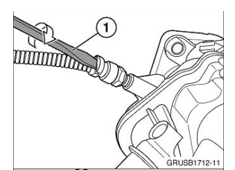

Where is my Thermostat Bleeder Screw
See attached image. I don't see a bleeder screw. It should be where the circle is. How do I bleed the coolant system with no way to bleed the coolant system?
The image is looking straight on to the vehicle and down toward the thermostat, HPFP on top.

It can be tough to find, but it should be there, it looks like you need to look just a tad further back, almost, but not quite under the edge of the fuel pump.
you can barely make it out, but I just took a photo of mine, if you look really close you can see the cross in the head. It’s a plastic screw, and may be under the wiring harness partially.
What year is it? This photo is an N18
Look really close where it’s circled and you may be able to just make it out.

The sensor is the actual bleeder screw.
Who designed this car...lol
If you go back and look at my picture, you will see a line on the sensor. It is partially obscured by the wire protector. If you pull the wire protector to one side, you can clearly see that the sensor has a line to hold a flat head screwdriver blade slightly off center. I will try and turn this eventually and it will either turn as a bleed screw or I will need a new sensor.

Yes, there are two different screws for them depending on your thermostat, one is a larger size and the temp sensor was redesigned I believe.
Be careful! Don’t unscrew it more than 5 turns or it may shoot out of there under pressure and be lost. (Ask me how I know, lol)
just loosen it a bit until the air starts to burble out. I always have a spare one handy in my desk, just in case. Because I’m 25 miles from the dealership and I had a real nice stream of coolant shooting out! Ha ha. I made something work temporarily, but then went and picked a few up since they are cheap.
live and learn!
Good luck, let me know if I can help from long distance.

I just found this TIS service bulletin (attached).
N18 engines up to March, 2013, they put my type of sensor in (https://www.ecstuning.com/b-genuine-...r/13628603908/)
It was a stop gap, where they basically just removed the bleeder screw out of the old thermostat designs and added this second sensor into the top of the thermostat as a sensor/bleeder screw combo and then t-d it off to the other MAP sensor from the computer.
You can't even get this thermostat design anymore.
Like everything else on this car...it is a problem waiting to happen.
