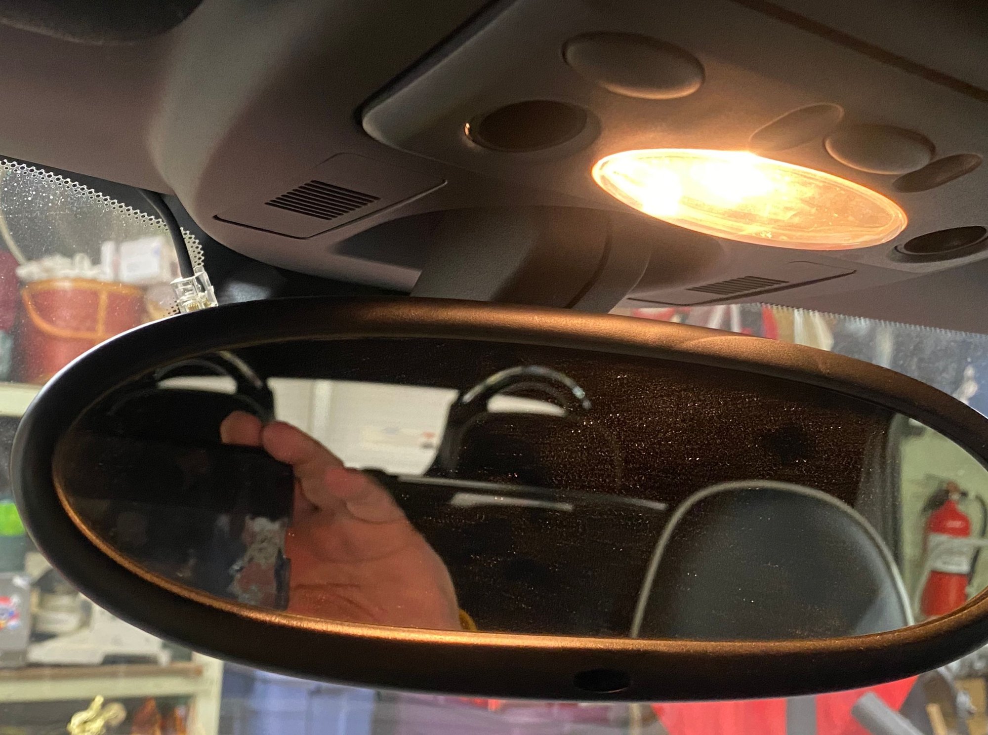

I do have an r52 with the convenience package. Let me know if I can answer any questions provide any photos for you.

Here are two photos for reference. Looks to be the same as a hardtop convenience package. Let me know if you need anything else.

Tgauk - Do you have homelink (3 button on rear view mirror)? Convenience package on my hatchback had homelink (on rear view mirror), rain sensor (with auto setting on wiper stalk), auto light (with auto setting on light stalk). Not sure what the convertibles have. Pretty sure my sidewalk has auto dip
rear view mirror. Not sure if that is compatable with rain sensor/auto light setup.
Agree that it looks like all components are same (except for rear view mirror?) between coupe and convertible. The windshield appears to
be PN 51 31 7146545 and price doesnt appear too bad. Might be easier to have glass place bring a new one and have it put in.

Yes my mirror has the garage link buttons on the bottom left and the wiper stalk has the auto wiper as well as the auto setting for the headlights.
