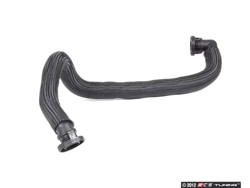

What is this pipe?
This pipe sheered off when I was trying to get to my throttle body. Is it for the solenoid? Is it hard to replace? My car sounds like it has a bad vacuum leak right now.

Actually I think this is the PCV?

Yes.
Hose from pvc in valve cover to intake manifold.

Thanks. Is this easy to replace. It's certainly cheap, but looks like it connects underneath the intake manifold?

You have to pull the intake box off and yes it’s connected to intake. I blocked mine off and car runs fine. The two plugs are cheaper than the hose, 25 bucks shipped from ECS and yes I do have an OCC on the other side.

I ordered a new one off RockAuto for $20. I was trying to replace my throttle body and just slightly moved the thing and it broke in half.

Mine is plugged off at the valve cover
with a BSH dual boost tap and have
a BSH OCC on the other side of the
(N14) engine.

Reviews are mixed on blocking it off. I decided to replace it with an aftermarket one for about $35. It's relatively simple to change, the airbox and that resonator into the firewall need to be removed and you should have access...

Here is the part and it connects near the manifold.
https://www.ecstuning.com/Search/Sit...h/11157605186/
digram https://www.realoem.com/bmw/enUS/sho...15#11157605186

I decided to go non-OEM with the PCV hose, because it was much cheaper. I got the Vaico one. However, when I put it on today, it didn't seem to bend correctly like the OEM version. I had to really force it on the connection to the intake manifold. I did hear it click, but it doesn't seem like a fully flush connection. It was quite difficult to get on. I pulled on it and it wouldn't come off. Do you think this is okay? I'm not throwing any codes anymore and everything seems fine. Idle is good and I don't hear any air leaks.

I see a few terms being thrown around a little loosely on this thread. That PCV pipe goes from the back of the valve cover to the throttlebody, not to the intake manifold. If you remove the air cleaner housing and the resonator behind it you have decent access to the connection at the throttlebody without having to remove anything else. It does take a little bit to release it at the throttlebody, but look at the connection at the valve cover to orient yourself to where the two squeeze points are on the locking collar. It's the same at both ends. I was fussing with mine for quite a while before just replacing it so got to a point where I could re and re it in about 5 minutes. I agree if the CEL is not shouting at you, you've got it figured.

Huh? The throttle body is on the other side of the lower manifold. I just replaced that today too, because the plate was stuck slightly open. Maybe it all connects to the throttle body somehow? Either way, thanks for the reply. I'll just have to monitor it and see, but I think it's okay. Thing was quite annoying to get on. My OEM hose was bent in a more dramatic angle to fit on easier.
