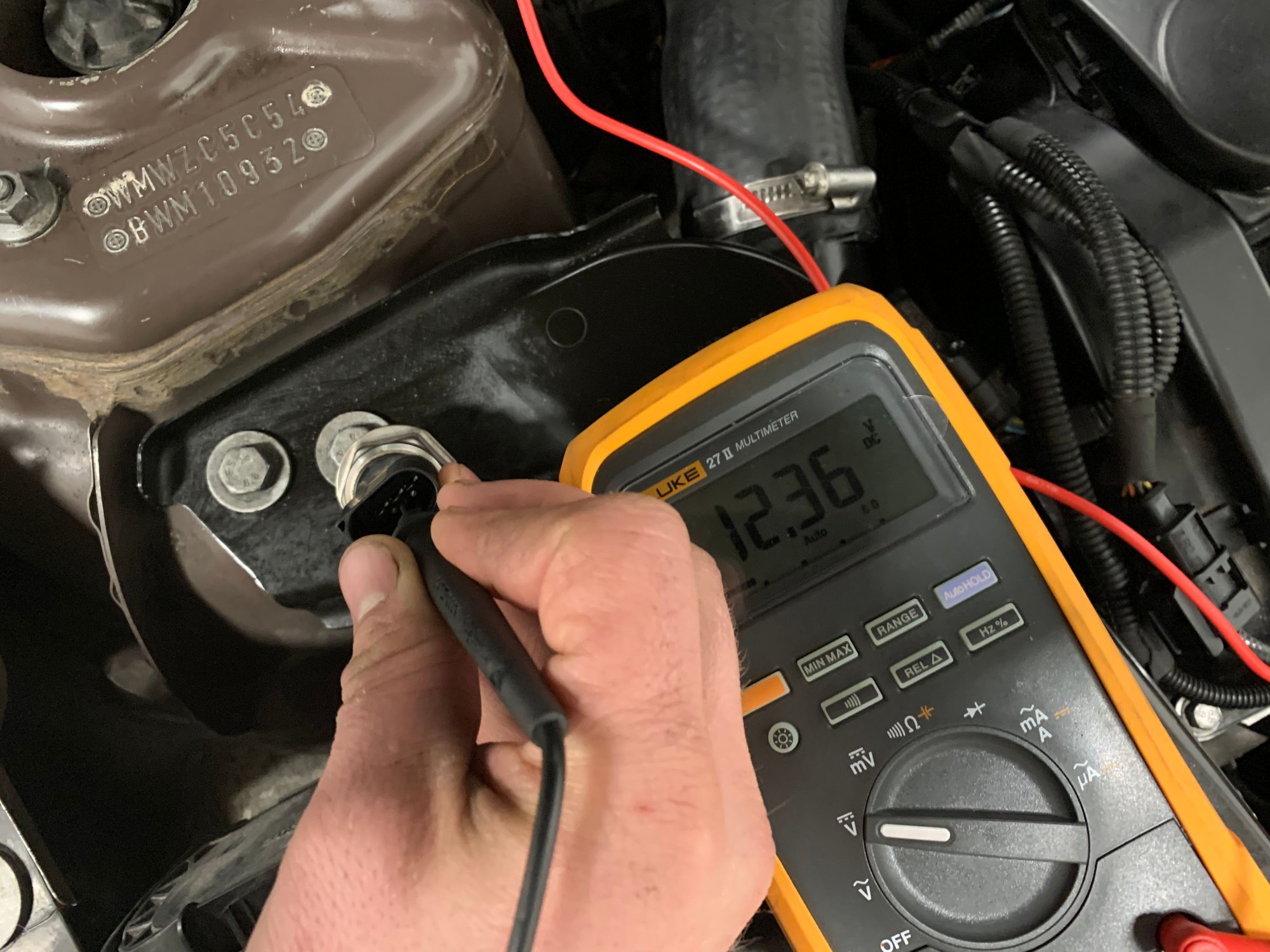

I can’t seem to find a test process on testing the sensor itself
i checked voltage unplugged KOEO I have 5v to both outside terminals and 0v to the inside. I have 5v between the outside terminals and the center terminal.
is there a resistance reading for the sensor?
I was checking to see if there was any at all and also notice that I have resistance between all 3 terminals and the body of the sensor??
Old Nov 20, 2019 | 09:47 AM
Jeff k's Avatar
Jeff k
Joined: Nov 2019
Posts: 23
Ok so today
Sensor That will be replaced with PN# 13537537319
I tested ohms on the sensor between all three terminals along with checking to see if power actually went through all of the terminals to ground and I get voltage from all three terminals so I think there is some type of internal short on the sensor.
I ordered a sensor, sensor I ordered is PN#13537537319 since mini only offers that sensor as a whole rail assembly I ordered one for a BMW hey different model same threads same plug.

H
Pictures of Checking through voltage battery positive to sensor pin and grounding sensor out

Alright New sensor was tested and the code to not come back. Solve a lot of problems with the knock sensor malfunction the computer being possibly bad that is all gone now.
