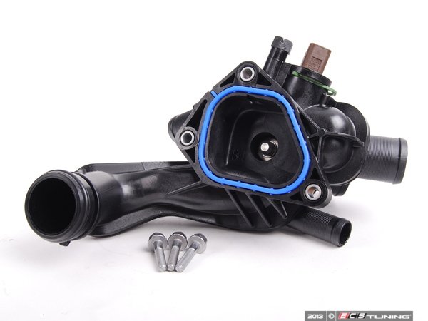

Installing these helps a bunch. make sure when you make the thermostat into the waterpipe connection that the thermostat is flush on the side of the block. A Little grease on the o-rings helps the pipe slide into the back of the waterpump and into the thermostat.
Most of the time when we see things leak afterwards they missed on the install and something did not seat well. if you have a probelm with a part you can always hit me up on the DM here, or set up a return with our team.
