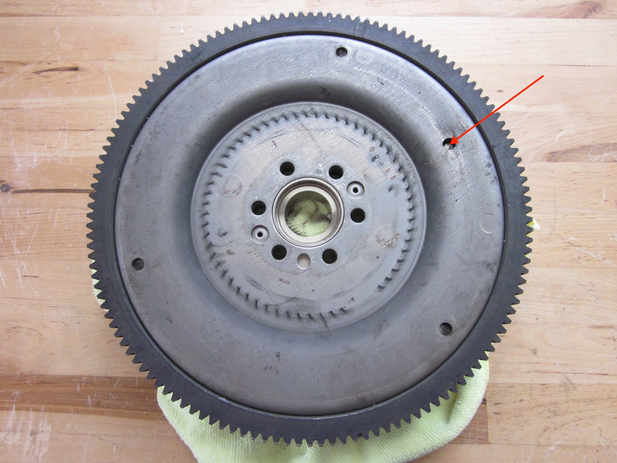

Just now, I reinserted the flywheel pin. The interwebs said it goes in halfway and I found that I hit the raised recess on the flywheel yesterday that locks it in the cw position. Today, I layed eyes on the actual hole with a mirror and flashlight, and the oin goes in further. Guess what?
Intake cam was 180° out! Put cam tool on and loosened cam sprocket to get everything in time. Tightened back up and ran a compression test.

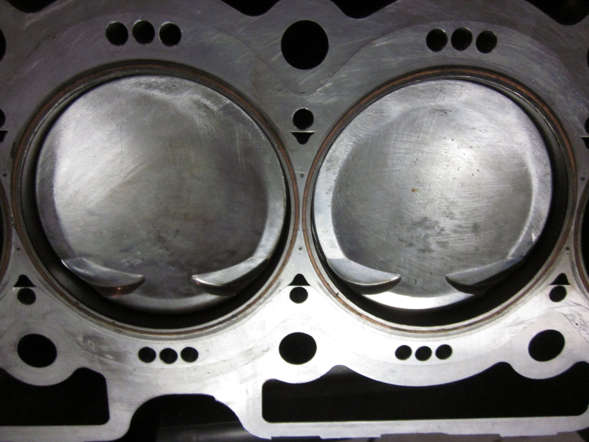

Here's a couple pics you might find interesting ---
'07 MCS flywheel showing locking pin hole. Other similar holes are probably for balancing.
Dinged piston from really bent valves. Note it's a 9.0:1 CR and has a recessed top. All four looked like this.
Here's the same piston with the dings ground out. Lost some symmetry and all were re-balanced, but performance is still pretty good.

Interesting. Thank you for those pics. It appears as though the intakes did not hit the pistons...somehow.
The exhaust valves open wide. And the intakes open only a tad as pictured when turning the cams with a wrench. The other intake valve on each cylinder opens even less! ALL intake cam lobes mic out roughly the same...1.632".
I notice that there is a separate actuator that turns the cam lift further? I have a Bentley manual on order and on its way.

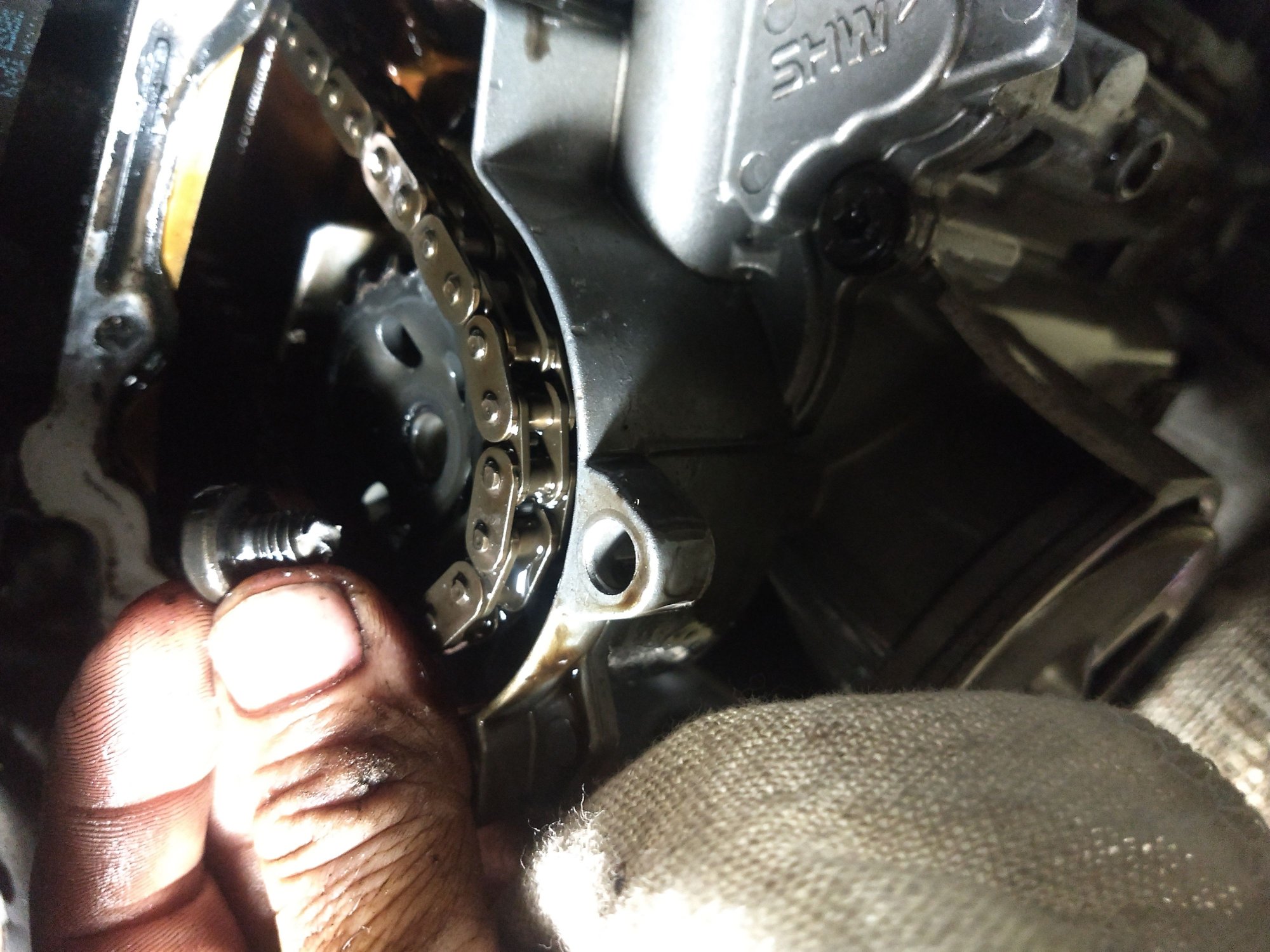

Bought a used pump and had it installed two hours later. I let the oil pan gasket material setup up overnight. Started her up this morning, good oil flow. Runs perfect, absolutely dead quiet.
I think we're out of the woods...​​​ I'll have to say. I get it now. I absolutely LOVE this car. I took some sharp turns and it was hilariously awesome how it stuck to the road!
