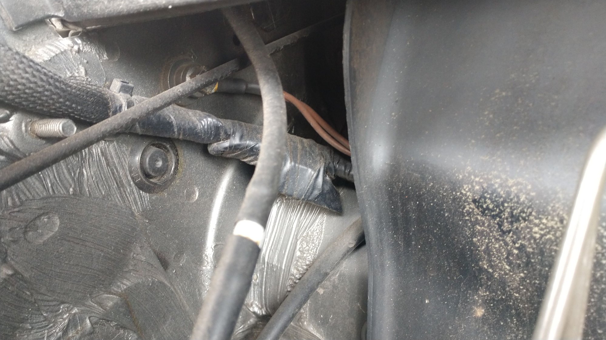

Is this the ground distribution you were taking about?

Or this one?

From: Southern oregon
They all look corroded from here!
You need to clean everything to bare metal on the body parts.
The nested one on the fender looks like crap too!
This is a common issue!
