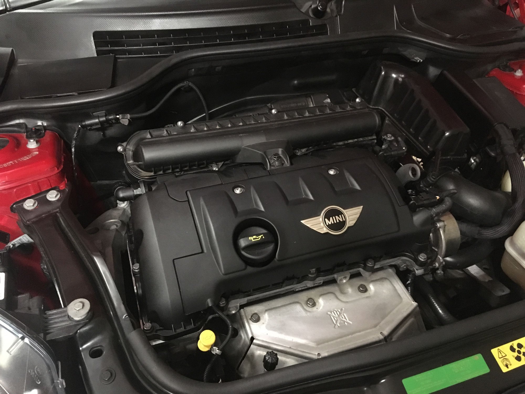

I started the engine for the first time this morning (yay!) but rather than seeing blue smoke from excess oil coming out the tail pipe is came up through the engine bay. It's pouring out the join between the manifold/cat pipe and the mid pipe.
Leaking exhaust clamp
The clamp is new and is this one from @ECS Tuning https://www.ecstuning.com/b-genuine-...p/18302756351/
Any suggestions? It's done up pretty tight, but I could turn the bolt a bit more - was worried about deforming the band? Or is it more likely that the pipe joins aren't seated correctly? I've not use a V clamp before.

When you're installing the exhaust headers, did you completely install the header flange bolts first then go on to install this V-clamp to join up with the exhaust? I suspect you may want to loosen up the header flange bolts and the V-clamp a little bit. Then tighten the V-clamp first, and lastly tighten up the header flange bolts. There could be an angular in-precision created when you tighten up the headers first. I could be wrong, only did service on two N12 coopers so far, most of my experience has been with N14's. And down pipe can be a lot different than headers of the N12 to work with.

I did the clamp first... my wife held the weight of the header downpipe while I did the clamp.
Which bolts on the exhaust to loosen? I’m not sure what you mean by the exhaust flange. I don’t want to loosen the top of the manifold with a new crush gasket just installed They aren’t easy to reach with the car all back together!
Am tempted to use some exhaust paste...

With a v-band clamp, you want to make sure they are well lined up before tightening the clamp. If there is any misalignment, the clamp will not pull it together, and you will get a leak.

+1 make sure that the two pipes are aligned and the flange is straight with mating on that bevel.

All buttoned up and exhaust no longer leaking.
No error codes from short bit of idling (a bit of smoke from oil cooking off though).
