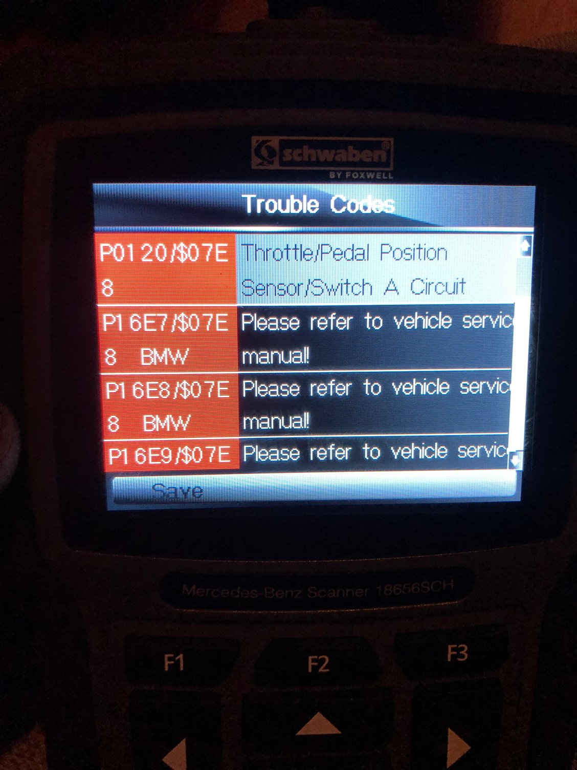

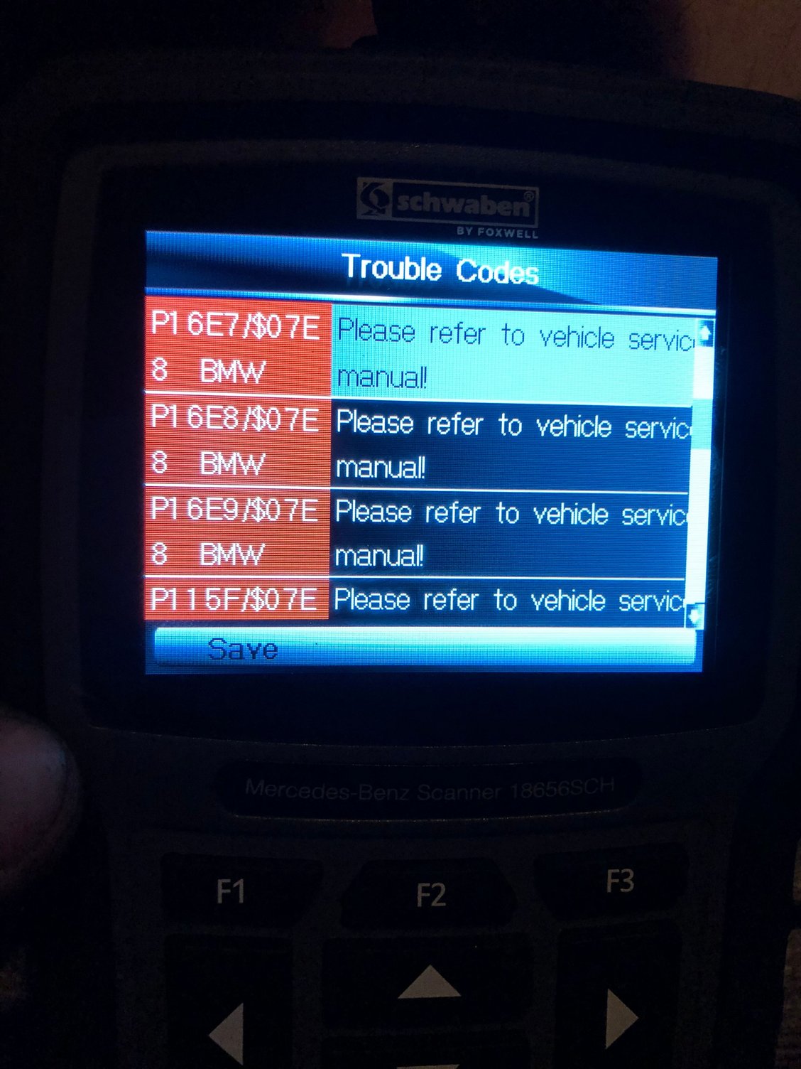

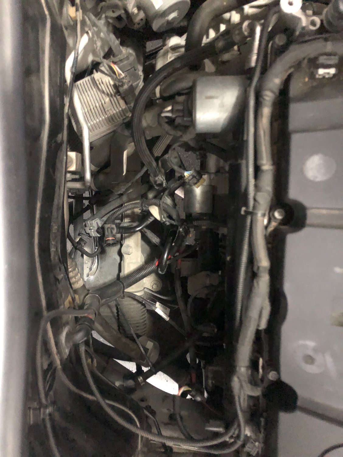

After purchasing the schwaben tool I still have the following codes.

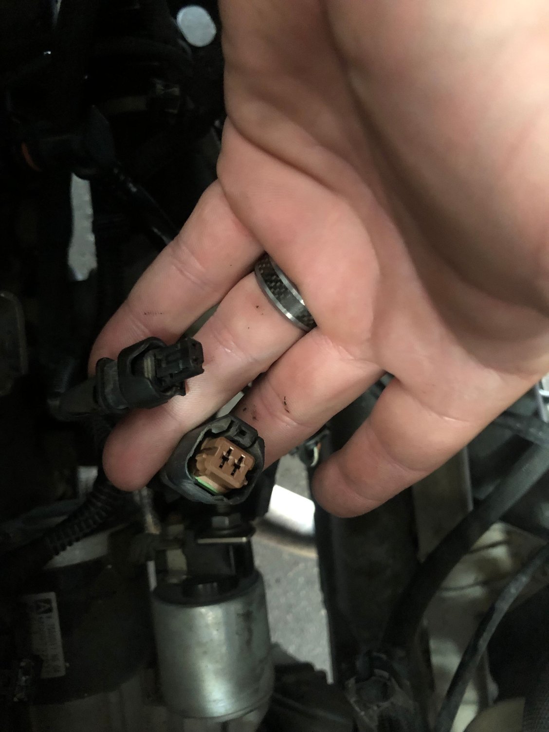

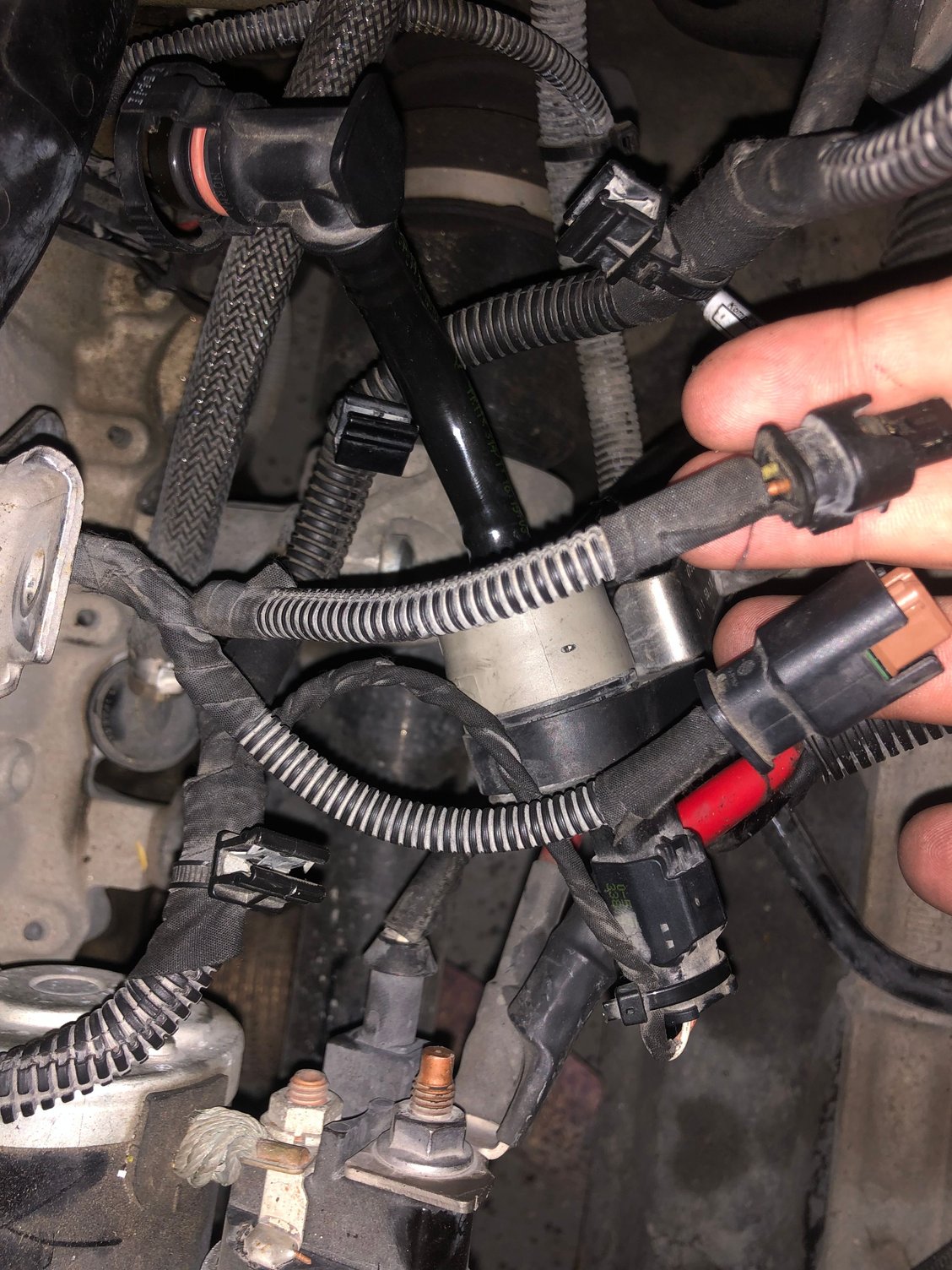

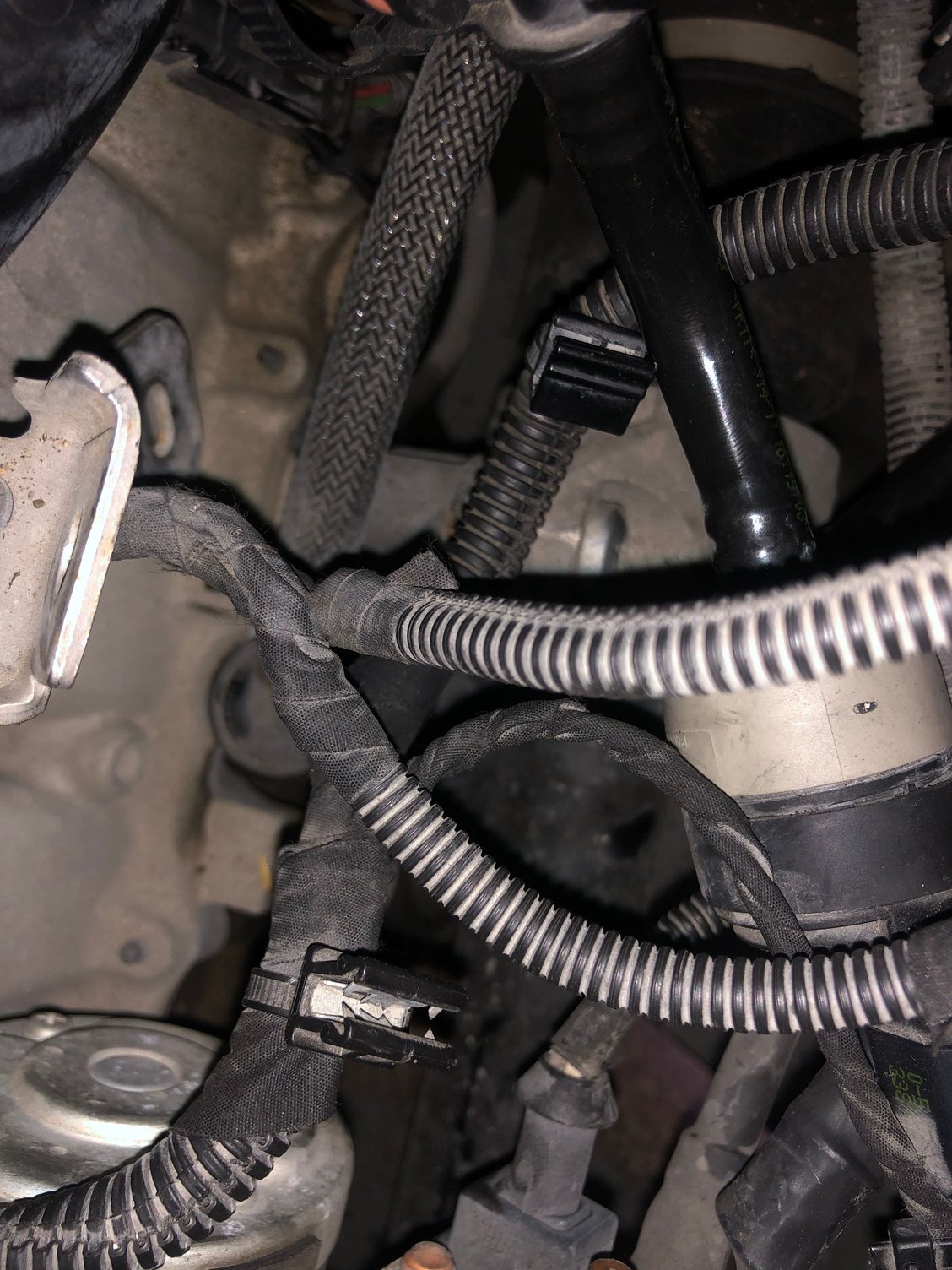

i managed to find that the vent hose from the crank case was broke in half and replaced it. Since then the car feels like it has gotten worse. It now surges when coming to a stop and between 700-1000rpms at idle back and forth. When trying to take off from a stop it struggles and stalls and almost dies.
The last 2 pictures are of 2 electrical connections. The black one on the left wasn’t connected to anything and I couldn’t find what it goes to. The one of the right connects to the sensor on the valve cover vent hose. If this is suppose to be connected to something some guidance on where that connection goes would be awesome!

Did you get this fixed. Could you take a wider picture of where you are in the engine and of what wiring harness those come out of. Thanks.
For the P16xx codes, I would start in the fuse box in the engine compartment. Check all of the fuses. If they are good, check the fuses in the kick panel. I had a problem with the #4 engine fuse blowing and getting similar symptoms.

I haven’t gotten it fixed yet or figured out where the plug goes. Here’s the only pictures I have. I’ll check the kick panel box today. I already checked all fuses in the fuse box in the engine bay.

The larger looks like the hpfp fuel pump and the smaller looks like the thermostat.
Does the base model have a hpfp?
Also so I replaced the throttle pedal and also the throttle body trying to take care of codes P0120 and P115F. It didn’t fix the issue.
