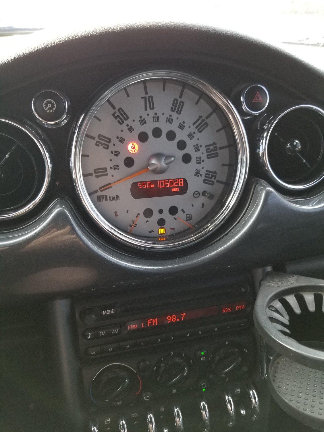

Hello all, I had a p1498 code about a month ago, decided to reset the ECU via the torque cell phone app for Android. It's been weeks now and the last one won't flash to ready. Sometimes the EML light turns on while driving, but there is no code or pending codes.
Any ideas?

Can anyone confirm that the "Not avail" monitoring flags shown in the torque screenshot below, appear correctly, and should not show any other values? My 2005 MCS failed state inspection the other day (likely due to lack of proper drive cycles since doing some repairs with battery disconnected). I did some driving immediately after the 'failure" at the inspection station and connected to torque once I got home from the drive.
My car shows the same "Not avail" flags as shown below but has all others showing "Complete" so I'm hoping I will now pass the re-test.
Thanks in advance!
