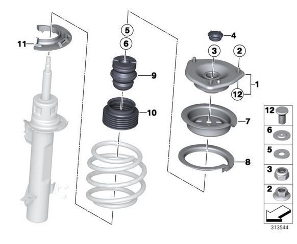

Some parts can be reused; others should be replaced. Good grief ... we're talking 20 bucks per side. Pull the part numbers from the link below, and run it through Google to find the best price. I put Bilstein shocks on our MINI back in 2015. Very pleased!
https://www.ecstuning.com/b-bilstein...22-215949~bil/
http://www.realoem.com/bmw/enUS/show...diagId=31_0777
8-11 should be replaced, why spend hundreds of dollars on struts only to save 40 bucks on some plastic/rubber bits that are worn out?

Thank you for all your help!
I will replace the struts, 8-11, as well as #1!
I'll be sure to post some pictures when it's all said and done! Wont be until July, however, because of travel etc.

Oops, I forgot about #1. Sorry about that. In the context of the thread, we were talking about the rubber bits, but the upper strut mounts should always be replaced. Don't forget to ask your alignment shop if you need to cut off the alignment pin on the upper strut mount before you install them. What my shop told me when I took my BMW into the shop is that pin has to come out to adjust camber angle. I confirmed this in my Bentley service manual, but you can't unscrew this pin on the aftermarket strut mounts.

Yes I would replace those mounts. But the rest of the parts I wouldn't bother as I have customers with over 250k miles on all those stock rubber and bump stops. If there isn't anything wrong with them save your money.
