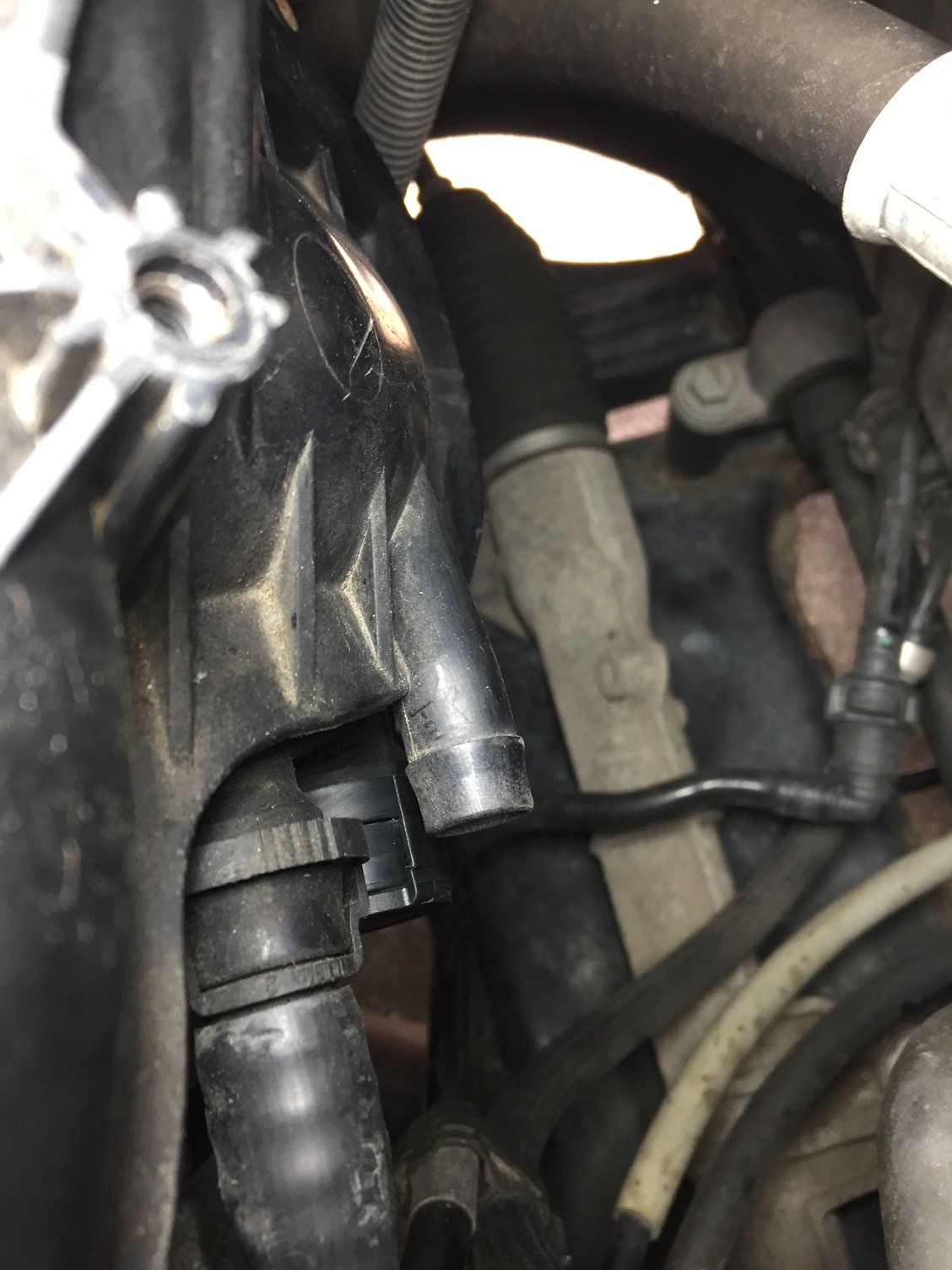

I removed the pcv hose that goes to the intake and installed the caps. Believe it or not, it seems to have cured my P1497 code.
While doing this I noticed this on the back of the intake. It seems like a hose should be attached. I looked at realoem and it didn’t show one. It is right above the hose port that I capped off.

It connects to nothing. Perhaps the european models used it for something or our sister French company.
