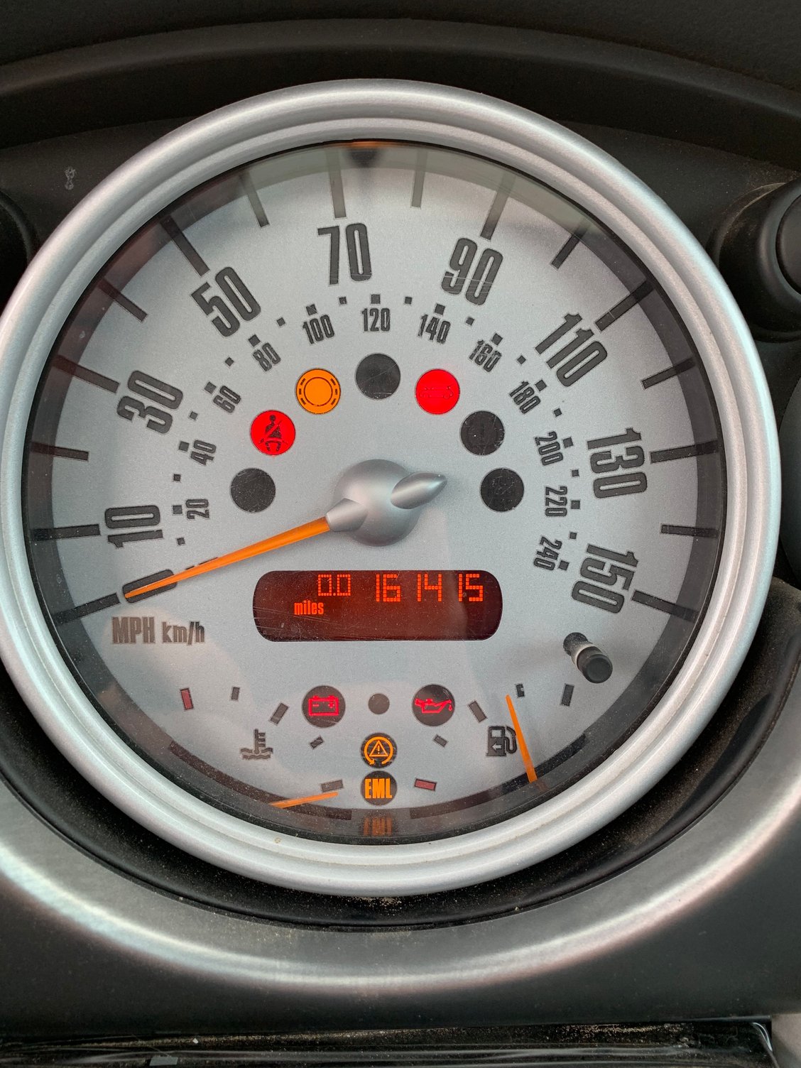

These are the lights on I have.
These are the light on the dash, plus service engine soon light.
Old Dec 8, 2018 | 12:36 PM
Tgriffithjr's Avatar
Tgriffithjr
Joined: Jul 2018
Posts: 766
Likes: 80
From: Texas
Those are all on while the vehicle is running? Hopefully someone, much more knowledgeable than me, here will offer some advice.
Old Dec 8, 2018 | 12:39 PM
Revevsi's Avatar
Revevsi
Joined: May 2018
Posts: 42
No the car is not running it will turn over, but won’t start those are on when the key is in the on position.
Old Dec 8, 2018 | 04:29 PM
Tgriffithjr
Joined: Jul 2018
Posts: 766
Likes: 80
From: Texas
Those look like the lights that normally come on with the ignition before the car is started.
Old Dec 8, 2018 | 05:36 PM
Revevsi's Avatar
Revevsi
Joined: May 2018
Posts: 42
The only one that goes off it the battery while cranking, everything else stay on as long as key is in the on position.
Old Dec 9, 2018 | 06:50 AM
Tgriffithjr
Joined: Jul 2018
Posts: 766
Likes: 80
From: Texas
Lights upon first turning key to ON.
Lights after key is ON for 3-5 secs.
Ok I checked my car and these are the lights that are initially on when putting the key in the ON position (first pic). After about 3 seconds in the ON position most lights go out (second pic). I didn’t start the car. I know this is frustrating for you and I’m sure you believe you checked everything really thoroughly, but I can tell you that I’ve missed simple things after going over issues multiple times. I’m no expert and it’s hard to diagnose something long distance, but I still feel it is a connection issue at some juncture; fuse, relay, connector, etc. That’s just my guess. I can’t believe no one else has contributed to this yet. Cmon guys and gals help a guy out! Unless you’re a gal!
