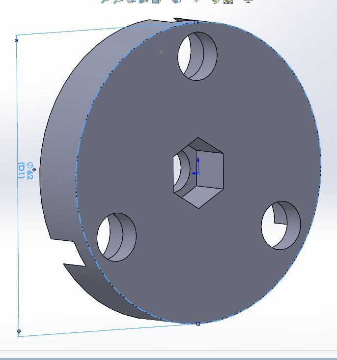

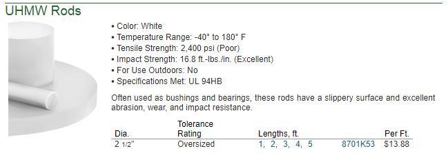

I have a fel-pro seal in my hand so I'm happy to refine the design to work nicely with the included installation sleeve. Here is a rough concept. I'm not sure what the exact OD should be, but I got a measurement from the seal to start off with. I plan to make this tool out of plastic ( UHMW), I'll have a hex head bolt that presses in from the back side, and use a 2 inch sch 80 PVC cap if the dimensions work out.

Yep, that's about right, but your OD of the tool base (62mm) is likely a bit too big. I think 61 to 61.5 will be good enough. And with that spring lip from the gasket itself, you can create an outdraft going from 61 to 61.5 at the base to advance the gasket into the slot.
