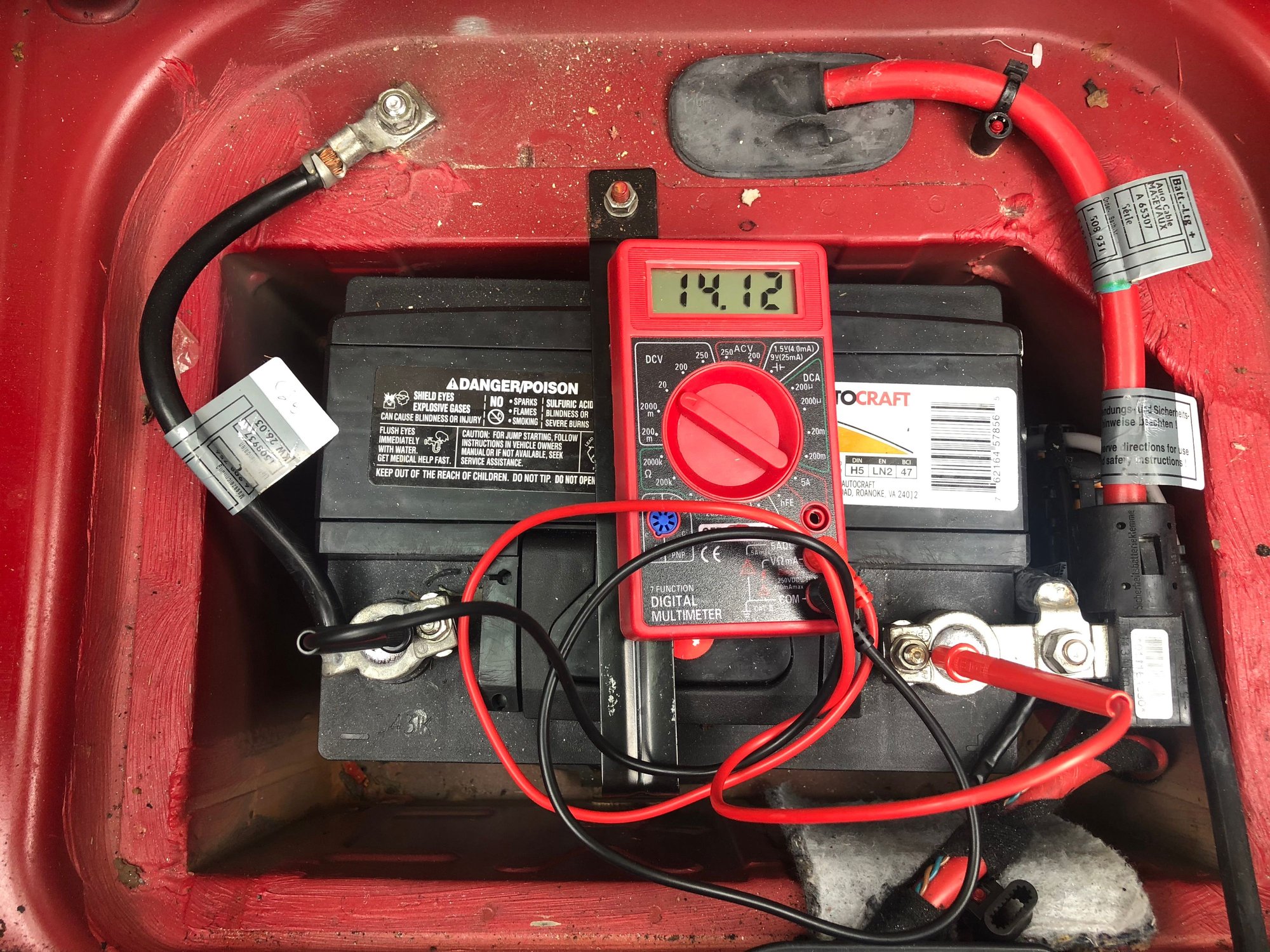

Battery tests at 14.12v at idle and 12.79v off after cleaning the terminals, the body grounds, and the engine grounds. Battery has 550CA (got it tested at advance auto parts yesterday)
The mini dealer wants $150 to tell what's wrong with it; id rather be able to DIY this but it seems as though my options are running out
Car on at idle
Car off after sitting for 5 mins

I think you've done about all you can - your numbers look good.
