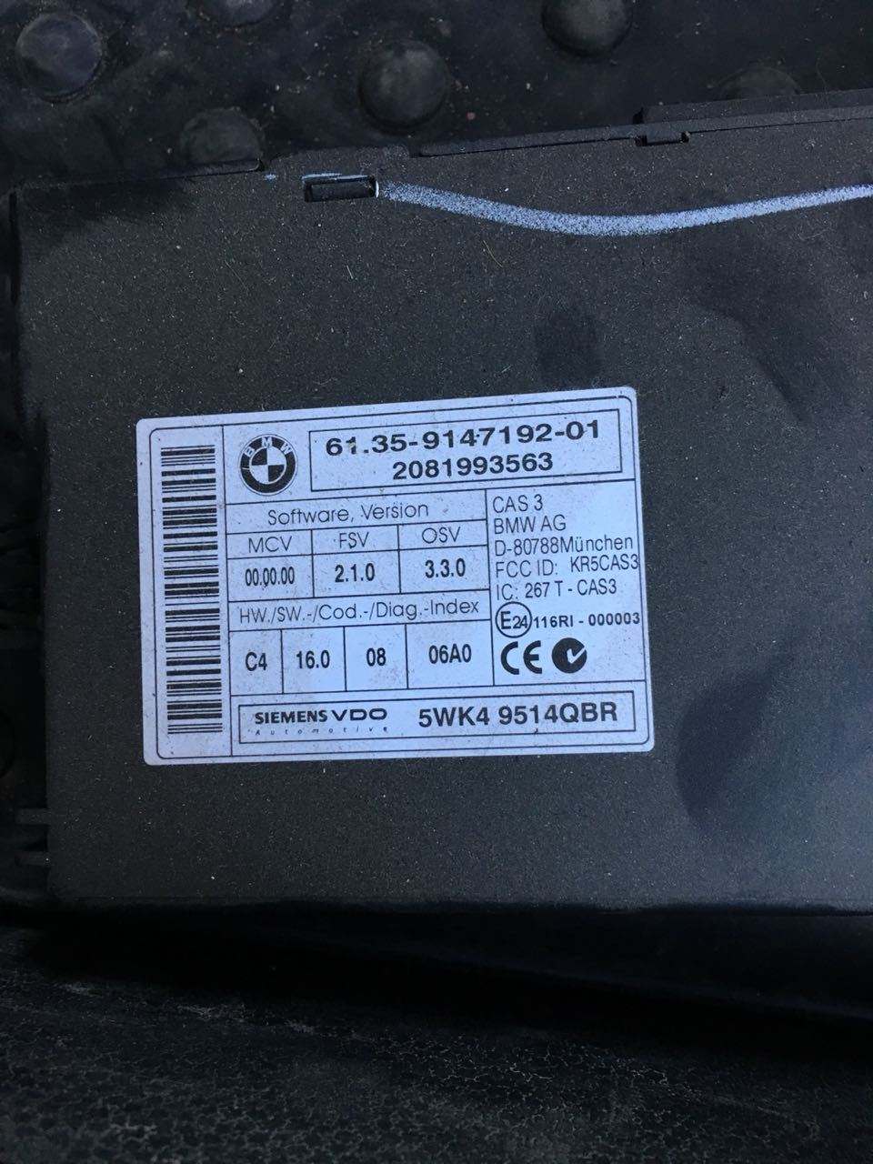

So basically you mean i have to :
- remove the CAS module and plug to the special plug u refer it
Which i already as per the pics below
- download wikfp
- download spadtens update u are referring
please correct if I am wrong
