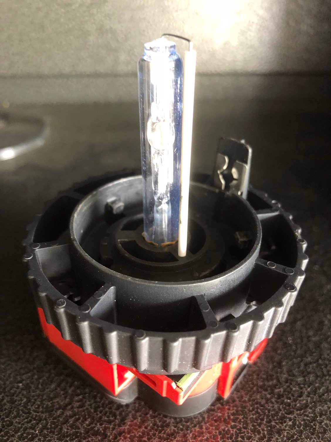

Ok so I put a few washers behind one of the lens/projector screws and now that’s secure. I’m still not satisfied with how the bulb secures into that tho. Seems it rattles itself loose. The other side bulb fell right out when I took the cover off. Doesn’t seem like anything is cracked off. This look ok?

Good to hear the problem is solved. What was the fix for the loose bulbs?
Old Aug 5, 2018 | 07:18 PM
GTODave's Avatar
GTODave
Joined: Jul 2018
Posts: 38
From: Hopewell, PA
It was getting them apart and putting them in the correct way. Tbh it’s pretty ridiculous how hard it was to get them apart. I knew the igniter and the build and the ring were 3 separate pieces yet I couldn’t get them apart. Crazy but once I had them separated. Put them in one by one time make sure they were secure, all was good and tight. It seems all is good now. When I have time and it’s dark out I’ll attempt to adjust them so I can see and don’t blind everyone coming at me.
