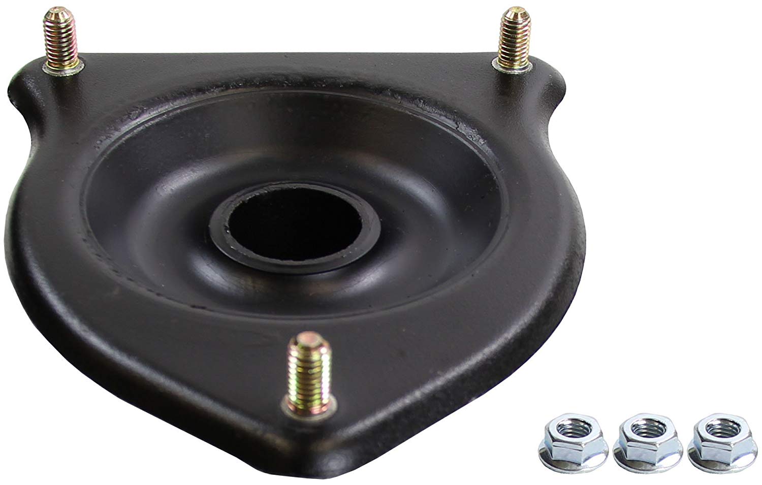

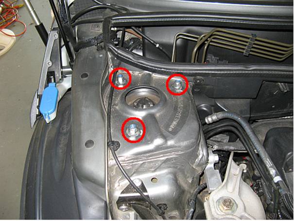

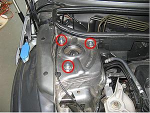

Strut Mounts...
This is the location of the Strut Mount and the mounting bolts and nuts, what they look like new... and a bad one.
And in some cases the mounting point will deform and "bulge" upward.
Motor On!
Attached Thumbnails Groaning coming from passenger side when turning wheel-image027.jpg   Groaning coming from passenger side when turning wheel-71y8fnn8wtl._sl1500_.jpg
