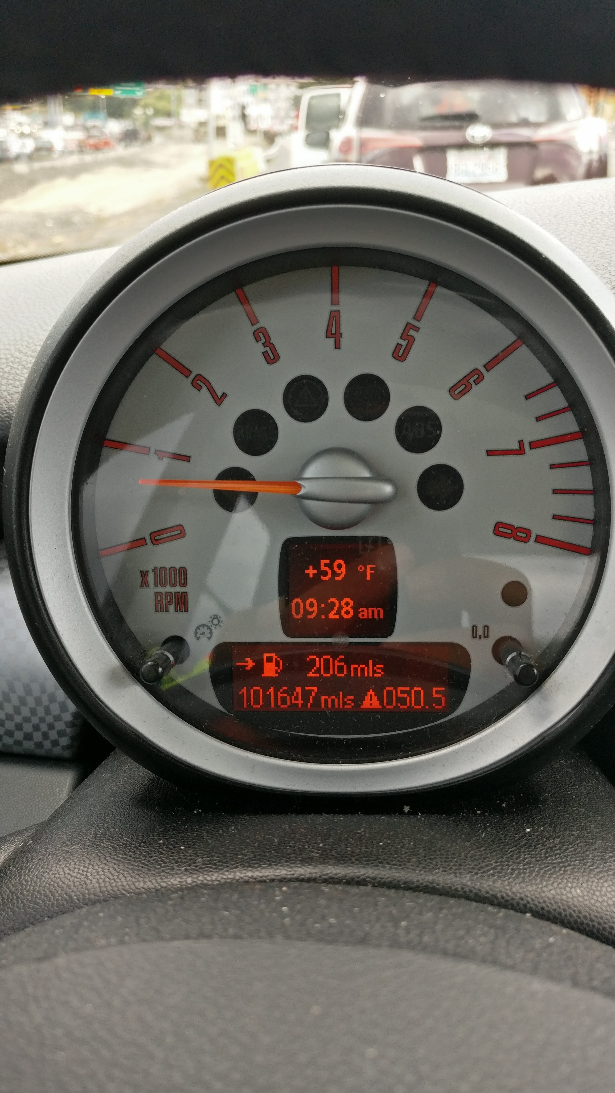

Good day everyone. I have a 2010 r56....just turned 100,000 on the odo. When i first got this a year ago, i swapped out the spark plugs for new iridiums then i changed the 4 coils around 5 months ago. Mileage was great. Then about 2 weeks ago, I notice that the average fuel consumption gauge ( see pic ) was counting down MUCH FASTER now....whereas before it slowly ticked down as you used your gas. What's odd is that it will do it no matter if i am driving fast or slow....incline or flat. Does it on the freeway and on 30mph city streets where i'm going under 30. It will then COUNT UP up to about 7 or 8 miles, stay there for a while, then slowly ( or quickly again ) tick back down. If this is how it was behaving all along, then this is the first time i have noticed this behavior.

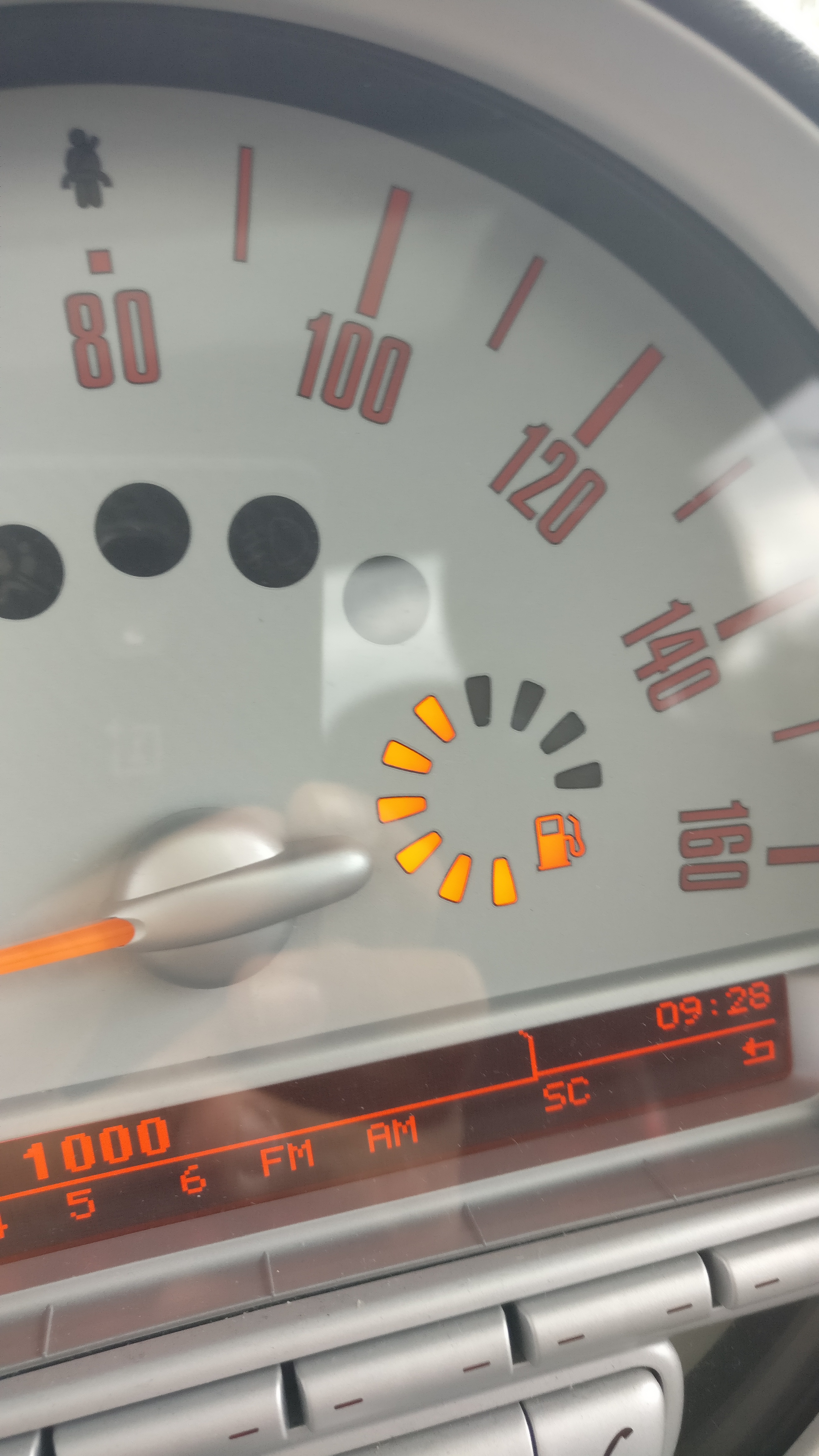

Also, there are 10 hash marks on the fuel gauge. How many gallons does one represent?

What is your average MPG over a tank of gas? Has it changed?
The "range to empty" is an estimate based on fuel level and short term average mpg. It will go down if you're in stop and go traffic or driving hard, and go up if you're cruising on the highway. Look at the actual range you get out of a tank of gas and the long term average mpg for a more accurate measure. It's possible that the fuel level sender is getting wonky, but not likely.
The fuel level gauge (or "carrots") is very non-linear. I reset my trip odometer every time I fill up, I get to about 85 miles before the first one goes off, then 125 for the second. I'll show "half a tank" (5 on, 5 off) at about 300 miles which I know is BS because I typically get about 420 miles on a tank.
