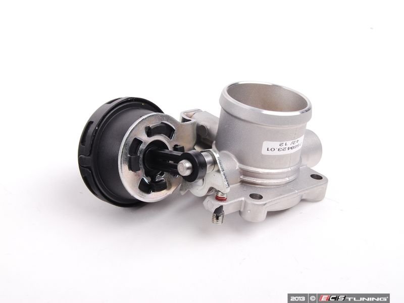

It's underneath the right side of the intercooler. You can actuate it manually by pushing on that tab that's resting on the stud in the foreground of this pic:

^Yep, if you open your hood, look for the S emblem on the plastic intercooler cover (the radiator on the top of your motor). Below that is a 'bullhorn' shaped intake. Follow that down and peer below it. You'll see the above pictured item. Have an assistant sit in the car as you look at the black plastic arm that attaches to the plastic round bit. Ask your assistant to rev the motor (in neutral) pretty aggressively and then let it idle. That arm should move. If it doesn't that could be your culprit.

Part number 11617568423, $111.23 from ECS, here.
