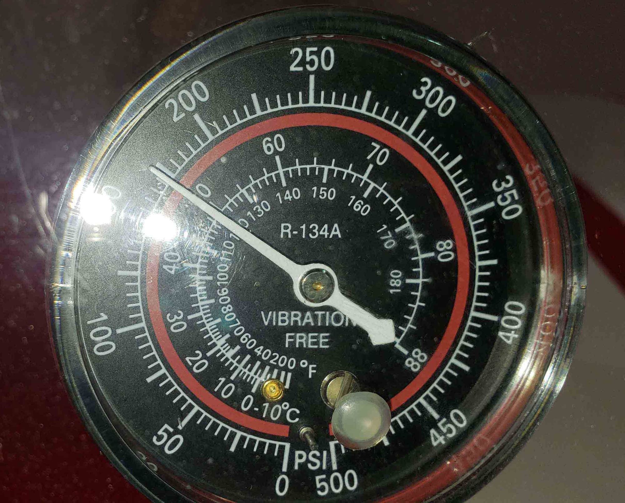

Kevin, to give you a comparison, here's what my MINI pressure readings look like at 80 Deg F, 2000 RPM, w/ a fan blowing air through the condenser. My car has 124K miles on it. Compressor is the original. Air is cold, but as you can see from the gauges, and the pressure chart, I'm low on refrigerant.
High Side
Low Side
Pressure Chart
