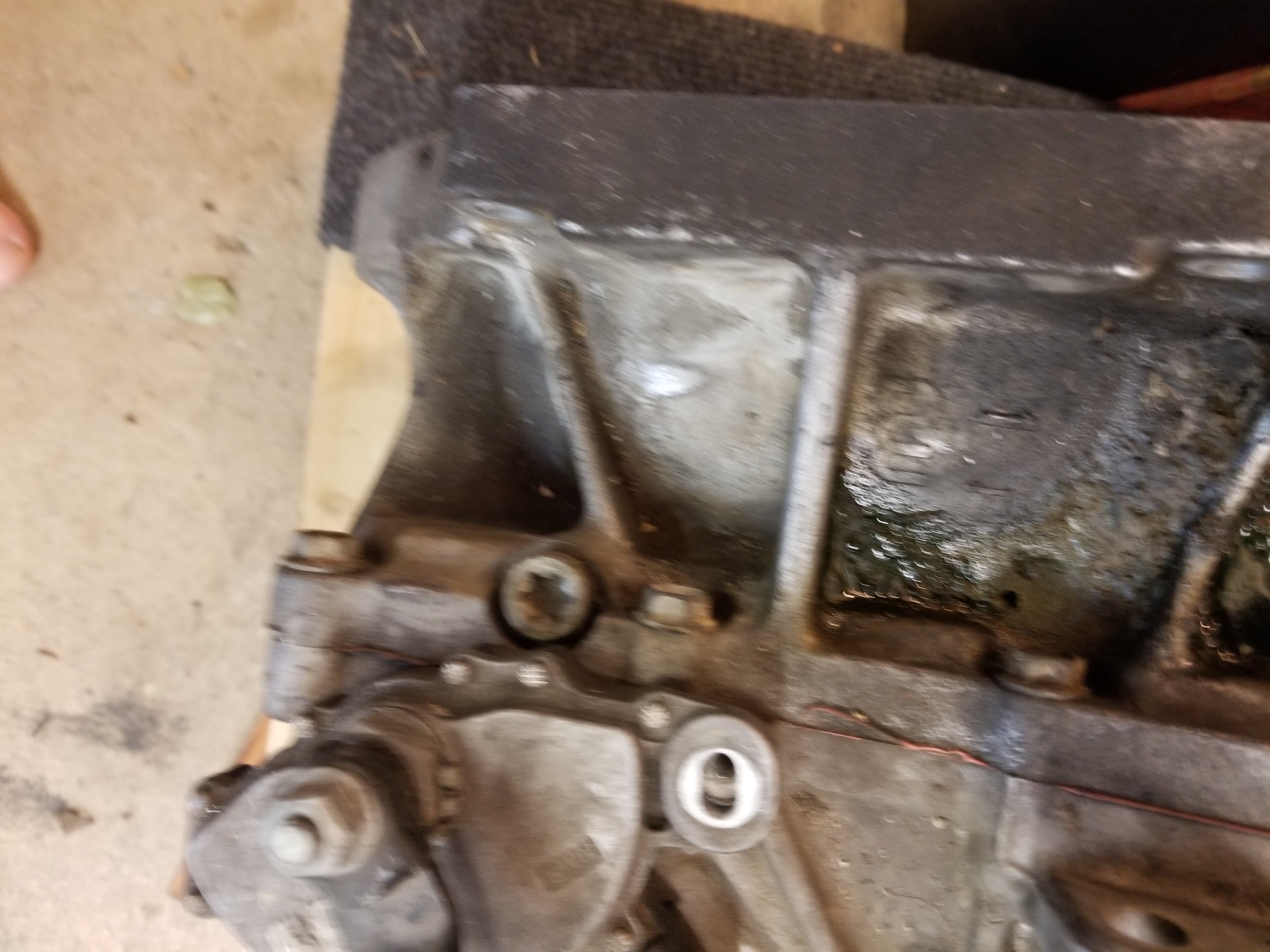

Just put an auto trans in my daughters 08 "S". I would do this change as a what I take out is what I put back in. The torx socket for a plug is a 55. I found that it was easier to fill fluid from the backside of the trans than to get to top under the thermostat housing and behind shift lever . Hope this helps
First photo: Plug behind the shift lever and thermostat housing
Sencond photo: Two plug behind the trans next to the firewall. In my opinion, easier to get to and but a funnel in.

Life is easy if you fill from the bottom. If you want to make filling hard, use the top plug as recommended by the above posts (the top plug was not intended to be used for filling). Slightly less hard is the factory fill plug at the top rear (lack of access make this hard to use). Filling from the bottom is easy, I spill around 2 tablespoons during the process and it takes about 5 minutes.

Can you add picture which side plug to refill. Is it by the bell housing area? Another question is the drain plug located at the bottom of bell-housing is it possible to drain Transmission oil as well? I dont want to keep unboltings things that im not sure about...

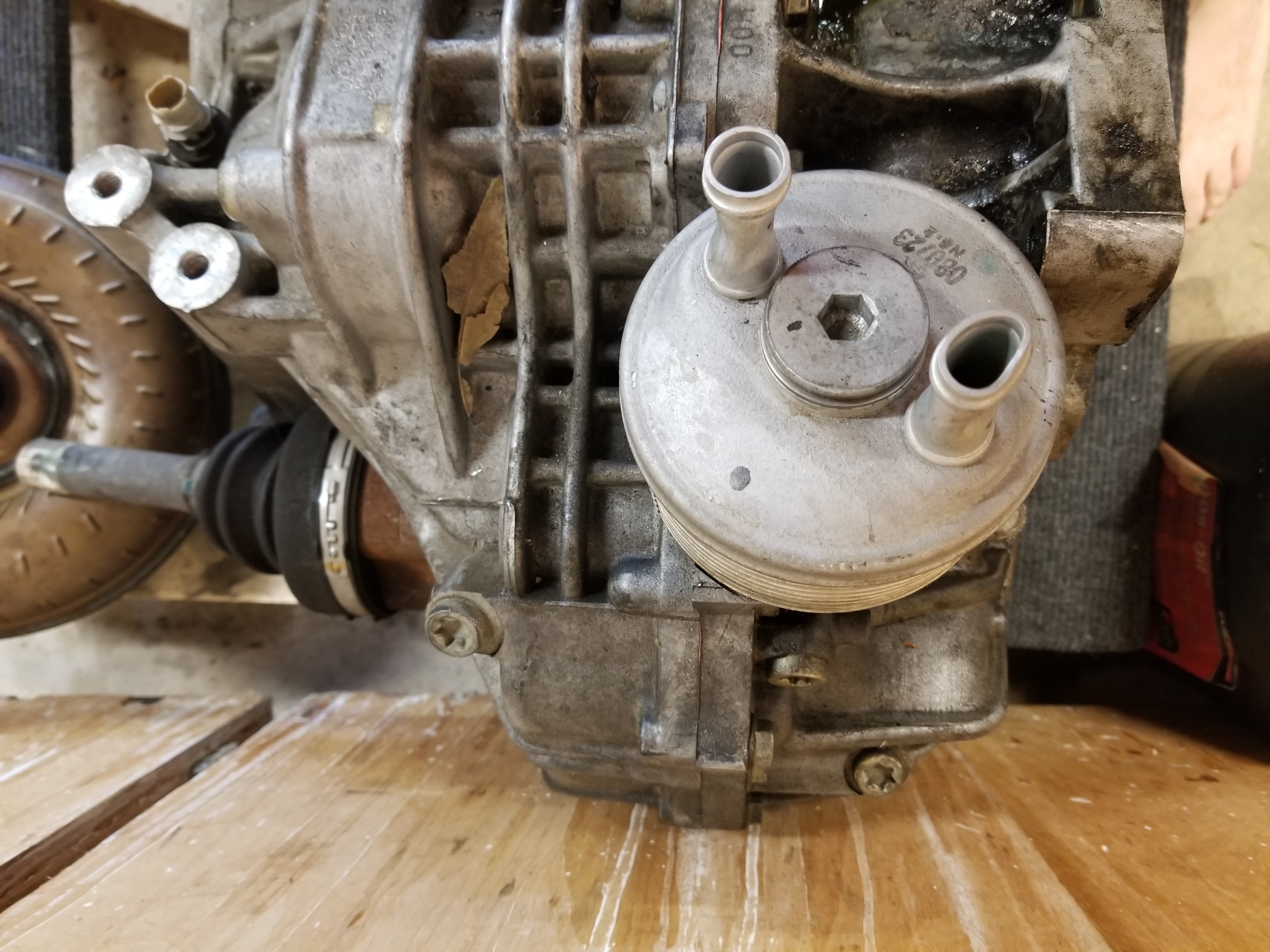

Automatic transmission
Can someone tell me if its possible also to drain and remove the plug in the picture.
Old Jun 11, 2018 | 07:31 AM
thefarside's Avatar
thefarside
Joined: Mar 2014
Posts: 383
Likes: 72
From: MA
This plug drains the cavity for the ring and pinion gears. I doubt that you'll get much volume out of it. No harm in trying. If you decide to pull it, please post how much fluids drains.
