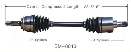

I've purchased driver's side cv axle from O'reilly and replaced it about a month ago. i wonder if this is right spec for my car or not.
Product Information
Warranty: Limited Lifetime Warranty
Unit of Measure: Each
UPC: # 844084005137
New Or Remanufactured: New
ABS Ring Included: No
Axle Nut Included: Yes
Length (In): 23-9/32 Inch
Length (mm): 591mm
Number Of Inboard Splines: 34
Number Of Outboard Splines: 26
Axle Nut Hex Size (mm): 32mm
Axle Nut Thread Size: M22-1.50
Axle Bolt Length (mm): 82mm
Boot Material: Premium Neoprene
Inboard Joint Diameter (mm): 79mm
Outboard Joint Diameter (mm): 82mm
Inboard Joint Type: Male
Outboard Joint Type: Conventional
Measurement Type: Compressed
Please advise.

Having issues?

I think so. It sounds like clunk.

Thinking the R53 axle has an arcing type spline cut into the non threaded end whereas the R50 does not. What did yours look like?

Actually i have no idea with it. One of my friends who owns r53, he said he bought the same one from O'reilly and it works okay.
