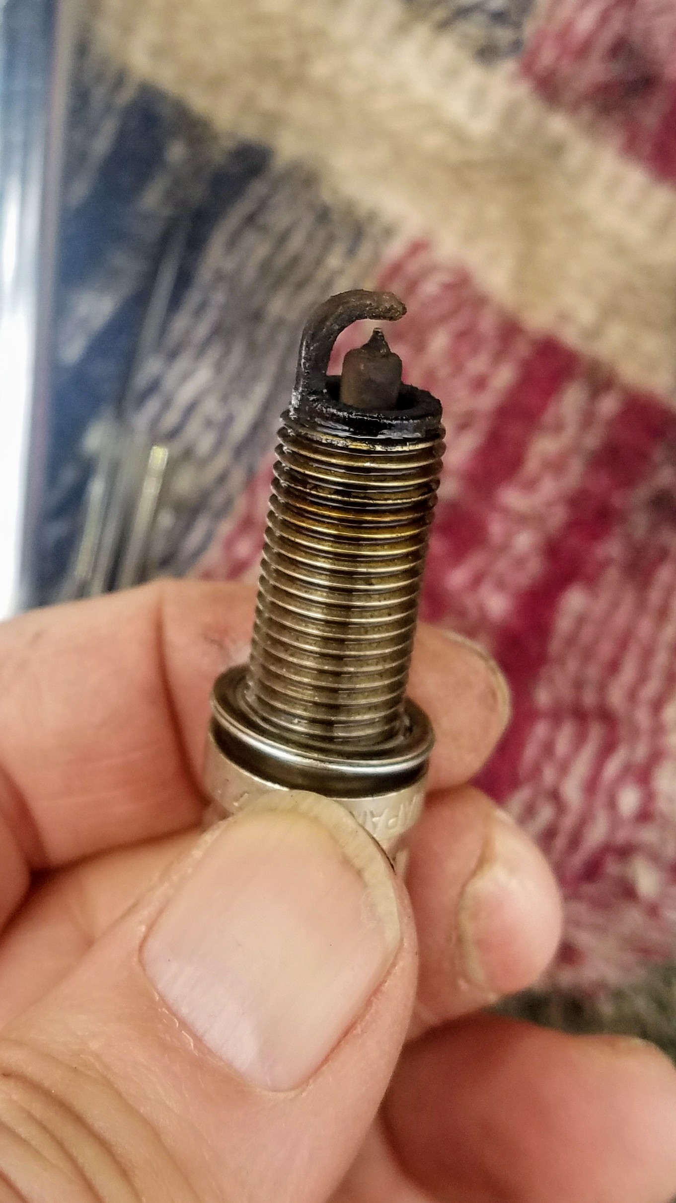

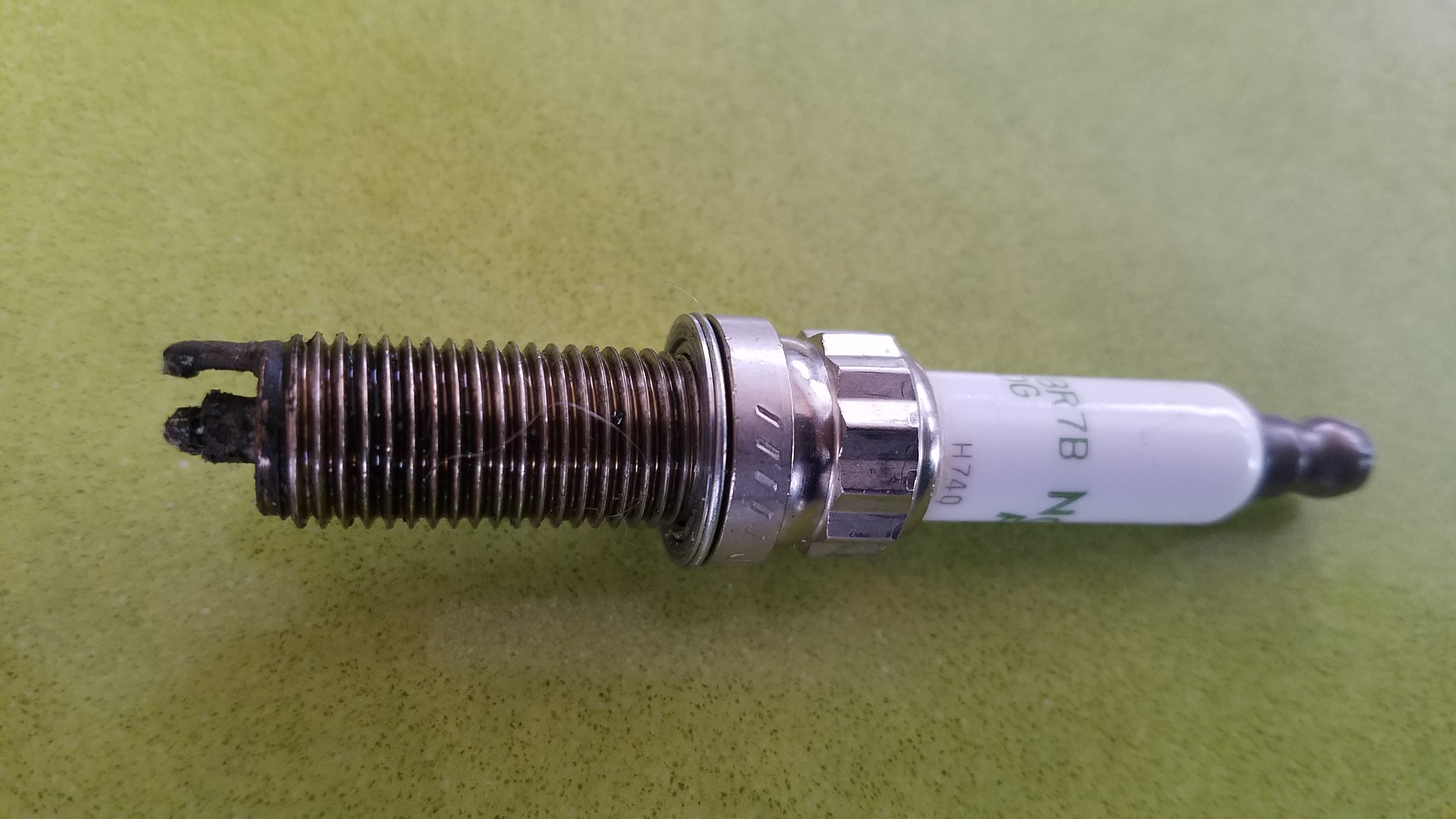

I just had the head rebuilt for the second time this year. I have a Frankenturbo on it with a tune from eTuners. Bone stock otherwise. I drove the car 27K with this setup before the first failure including a few track days and autocross days.
A valve disintegrated in cylinder 3 the first time, spark plug too. I was told there were signs across the bank of lean running. They fully rebuilt the head, all new everything. A month and 2K miles later, very mellow driving, the same thing happens again. This time in cylinder 2. Again full rebuild. They inspected all mechanical elements including function and condition of the injectors. They did a smoke test looking for air leaks. They assure me that everything is in tip top shape, as it was last build. They did take nearly 2 weeks with it vs about 4 days the first time to go thru it as much as possible.
They suggested maybe the tune was at fault. I logged it running on the road, a mix of driving around town, highway speed, and a hard pull or two. Both the installer of tune and owner of the company don't see anything suspect. Saying the results were safe across the board.
I did inquire about larger injectors. The info from both tuner and turbo maker was that there was no need. It is just not that aggressive of a setup.
I'm at a loss, I'm afraid to drive it. Being able to go 27K of occasionally hard driving without a hiccup and then it blows, and then again 2K later? It makes me have to believe there is something going on that someone is missing.
https://www.etuners.gr
http://www.frankenturbo.com/new/F21M.html
Attached Thumbnails '09 R55 JCW valve muncher-20180320_095005.jpg   '09 R55 JCW valve muncher-20180320_095024.jpg

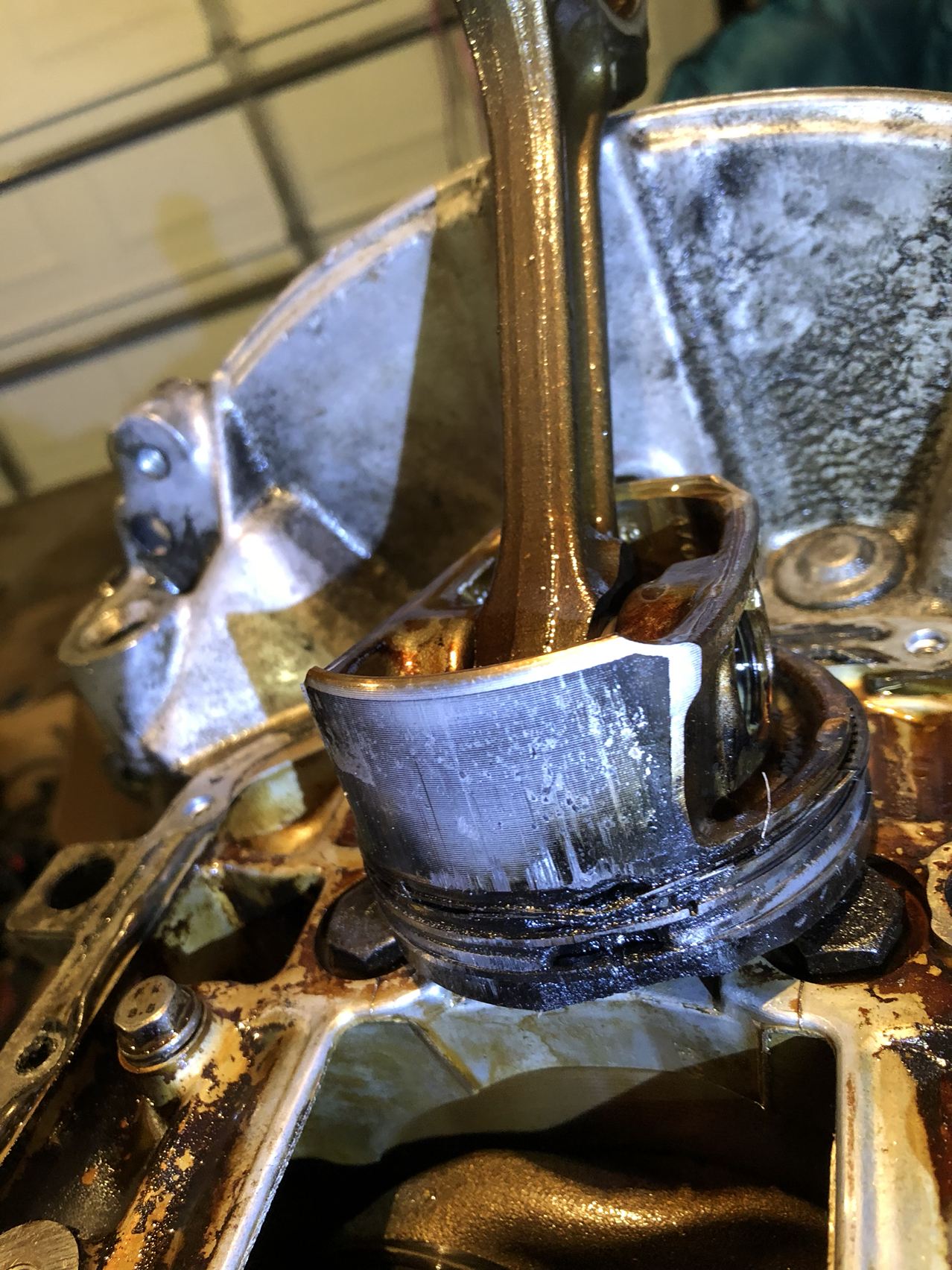

#3 cylinder on my 2008 N14
Oil delivery issue perhaps....when oil is low.

timski....ouch! I'm def on top of the oil with this thing.

Plug in the photo doesnt look like it was getting to proper temp.. there is not 'color' on the insulator at all.
Q - whos gapping your plugs?

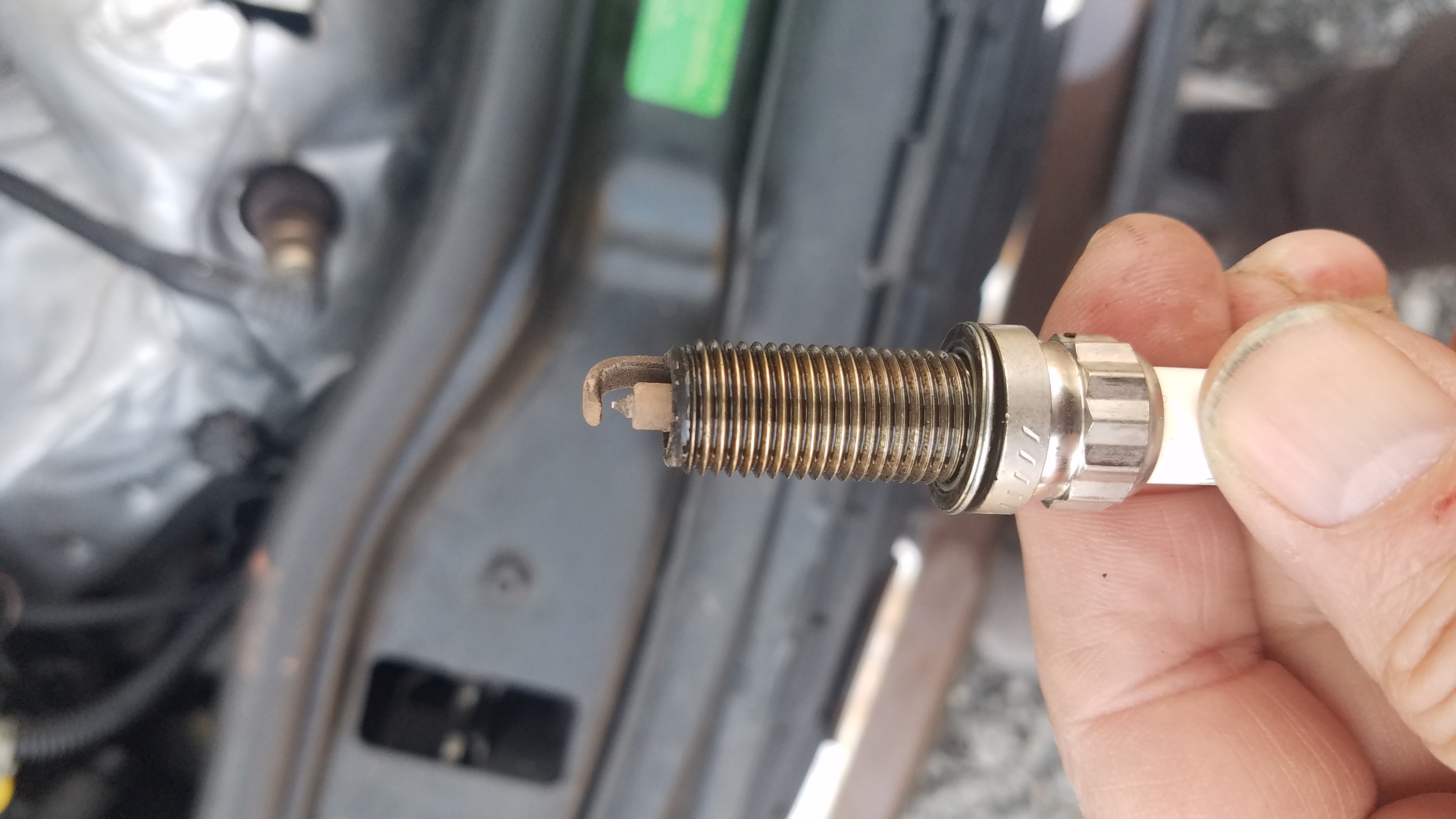

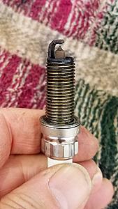

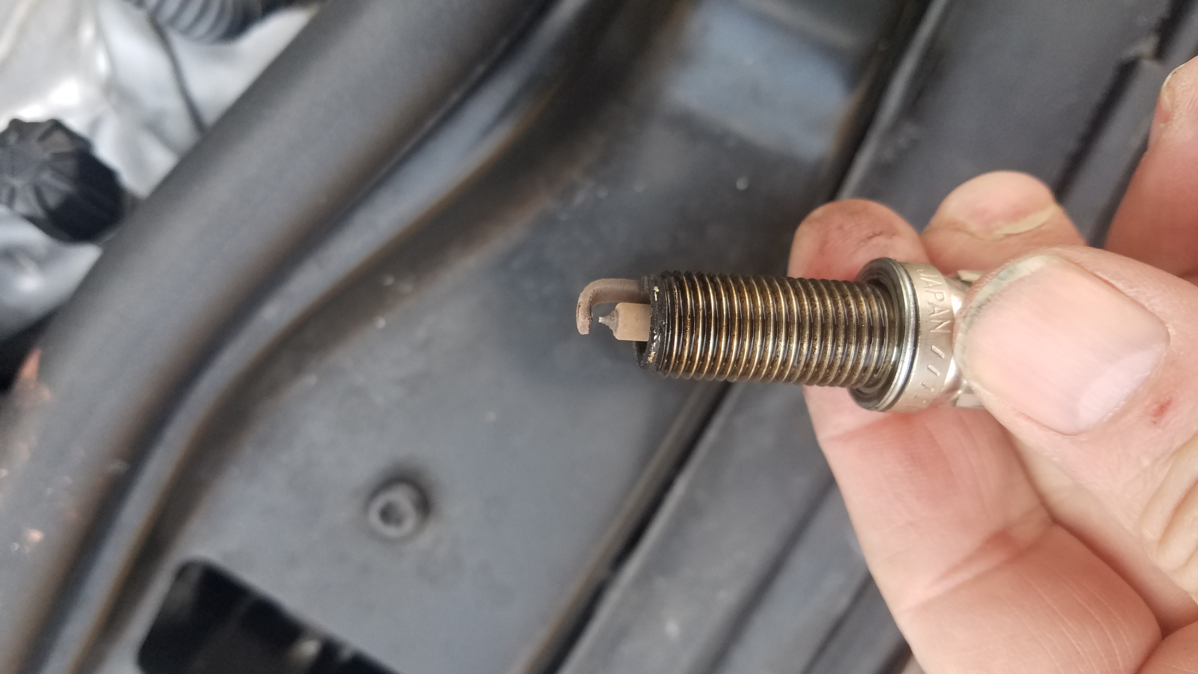

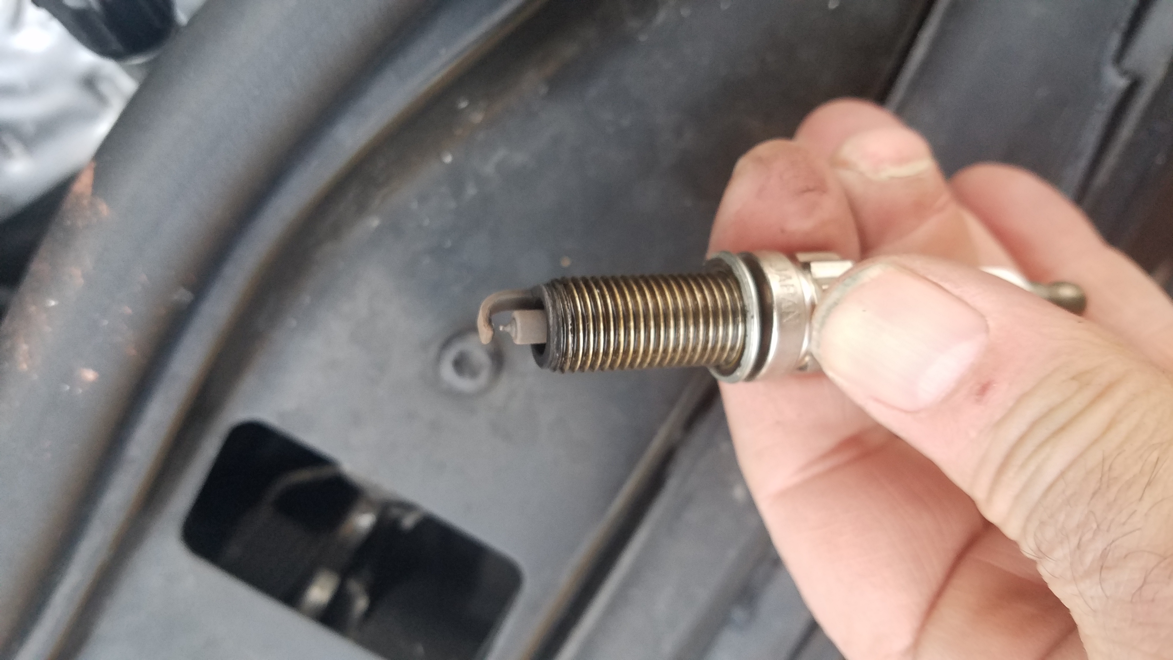

Extreme heat caused a meltdown, a part of the valve broke off. I was told there was a severe lean condition across all cylinders. Here are what the plugs look like now after a few hundred miles.
Attached Thumbnails '09 R55 JCW valve muncher-1-3_22.jpg   '09 R55 JCW valve muncher-2-3_22.jpg   '09 R55 JCW valve muncher-3-3_22.jpg   '09 R55 JCW valve muncher-4-3_22.jpg

those look better!
*If you are running a bit on the hot side, may be time for a colder plug to help remove more heat from the spark plugs/combustion area.

I'm baffled by the whole thing. Engine temp def not hot and AF mix looks spot on in the logging and observing real time. There's no way it could log correctly, but somehow not be getting the right mix right?

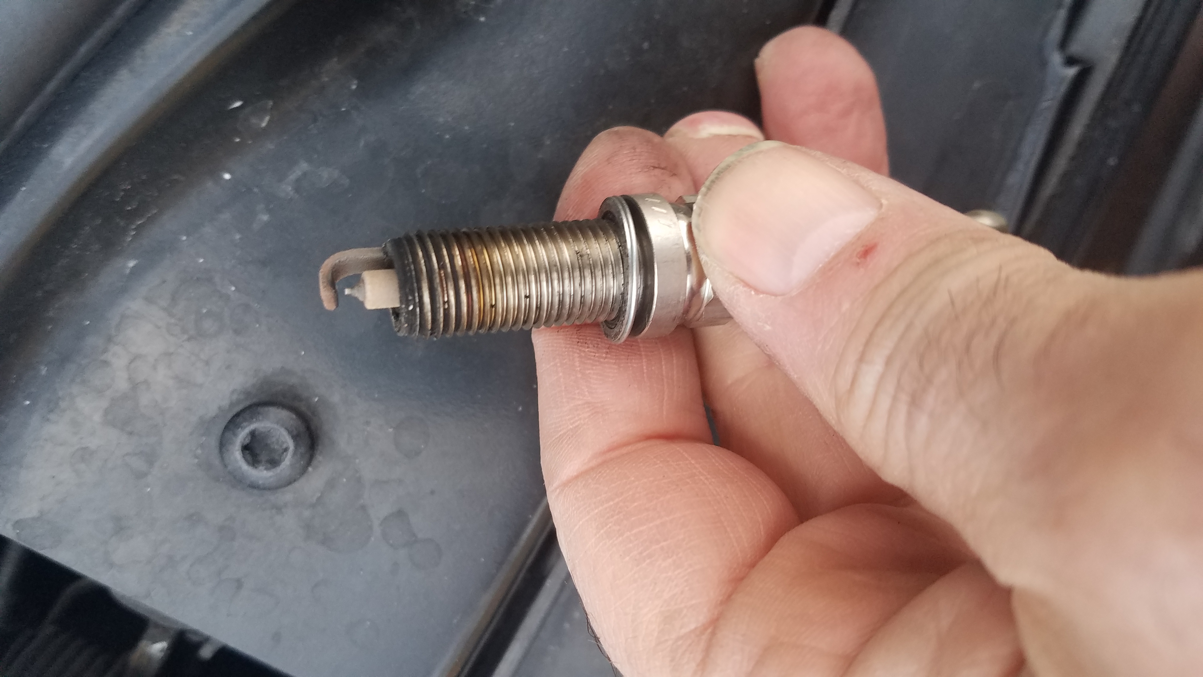

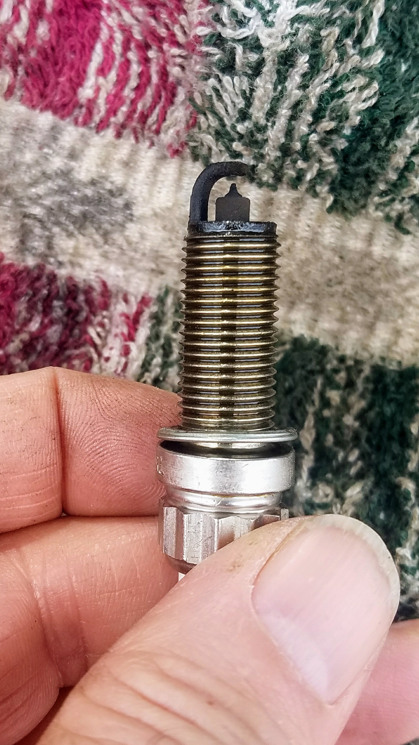

Here's a follow up plug pull. 2400 miles from the last job, and about 2000 from the last plug pictures. Doesn't look encouraging to me?
Attached Thumbnails '09 R55 JCW valve muncher-1-4_24.jpg   '09 R55 JCW valve muncher-2-4_24.jpg   '09 R55 JCW valve muncher-3-4_24.jpg   '09 R55 JCW valve muncher-4-4_24.jpg
