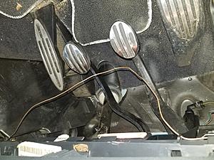

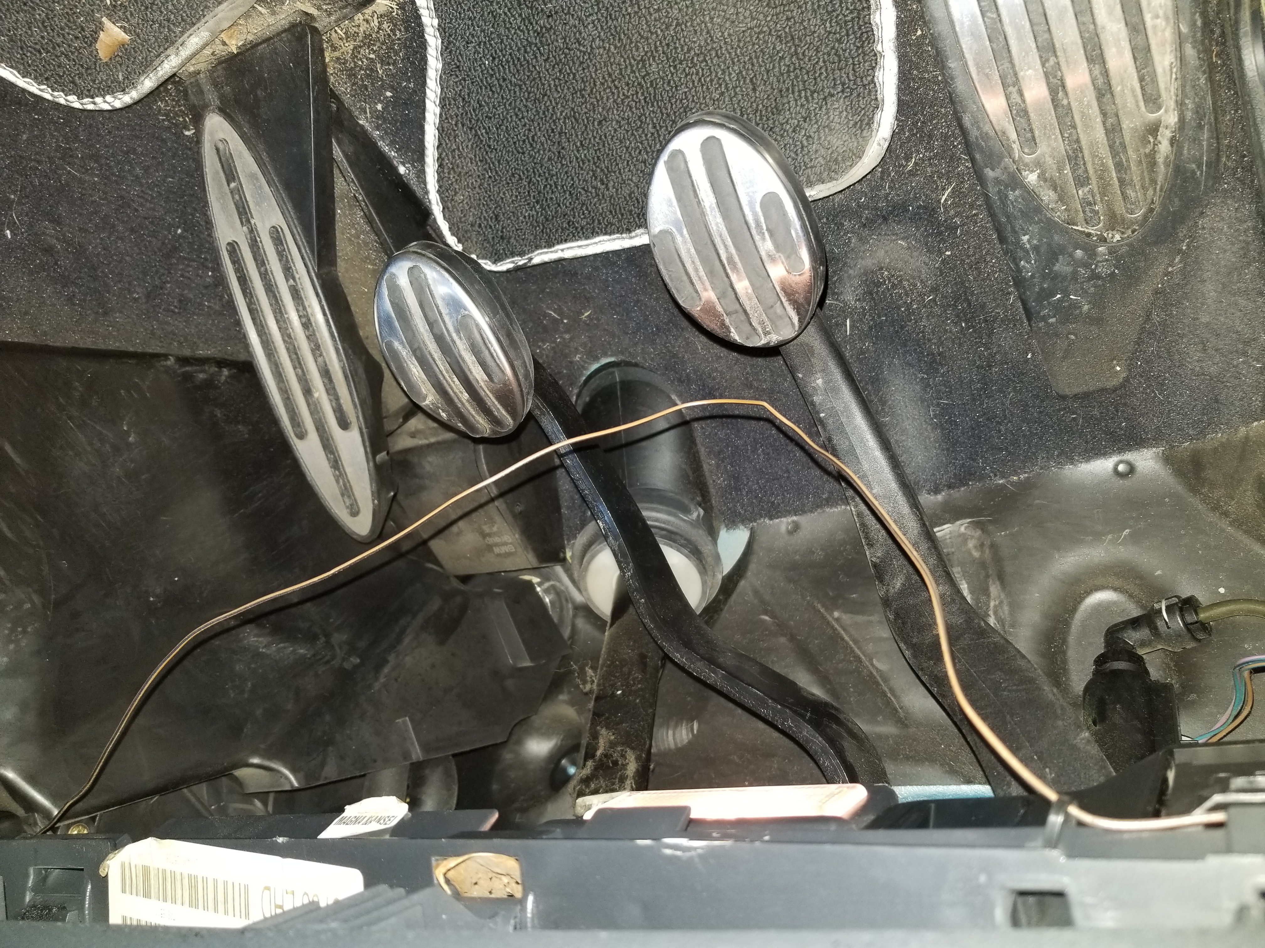

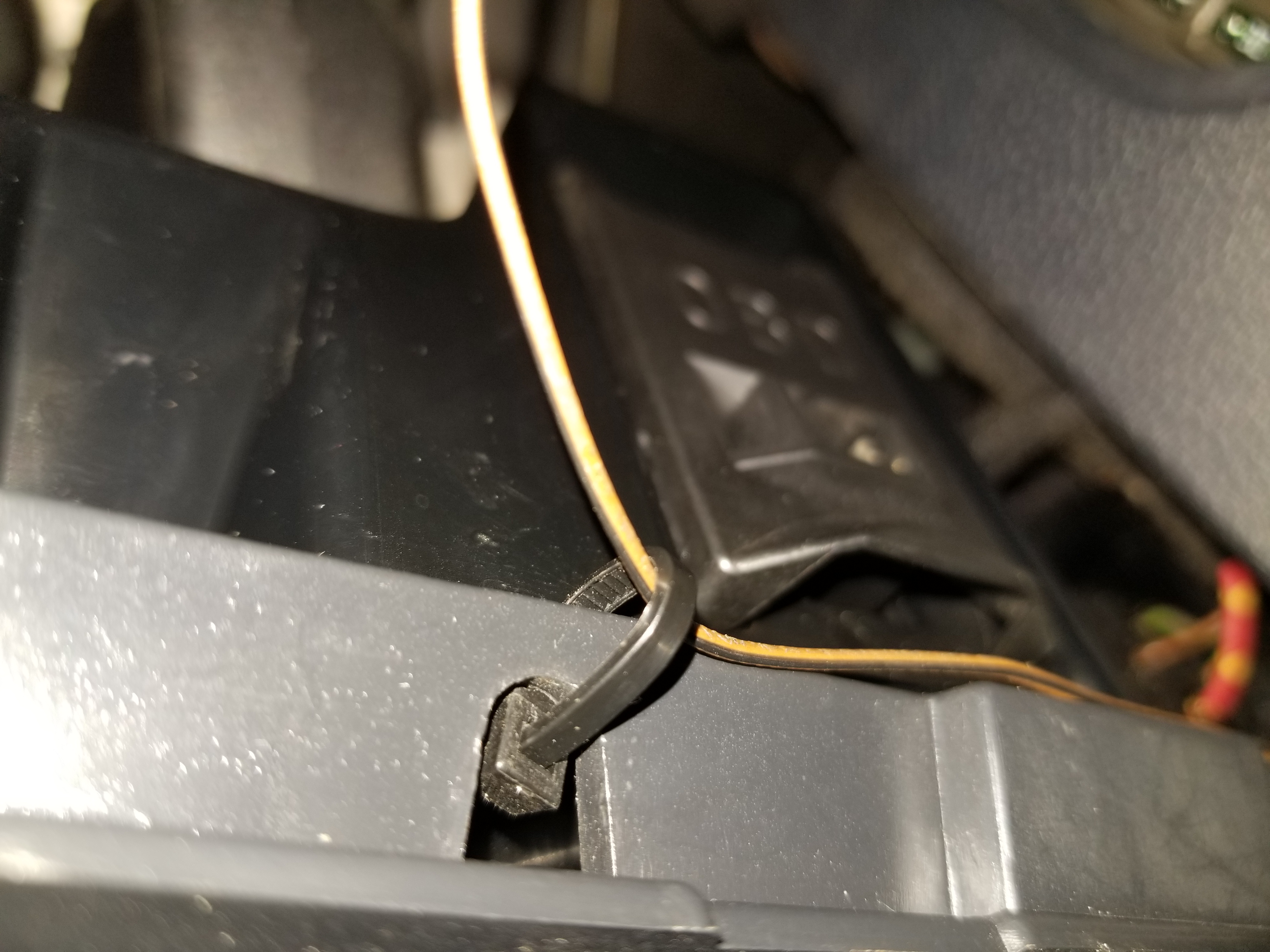

I'm in the process of diagnosing a no crank issue on my 2004 Mini Cooper S. It was intermittent but now she won't crank at all. I hear the fuel pump prime & I've tried both keys, so I hope to test the starter and clutch switch this weekend. I can't bump start, as she's in the driveway & there's no room. In the meantime, I'm trying identify a hanging wire; it's brown and black, and it appears to be held up by zip ties. The wire doesn't appear to be loose but it is hanging down around the pedals. Any idea where it runs from and/or to - and if it could be related to the no crank issue?
Any suggestions are welcome!

is the battery good? did you jump start it? can you trace that wire to anything on either side of it?

My guess is that is the driving light wire going to the BC1. Normal for it to be ran like that. Nothing to do with starting.

Outstanding; the wire doesn't seem loose at all, so that makes sense. Unfortunately, I can't trace either end, as both ends go back under the dash; it looks like one side may go to the fuse box under the dash.
