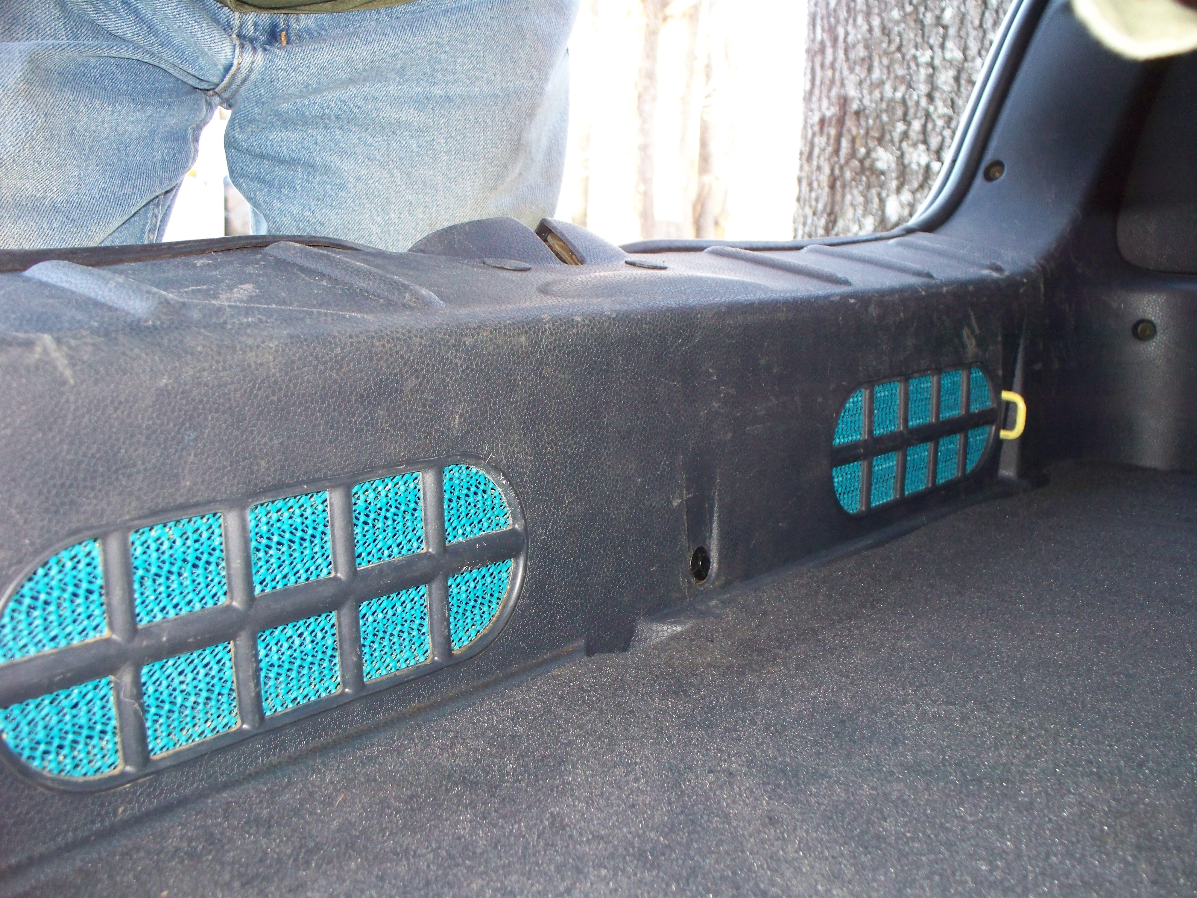

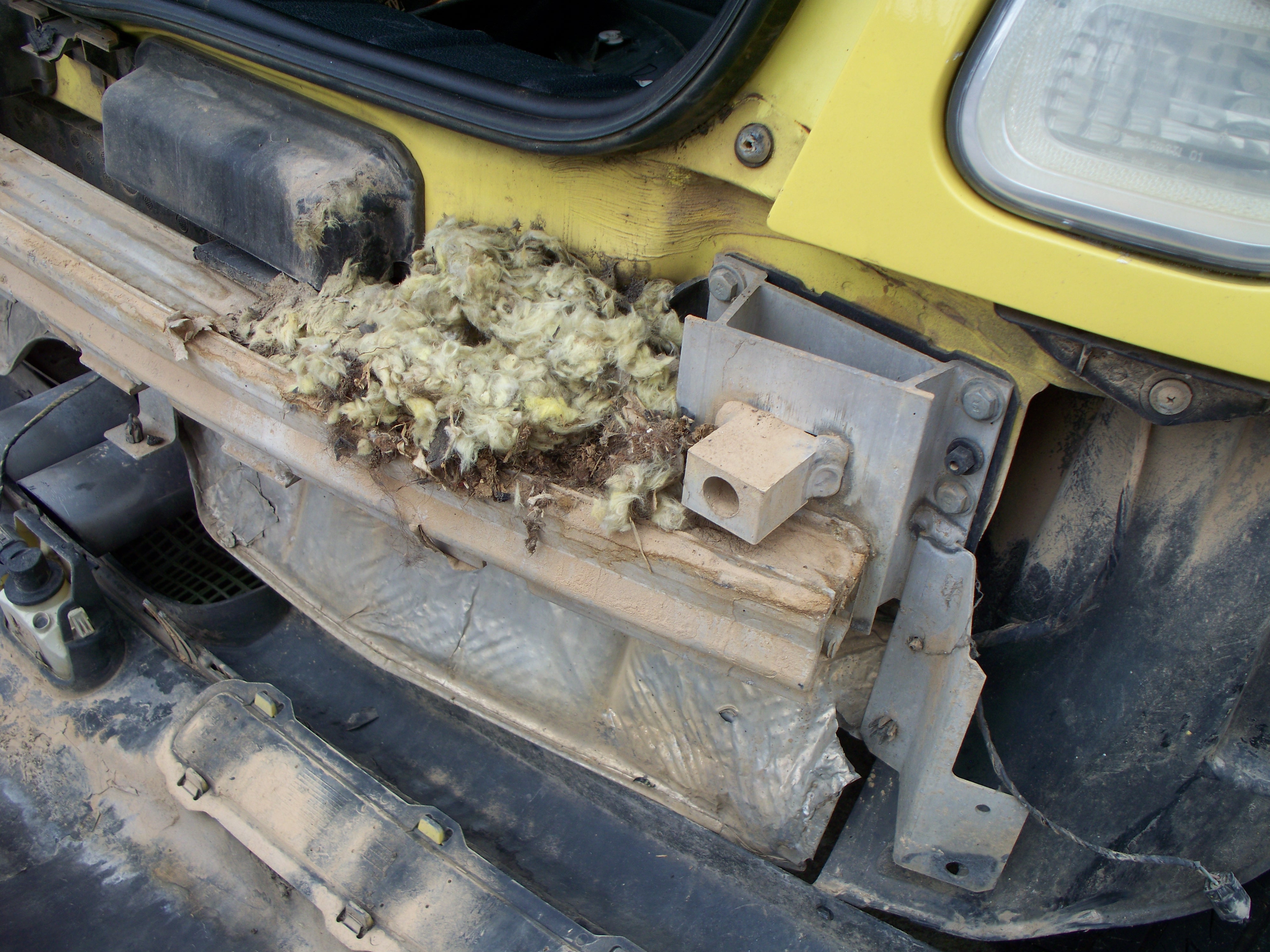

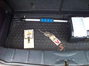

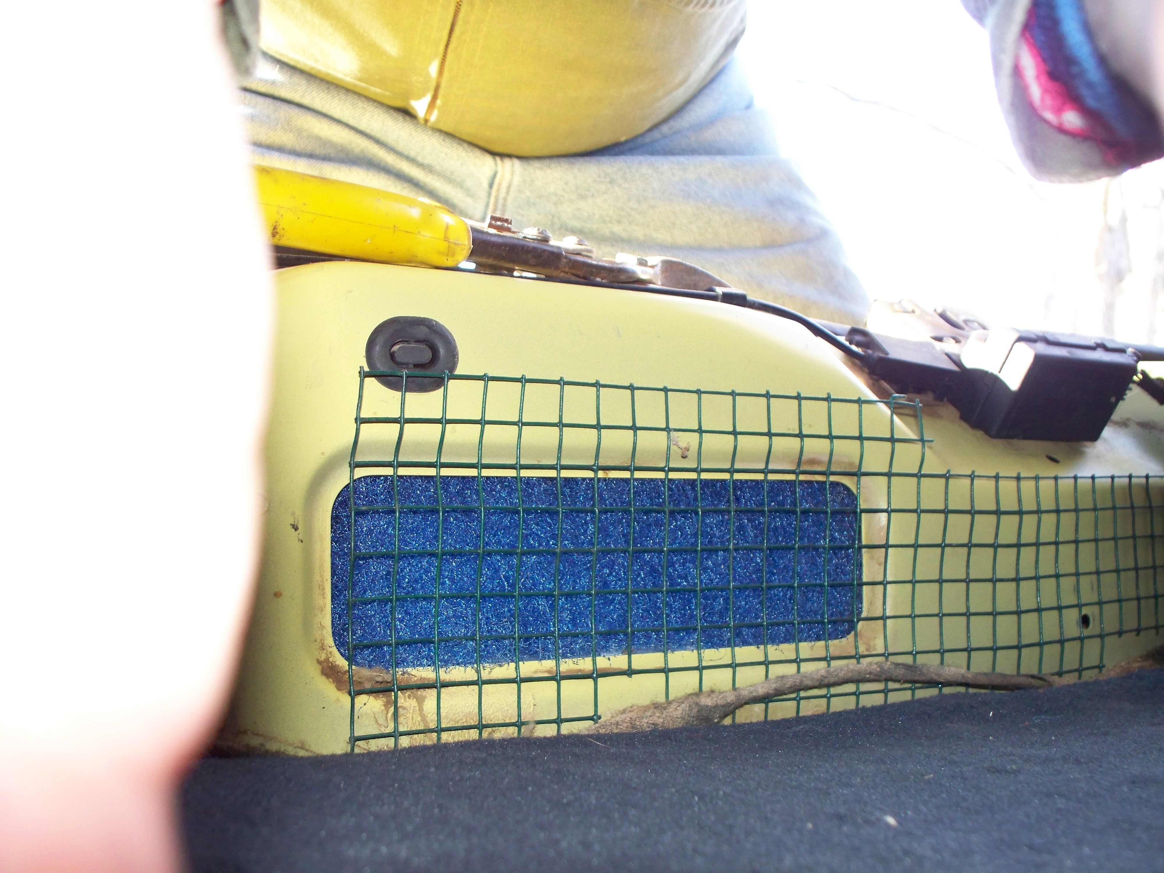

I don't remember the link, but there is a company marketing a rodent repelling electrical tape that can be used to wrap wiring. I haven't tried it yet, but have had many an injector wire eaten by rats where we live out in the country and they seem to like black wires best. I read it is because car companies started using bio-degradable insulation rather than plastic insulation and it is apparently bio-delectable to rats.
A friend joked that my "new" 04 Mini apparently came with the rat-option installed; there was a big nest of house insulation behind the rear bumper cover and after removing that and cleaning up the inside of the car I found that something had shredded a roll of paper towels I left in the boot and dragged the shreds through those little grills in the rear sill that lead to the space under the bumper cover. I set traps in the boot and caught a small rat that I think came with and was living in the Mini, although we do have plenty of home grown rats around here too.
I've since stashed bags of moth ***** behind each of the openings in the body back there, covered them with AC filter tucked behind the holes, covered the whole face of the sill with "hardware cloth" metal screen with 1/2" square holes so nothing bigger than 1/2" square should be able to get back in, and replaced the old falling-apart foam with some porous non-skid rubber glued to the back of the sill cover. Fortunately I've seen no wire eating in the front so far, and the only down side is that if I drive with the front windows open I get a heavy draft of moth ball odor from the back that can be overpowering.
Attached Thumbnails Rat damage, can you help me identify wires?-100_6395.jpg   Rat damage, can you help me identify wires?-mini-rat-option-1-.jpg   Rat damage, can you help me identify wires?-rat-proofing-the-boot-15-.jpg   Rat damage, can you help me identify wires?-rat-proofing-the-boot-20-.jpg
