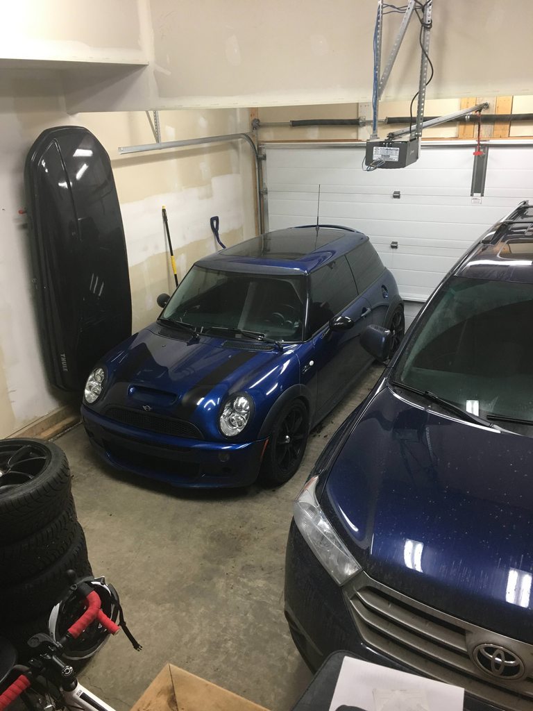

Hey guys! Long story short, I'm back in my original MINI after selling it over 7 years ago! Back in 2010, I sold my R53 which was orignally purchase by my mom in 2003. I went from a Z4 M Coupe for a few years, then when kids came, I sold that for an E46 M3. I loved both of those cars and drove them hard, but in the end, it was always my MINI that I thought about and I am soooo happy to have had the opportunity to buy my car back last weekend!
Anyways, with that out of the way, the car now needs a few items addressed to get it back into the shape that I once had it in, starting with the clutch...
It was the first thing I noticed when I drove the car... The clutch is done, which is understandable at 145,000kms and the amount of power the car is putting down (235whp).
So my quesiton to you lovely people is: Is there ANY difference between an OE MINI clutch (made by LUK) versus an OEM LUK brand clutch kit? They look identical in pictures on rockauto and ecstuning, but I just want to double check that if I do go for the OEM LUK kit, that I'm not going to have a completely different pedal feel or anything?
Please note that the Valeo kit does not interest me. I ruled it out right after hearing about the soft pedal feel. That would drive me nuts.
Cheers
