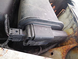

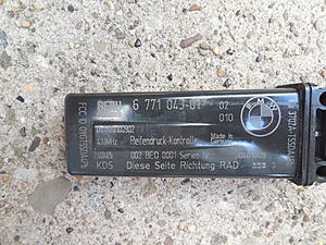

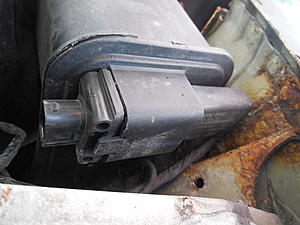

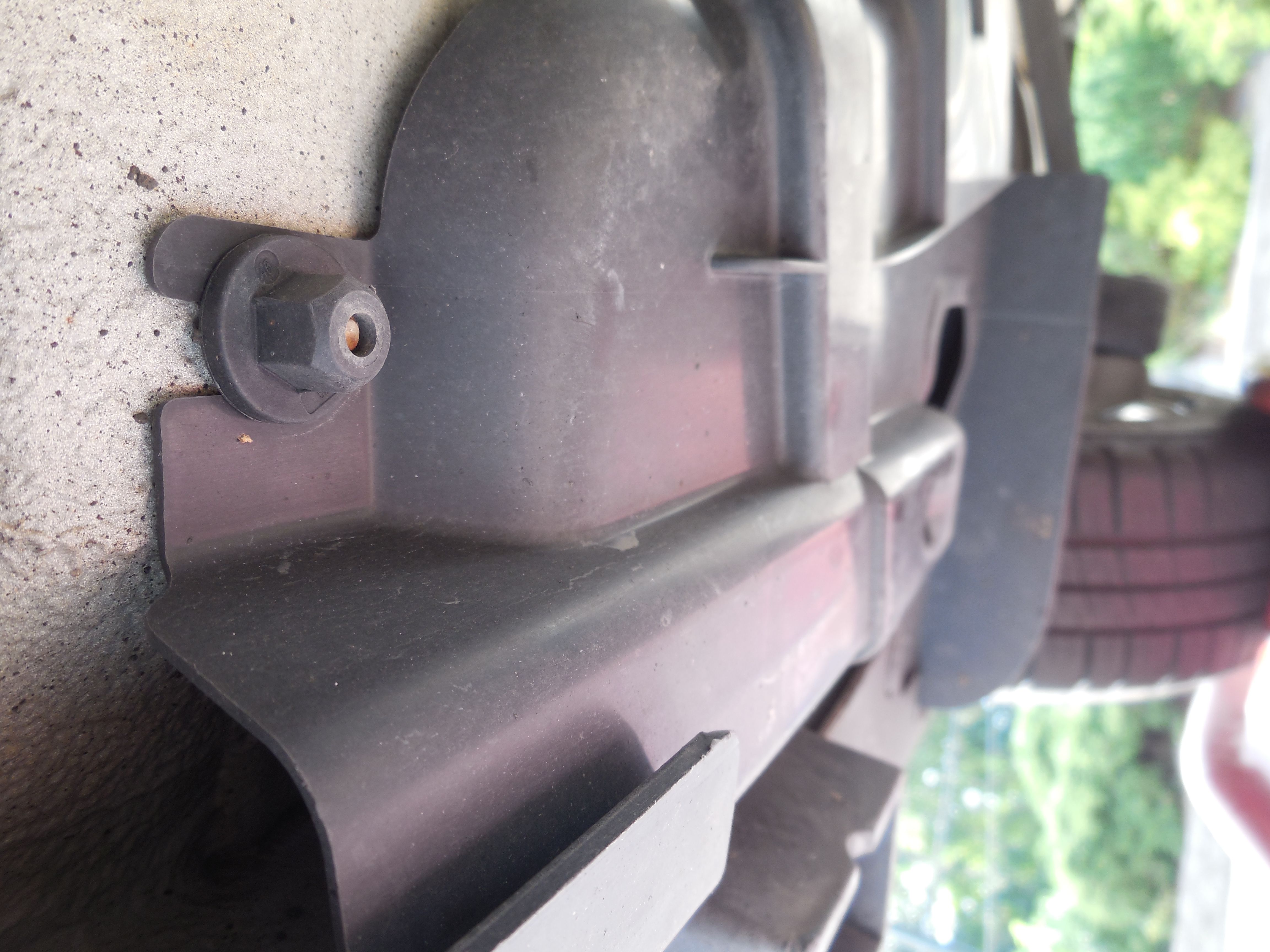

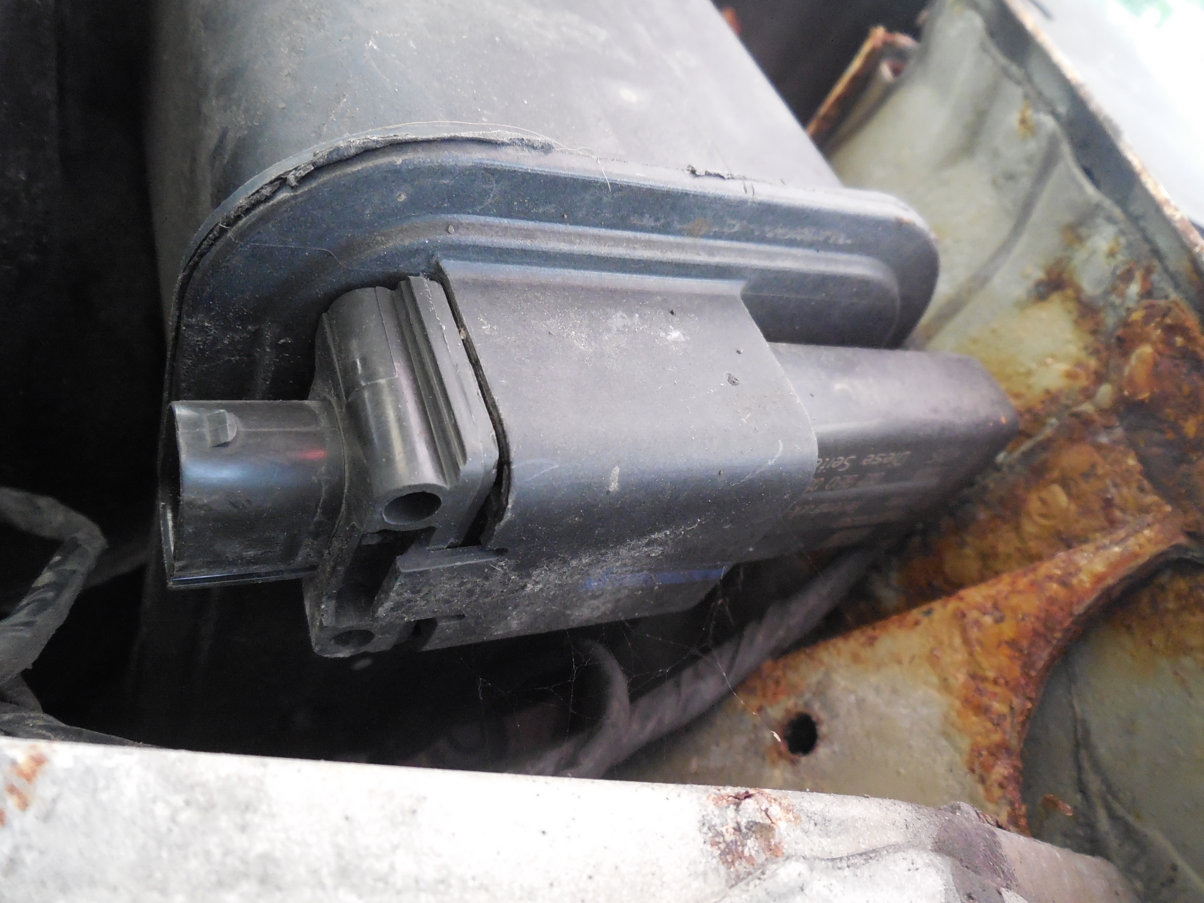

The TPMS antenna is mounted under a black plastic cover on the underside and in front of the passenger rear wheel. Easy to get to and swap out if that is the problem.
