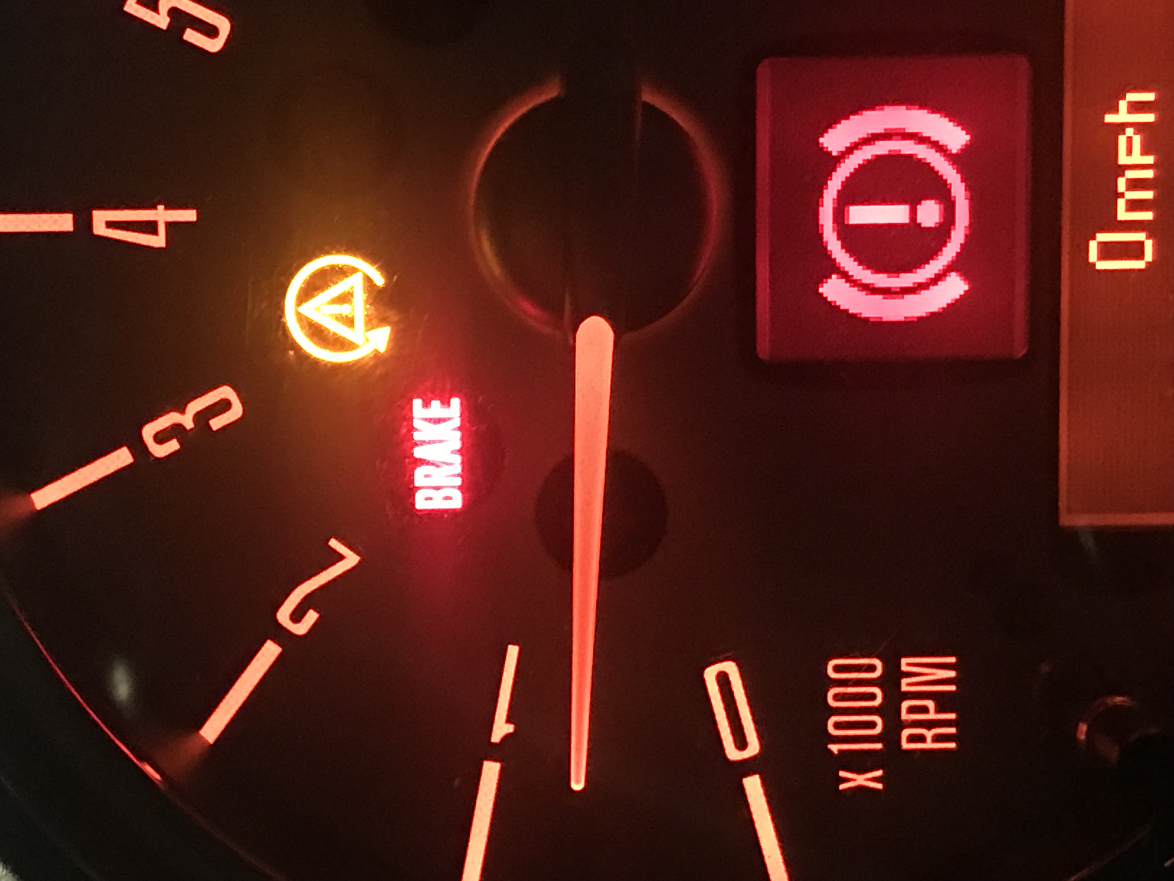

Indicator light need help
Red brake light and yellow traction control light on. Please help before winter ic comes. I cleaned wheels speed sensor but still

The red brake light means your parking brake is engaged. It will light up even if you slightly have it lifted so make sure that one is down. As for the traction control when that light is lit up constantly it usually means that the traction control is off. there should be a little dsc button by your shifter and if you press it and hold down it turns off the traction control. If you press it again it should turn back on and the light will go off.

Those lights are on together after I applied brake and it gone after while. I didn’t engage parking brake and I am sure I didn’t turn off DSC

Just to clarify. Are the lights staying on at all times? How often do they come on and under what circumstances?

It used to be 5-10 min and will gone after I start up my car again. But these day the lights staying on even I start up my car.

It seems like a service notification. Did you try the reset procedure outlined in the thread I provided?

I did but nothing happened. So , I am looking for to replace brake rotor and pads. Hope will help

If your brake pads are extremely low, you may be tripping the low level sensor in the master cylinder. When I put SS lines on a previous MINI, I had a small leak that I didn't detect. After a couple of months, the brake light came on. I don't remember if the traction control light came on as well.

I would recommend to pull the error codes from the OBD2 to be sure about what issue we are working with

Yes, I would hook up a schwaben tool and pull all the codes and go from there.

I used Mini scan tools and it showed LOW BRAKE FLUID. I topped it up then lights gone. Good luck
