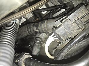

Hey folks - so i recently replaced my broken/leaking at-the-seam coolant overflow tank with an aluminum one. this was prompted by the engine temp hitting red line last week on my way home from work and finding the coolant tank to be bone dry. I immediately re-filled the coolant tank and waited for the temp to go back before driving home. Did not drive the car until i replaced the overflow tank a few days ago.
After installing the new tank, i just filled it up with ~1/3rd gallon of coolant (the level was a little less than halfway filled). Note: I did not bleed the system.
I drove the car for a few days and it was working fine - no leaks, no issues 0 i thought my coolant leak days were over! Sadly not. My wife called me after running some errands last night and said she noticed the temp gauge starting to rise (i'd advised her to keep an eye out for that and leaks). She was around the corner from my house so she just drove the car home. When i checked on it about 30 min later, there was a fair amount of coolant on the floor and it looked like the tank had boiled over. The tank was empty.

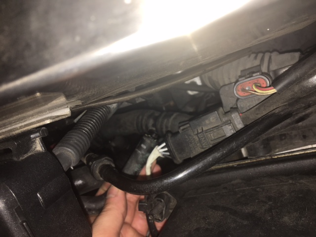

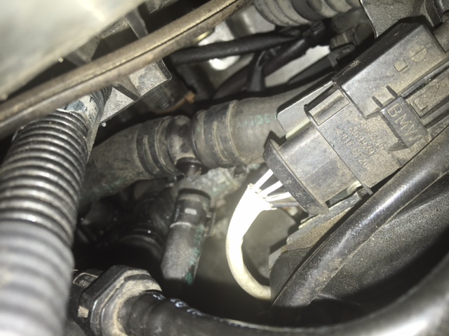

I spent a few minutes inspecting for other issues and found in addition to leaking from boiling over, the hose that runs from the upper part of the overflow tank and connects to another larger hose near the thermostat housing? had broken off!
So here are my questions:
1) Which part do I need to replace here?
2) What could have caused that to break?
3) Is the boilover related to this breaking?
4) Do i need to bleed the system properly?
5) What else should i be checking?
Thanks all!

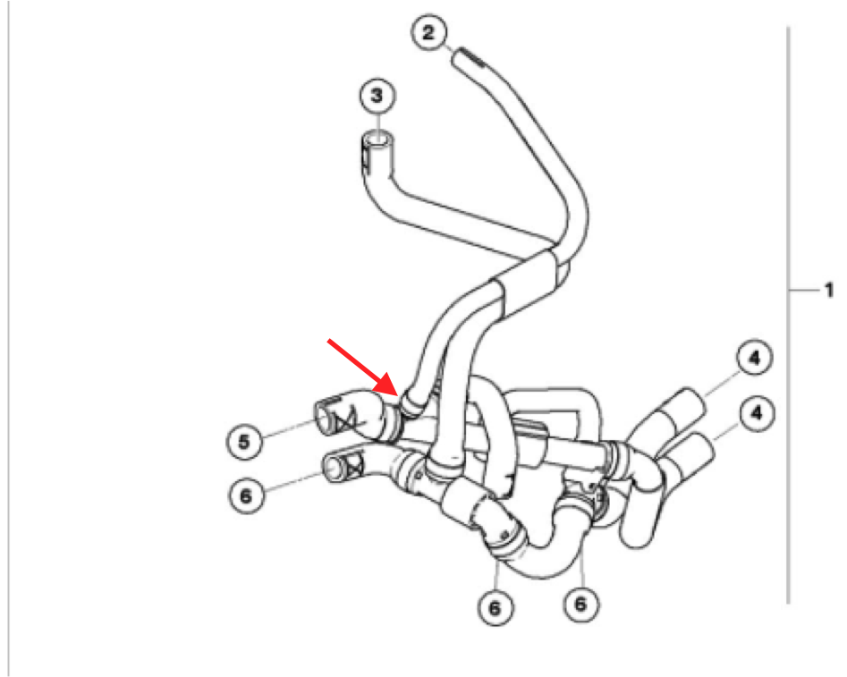

Looks like this is the part that broke (https://www.ecstuning.com/b-genuine-...r/17127518614/). It's the t-connector that connects the overflow to the water pipe?
Any chance this is just a coincidence or could this have broken off due to air in the system since it wasn't bled?

Maybe but overheating, ruptured coolant reservoir, then a burst hose would indicate to me that you may have a) bad thermostat b) bad water pump c) bad head gasket. Suggest you replace the burst hose, refill, bleed the system then perform a pressure test on the cooling system. If it passes, bring the car up to temperature and check your upper and lower hoses to see if the thermostat is opening. If the cooling system passes, then do a compression test.
