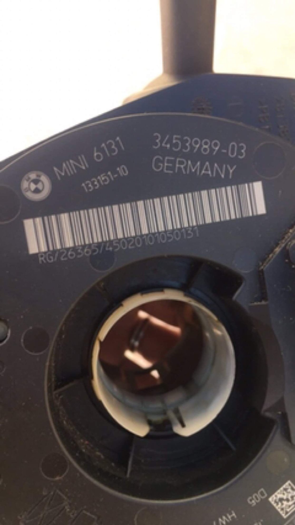

I guess even if you replace the hall sensor there will be other damaged components.
The best option is to be patient and keep looking on eBay for exactly the same model number SZL. After that is installed, it is possible to code it to the car, although usually not by main dealer. Look for someone who does BMW autodiagnostics and remaping etc..
P.s. are you sure this is the original szl for your car? Somebody might have changed it for the wrong model.

i really appreciate your reply
The original SZL ref is :61313453989-03
the replacment part is : 61313453989-04
i do have all Bmw diagnostic Inpa ncsexpert winkfp.... with D-can cable
but my concern if the reference end by 03 & 04 make difference?
Thats the original Szl

The -3 and the -4 on parts are usually the internal revisions of the same part by MINI/manufacture

I think I emailed 'Global Parts' in the UK and they checked my VIN number against the correct original part. Or maybe I emailed the main dealer, I forget it now.
They confirm like: ASC not DSC, xenon head lights, no cruise control, rain sensor etc.. Everything they said was correct for my car.
It was not the SZL part number that my car had installed, so I knew somebody had changed it before me. I think this explained my DSC signal error, becasue DSC was not on my car, I had ASC. However the SZL also had a 'internal fault'. Best to confirm the part number and buy replacement then code.
