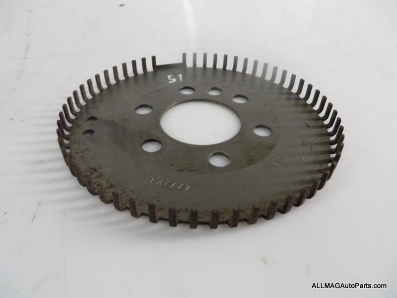

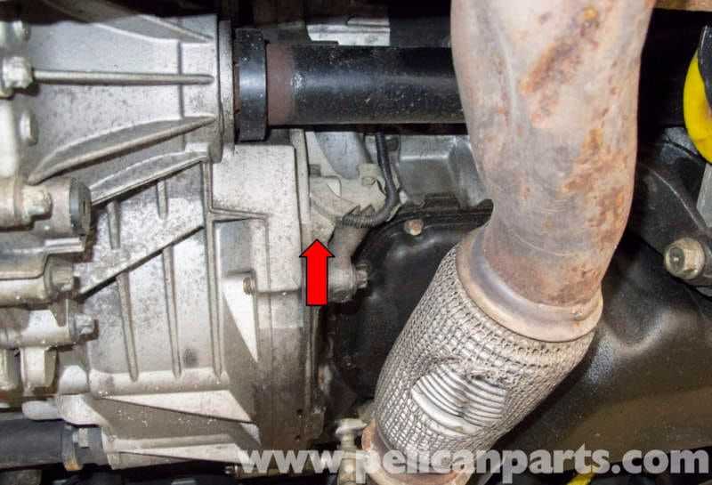

Underneath, in "bellhousing" near motor, there is a cover with a sensor in it, remove sensor it will reveal the reluctor attached to ring gear/flywheel, mark where it is, If you turn the motor over by hand to go full 360, check the pins. In my case, 3 pins were bent. Good Luck

Here is the actual position on engine.

R: Where are bent pins.
This images may answer your question. I posted two replies earlier with the images. You can see the pins.
The pins visible

Oh my gosh!!!! This was my problem! I spent FOUR MONTHS and close to $2000 on parts and tools troubleshooting my crank/no start problem following a clutch replacement. I pulled off the plastic cover under the car and spun the flywheel a few teeth at a time. I found 3-4 pins SLIGHTLY bent on the flex plate. I’m in the south and I couldn’t find a shop that would even look at my car. It was fix-it-myself or sell-it-for-parts. I’m so glad I found this post!!! It’s a great car that I’ve been fixing up for a while.
