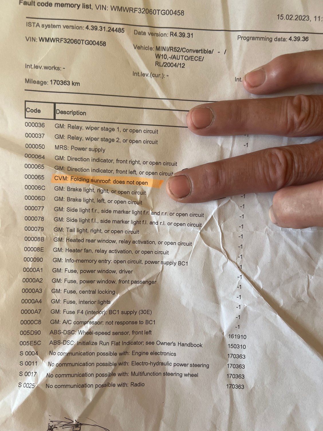

Hi everyone,i have 2005 mini cooper convertible roof is refusing to go down. I have no noises no lights flashing the windows don’t go down on sunroof switch but does on all others The micro switch in boot clicks okay when I go to activate the roof I get no lights on my micro switches at all no flashing nothing and if I put headlights on, I can see a faded light in switch so I presume there’s power also not sure how to remove sunroof micro switches if somebody could help with a diagram was thinking some solenoid in quarter panel as i took to mini and they didn’t have a clue and fuses are okay so
This is the paperwork Mini dealer gave me to says roof not opening. Ridiculous.

Old Feb 20, 2023 | 09:15 AM
Posts: 36,744
Likes: 2,542
Hello,
Yes they should be able to tell if the roof motor does not work or if its a hall sensor that bad.
Its hard to diagnose without a fault code which is an internal code, like something our schwaben scan tool would pick up.
