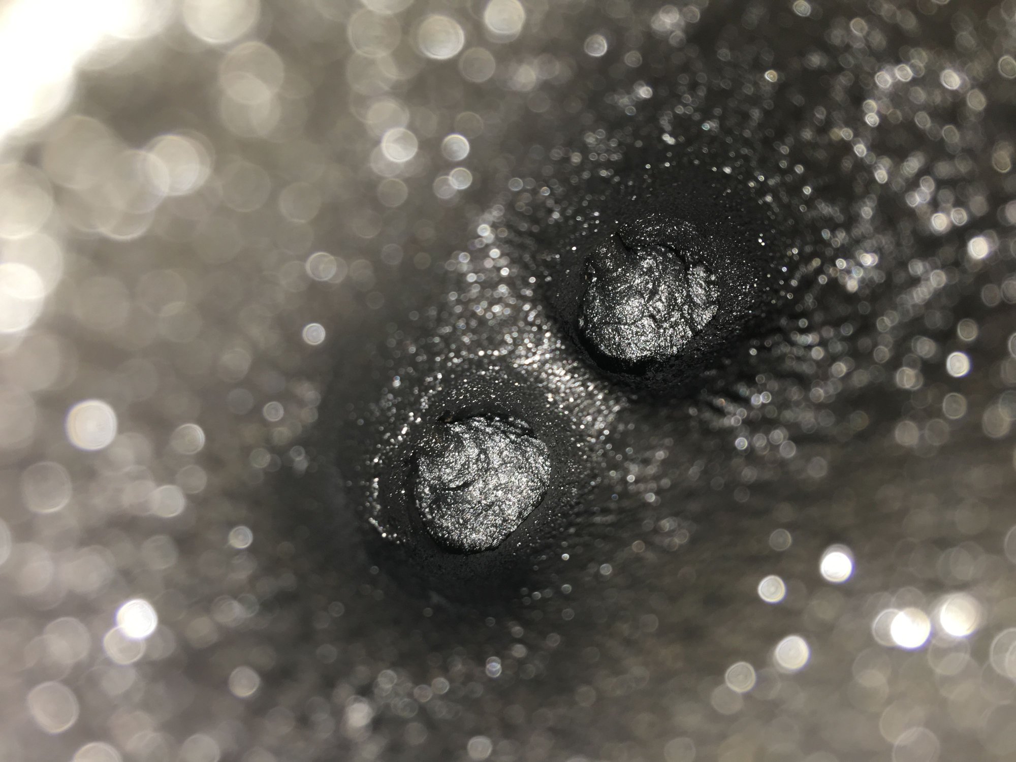

Got another 2007 r56 with 113k on it and with burned exhaust valves on cylinder 4 (ones close to turbo). Plus off course timing chain failed.

Next day i got insurance. Went to pick the car up. Started it and everything was fine for 3 minutes. Than... massive misfires, check engine, almost dies on idle... i think head gasket need to be redone. Or instripped the thread in the block, or messed up head gasket somehow, or i dont know...
I need to crack it open again and put it back together (((

Intake before
Head before
Exhaust valves
Cylinders cleaned up
Intake after
Rebuild head
