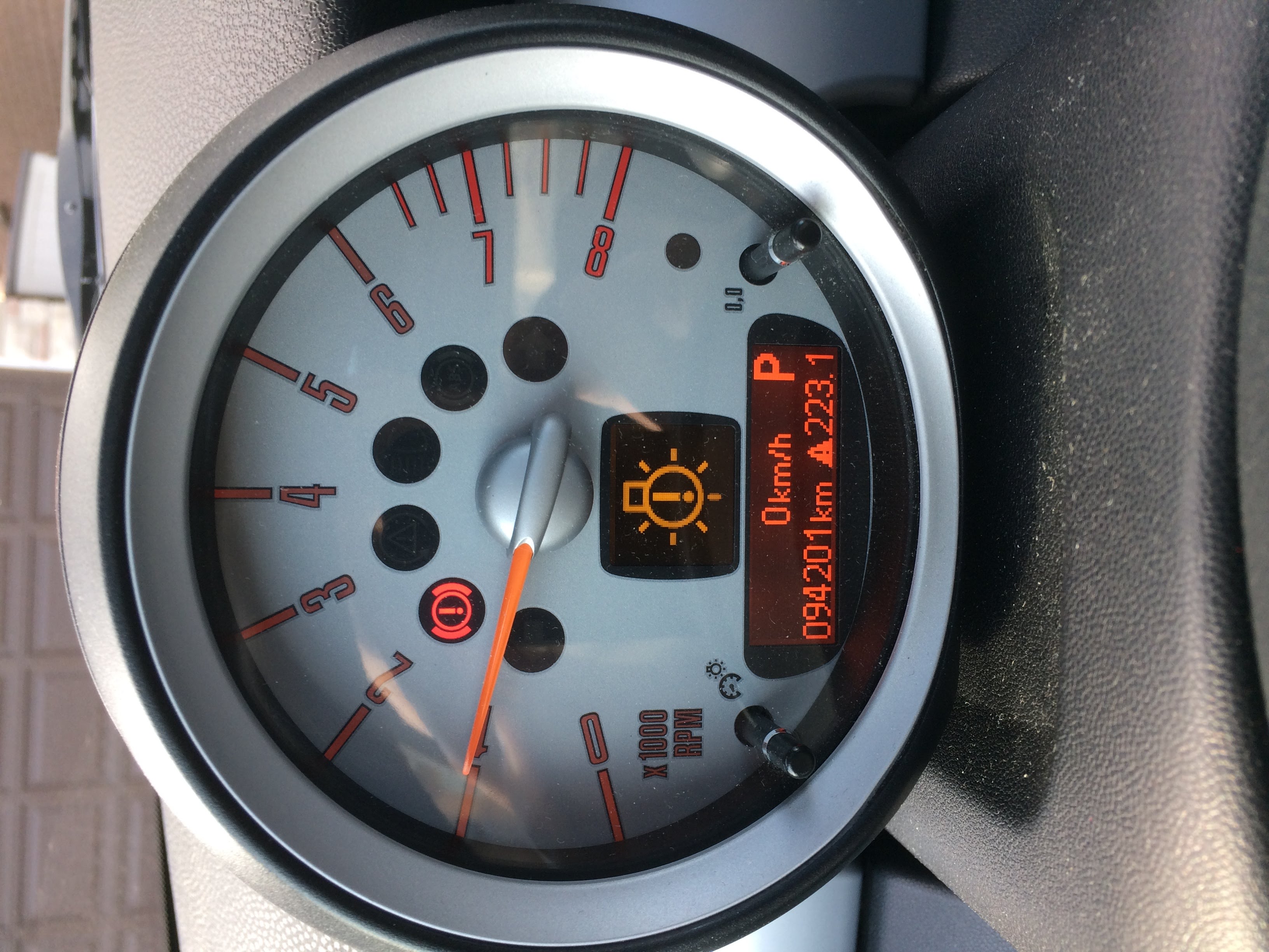

any resolution to this? Having the same issue. Don’t see a bulb that’s not working. Did you fix the brake light bulb and did it get rid of the light?
