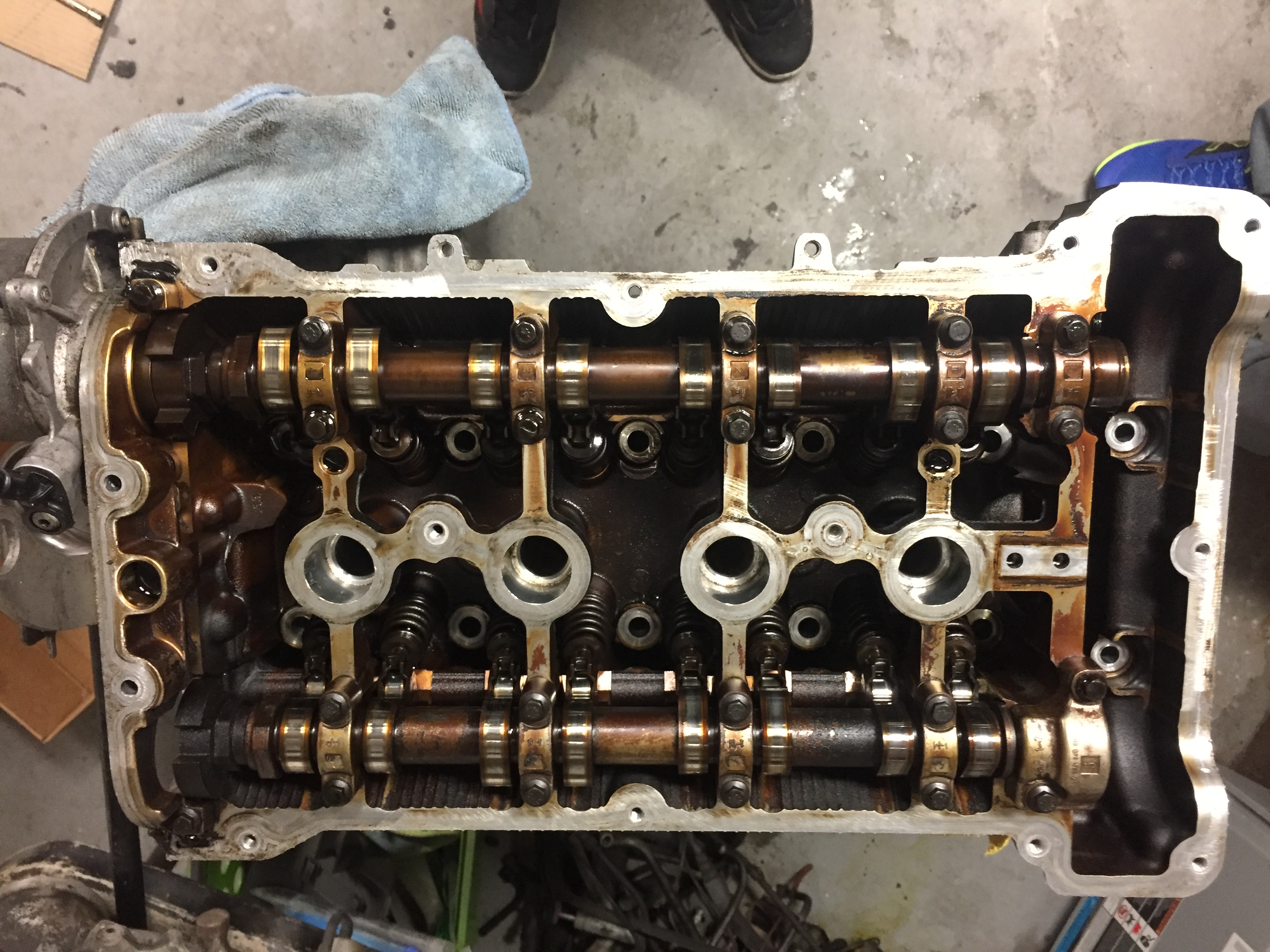

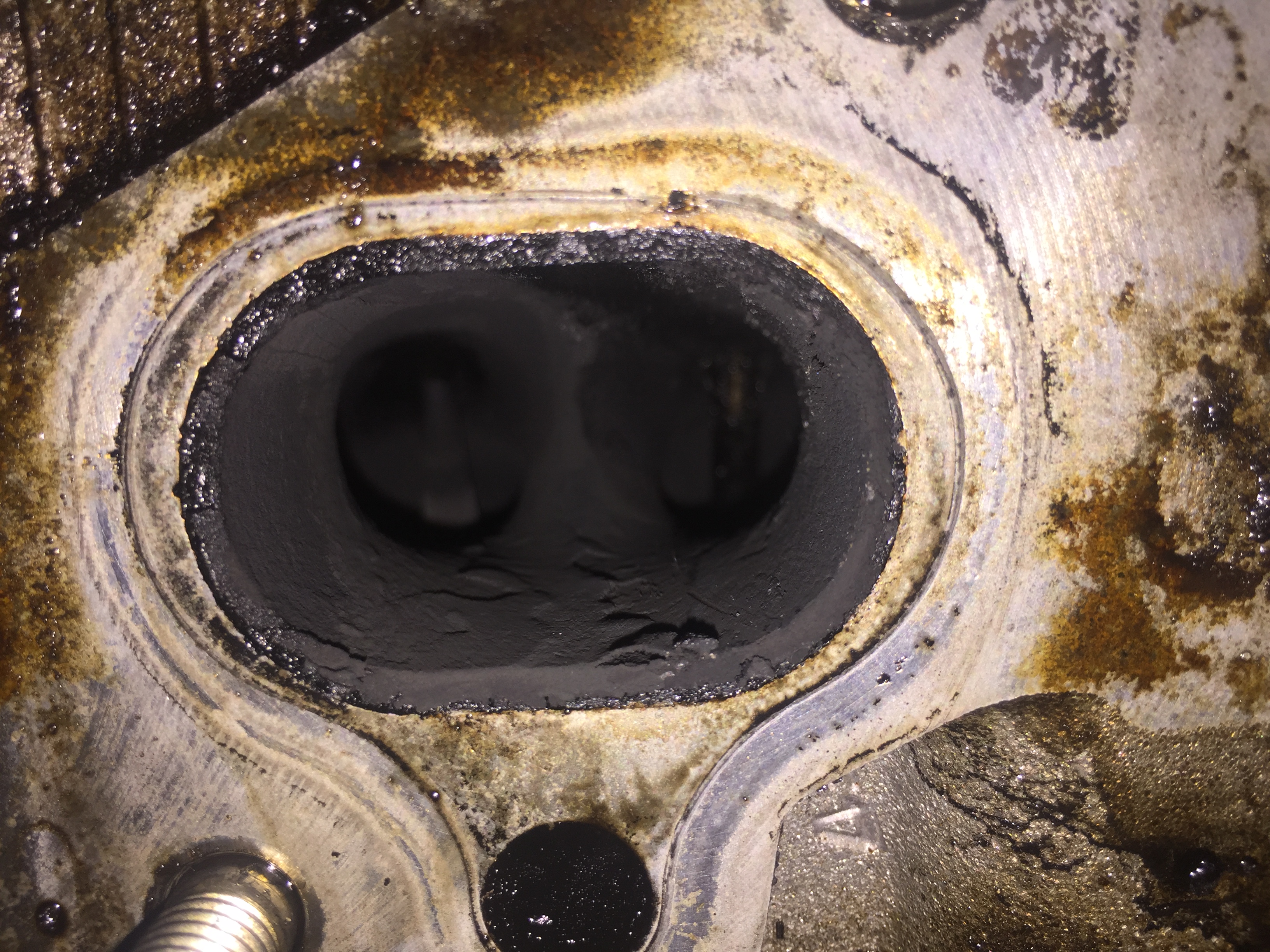

those are exhaust valves it should be like this>>???

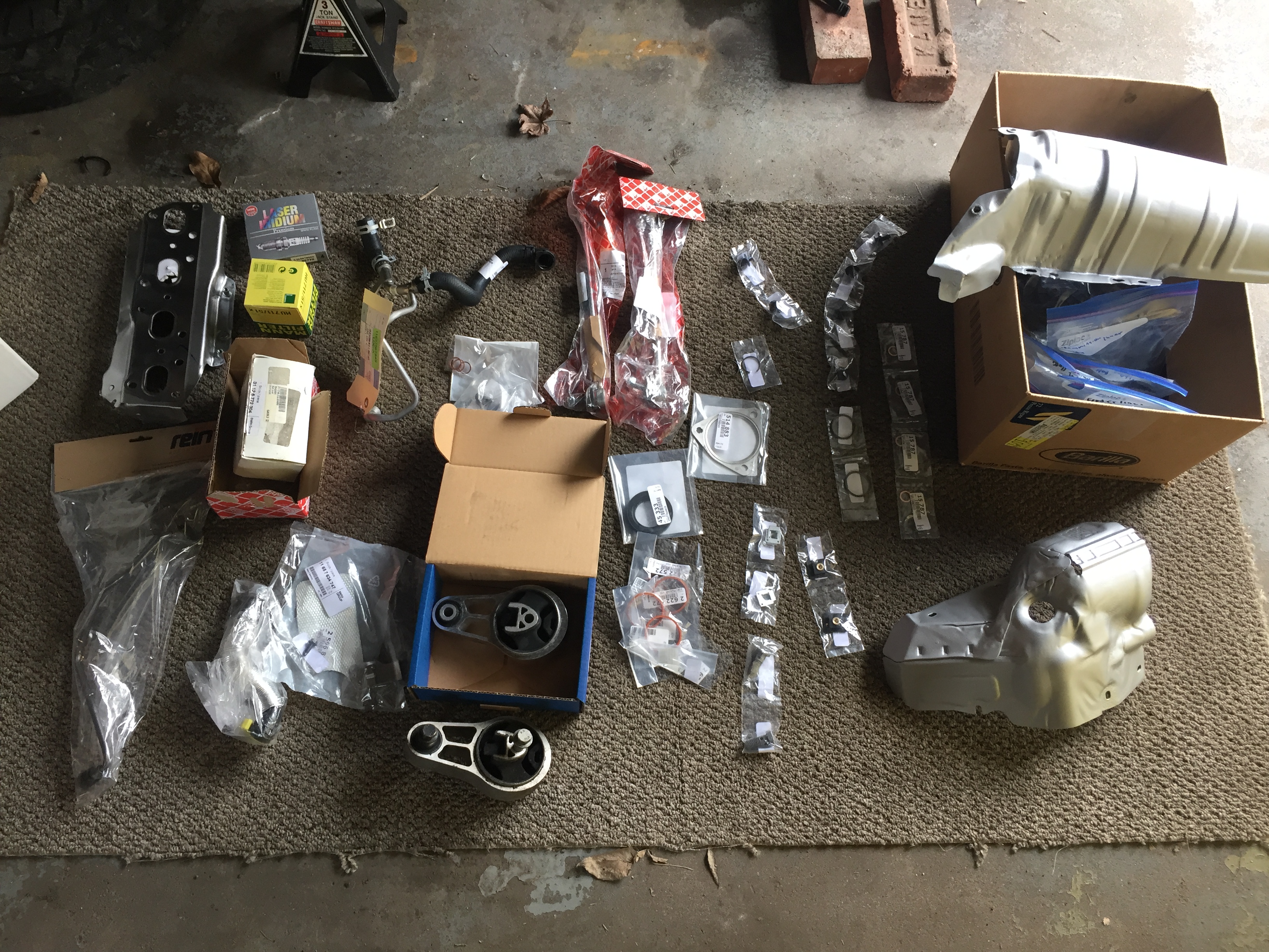

sorry for late update
heres the pics , everything was went perfect when i putnew engine in, no error lights at all, i was surprised! car runs like dream

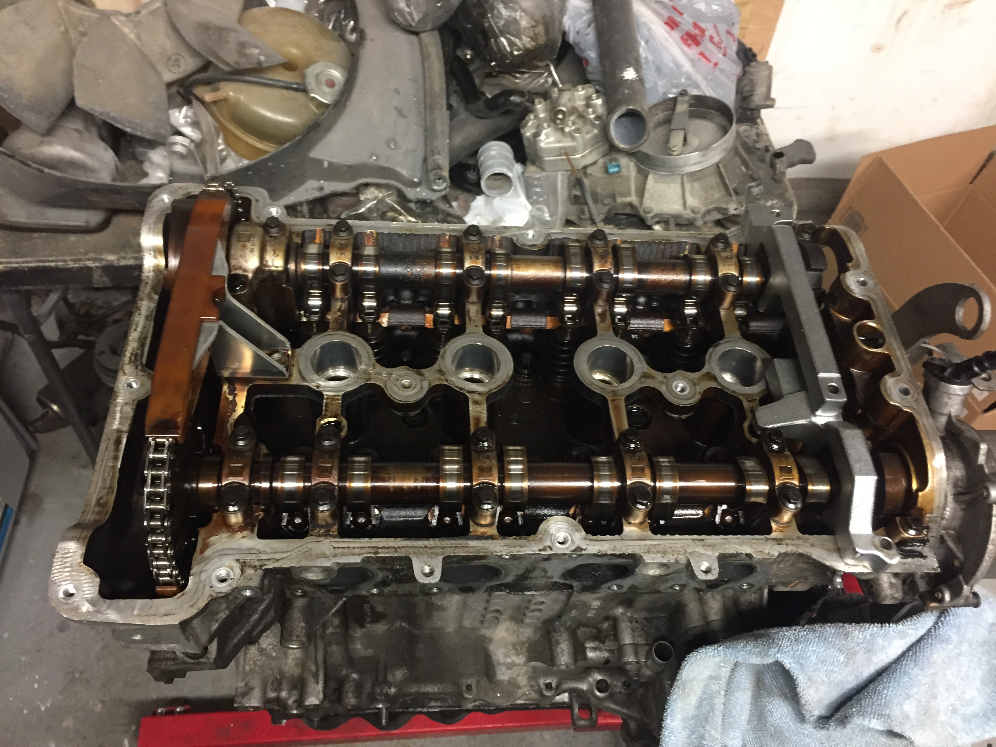

heres what i found inside. my first thought was that timing jumped and that caused problem but i was wrong, when i opened engine timing was perfect, chain, guides, was just fine.there was a lot build up
Attached Thumbnails 07 MCS R56 Engine Blow At 99700ml-img_3041.jpg   07 MCS R56 Engine Blow At 99700ml-img_3040.jpg   07 MCS R56 Engine Blow At 99700ml-img_3223.jpg   07 MCS R56 Engine Blow At 99700ml-img_3224.jpg

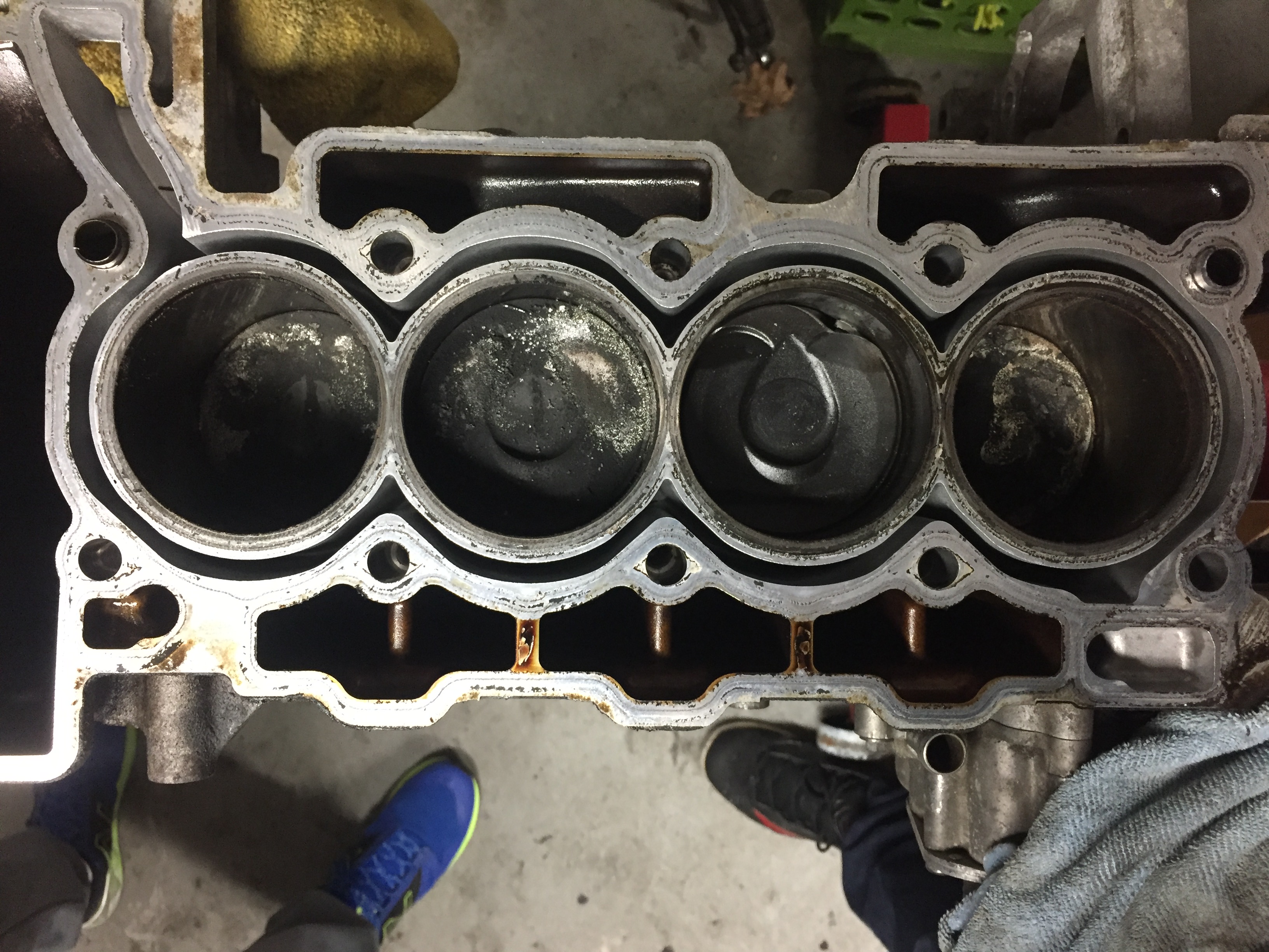

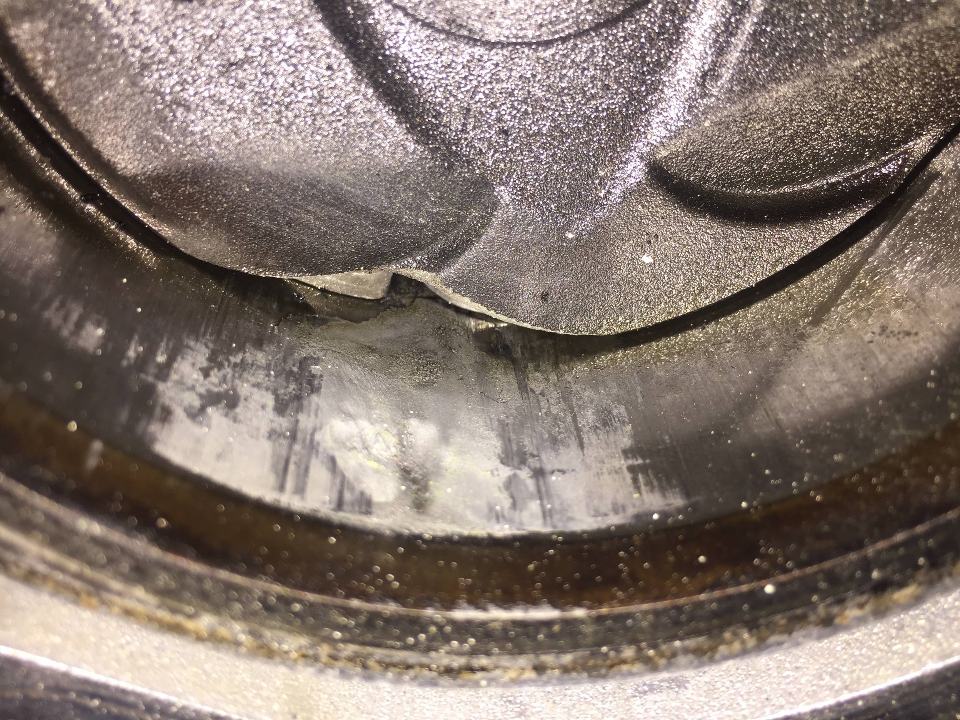

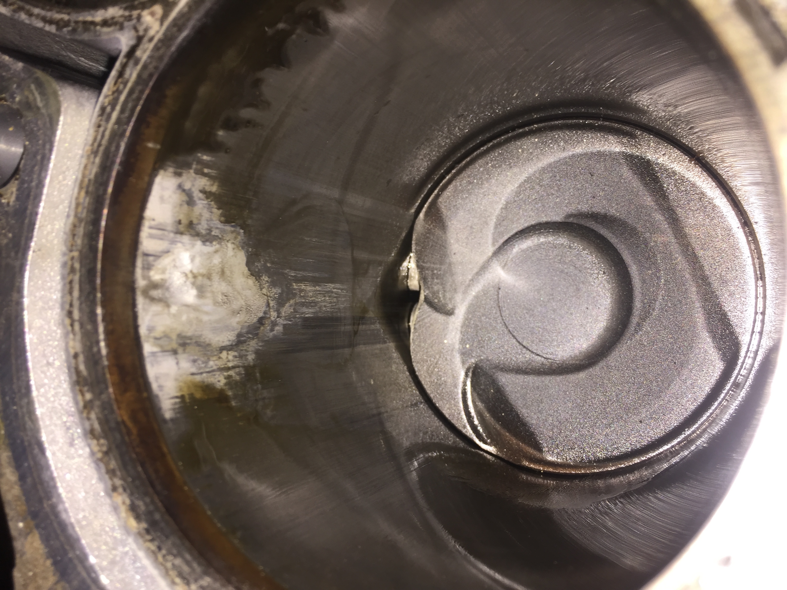

cylinder block
Attached Thumbnails 07 MCS R56 Engine Blow At 99700ml-img_3226.jpg   07 MCS R56 Engine Blow At 99700ml-img_3228.jpg   07 MCS R56 Engine Blow At 99700ml-img_3233.jpg   07 MCS R56 Engine Blow At 99700ml-img_3237.jpg   07 MCS R56 Engine Blow At 99700ml-img_3238.jpg

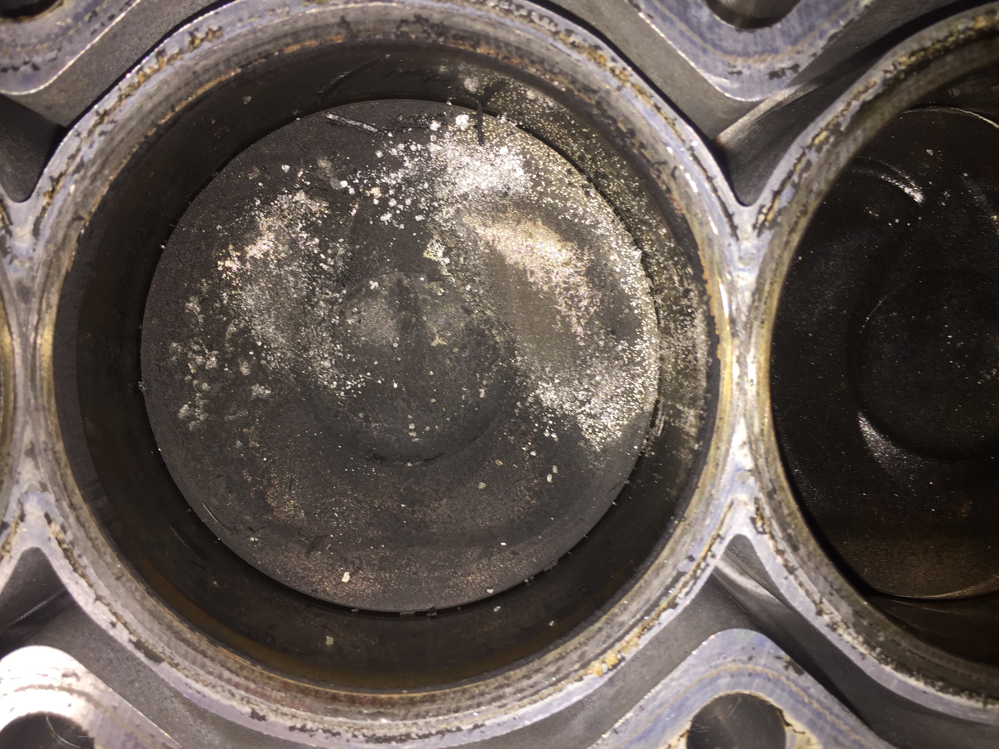

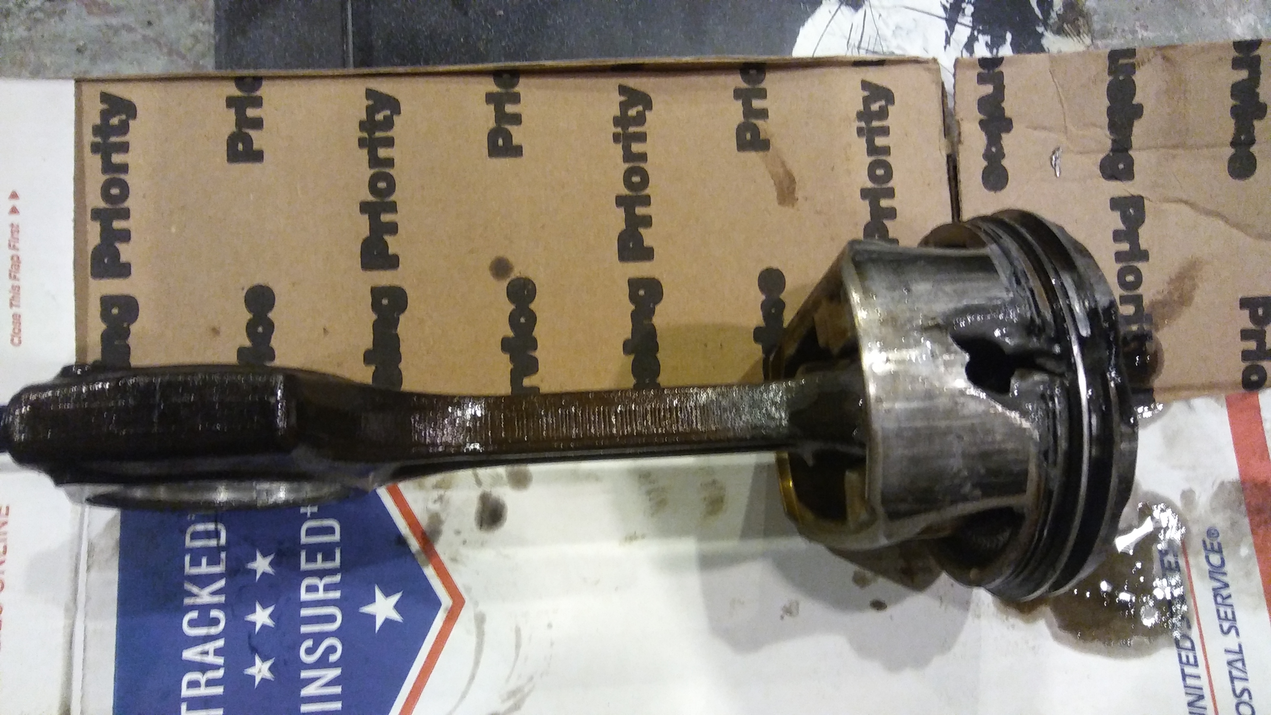

heres the cylinder piston #3
