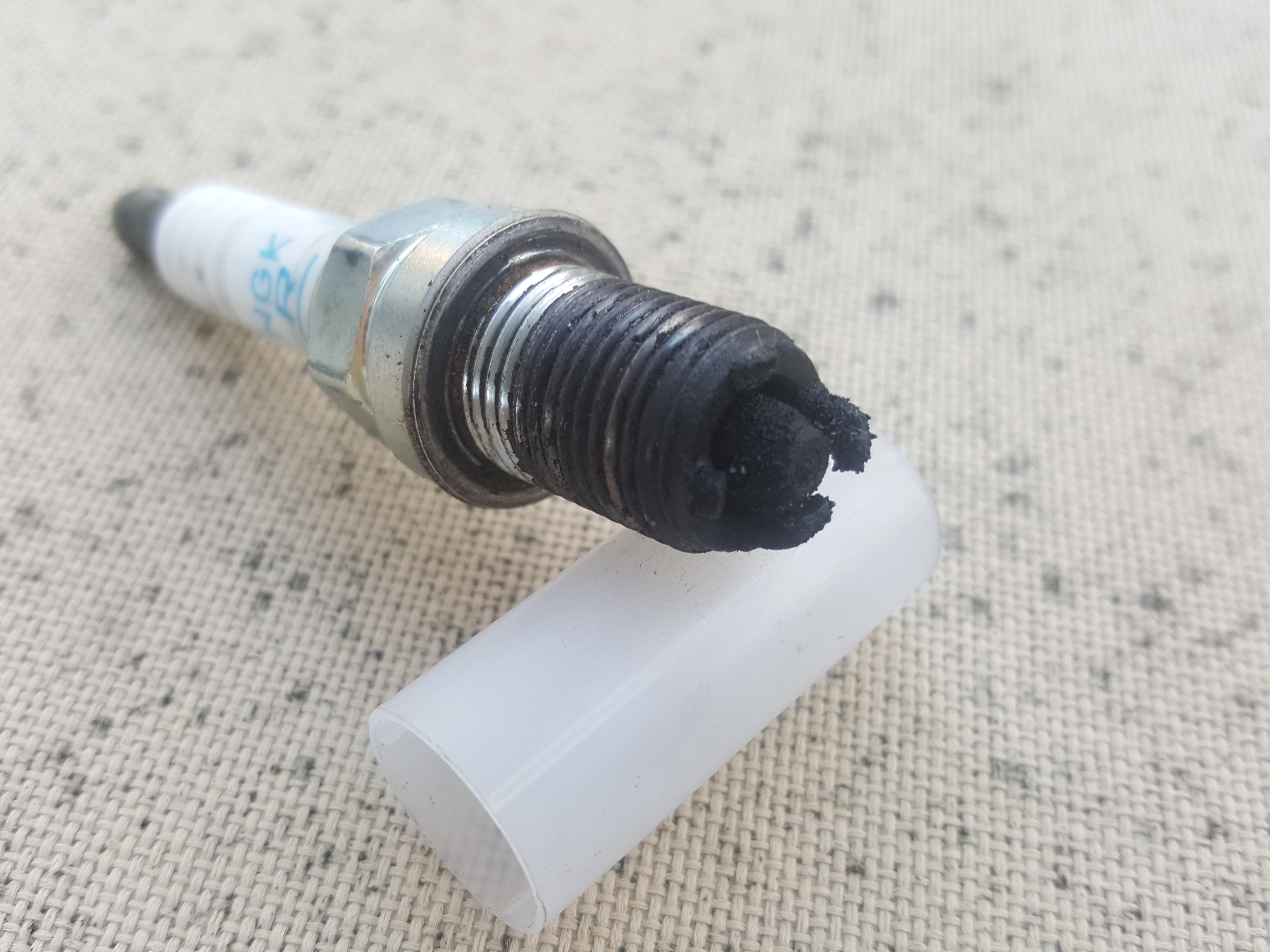

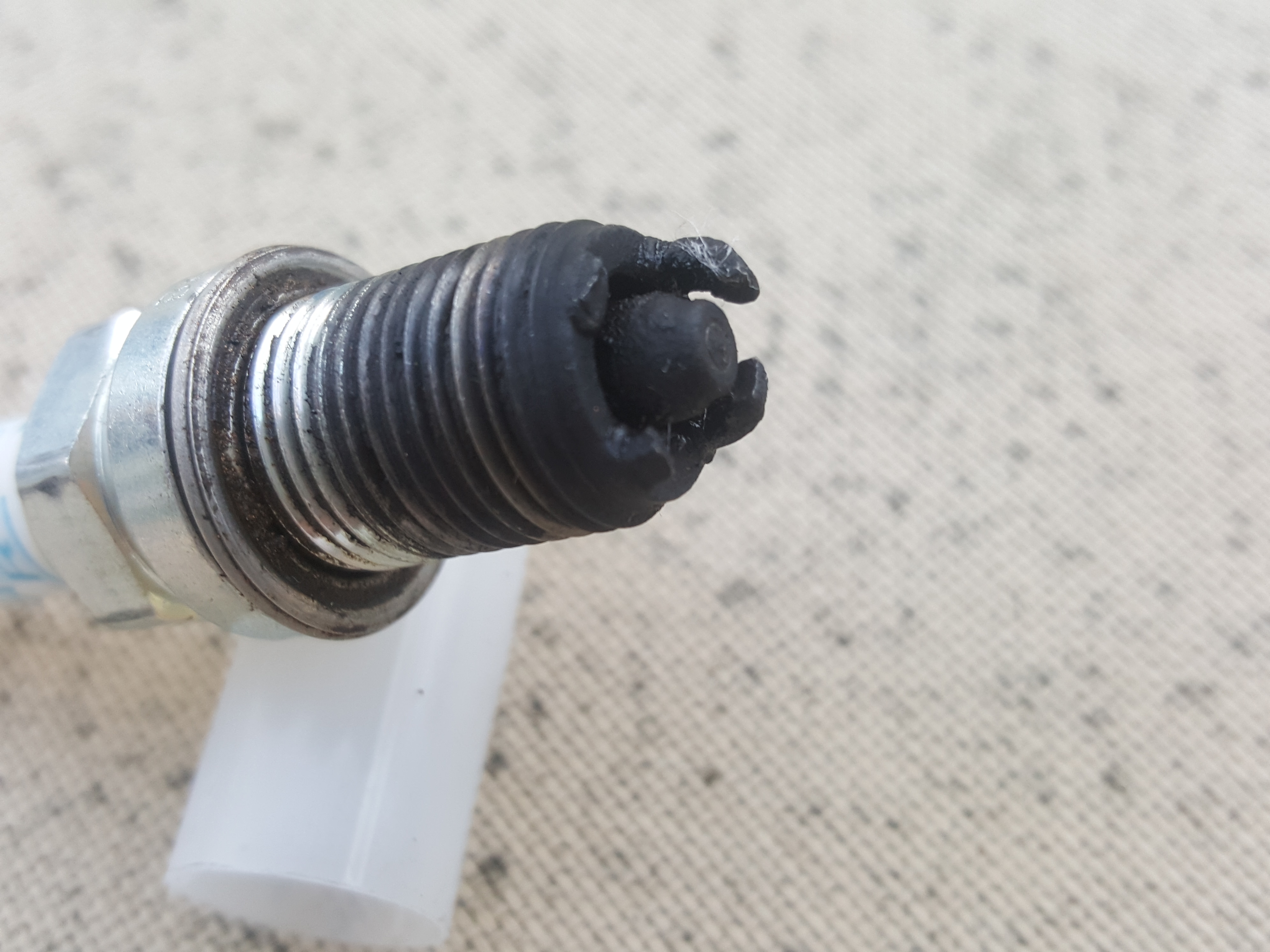

I removed the valve cover and the rocker arms to have a better view on the valve springs. The springs not broken or damaged.
I found however that the spark plug on cylinder 1 was badly covered with oil build-up. Further, 2 ground electrodes (out of 4) were missing (broke-off). I suspect this is the cause of the no compression on cylinder 1. I suspect the ground electrodes that broke-off caused the damage to the piston and/or valve. Of course I will need to remove the head to confirm, but the fact that I have no compression on cylinder 1 makes me conclude that this will need major repair.
Any similar experiences that you can share would be appreciated. I am hesitating to proceed any further at this point given the mileage (160,000), the cost of repair and the resulting value of the car.

Good to know about a used head. If I open up the head I need to be ready to commit on what to do if in case the cylinder/piston is affected. Right now I cannot afford without a ride. That is why I am using it as is and buy time till April next year. See pics attached. One looks like just after removing from head. The other after cleaning for a clearer view. Do you think the broken off electrodes could have caused damaged to the cylinder?
Attached Thumbnails Missfire/zero compression issues on R53-20161101_170945.jpg   Missfire/zero compression issues on R53-20161101_171707.jpg

There's a fairly slim chance that the car will make it til next April being run in its current state, as well as you'll be doing more harm to the engine which will increase your cost to repair in the long run.
Start with a leak down test to see where the compression leak is. Most common failure in this case is going to be the exhaust valves. I've seen cars that have ingested more particulate than that and not have piston damage.
