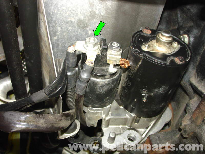

Originally Posted by 2004minicooper
...I got a new alternator, new belt, new battery and a new starter.
You mentioned a new starter...
Make sure you have the starter connected properly.
I seem to recall a past thread where someone's brand new battery couldn't keep a charge, and they assumed it was the alternator. It turned out that they had replaced the starter and thought they had it wired correctly when they did not. It had something to do with mistakenly putting the two large leads on separate posts rather than doubling them on the same post, which is where they should be.
When they were installed incorrectly, there was a constant draw on the battery (even new ones) that didn't allow the engine to start.
I'm on my phone, so not exactly in a position to research this fully and provide links to that thread, but your problem seems very familiar.
I dug up this pic showing how the wires should be connected to the starter.
Good luck and please report back.
