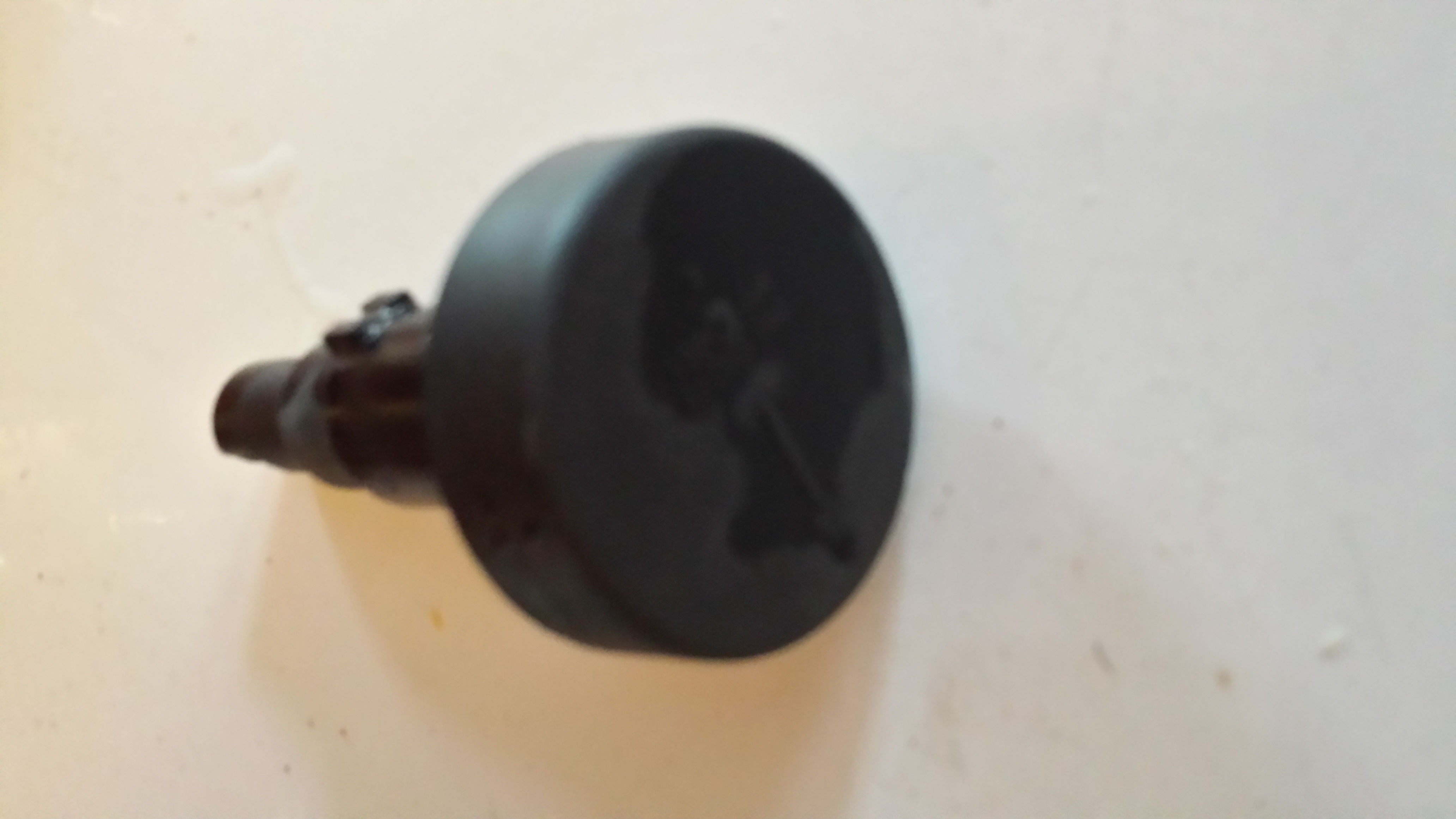

Before I install the cylinder, I wanted to ask; whats the vent-looking covered tube thing on top of the transmission? It pulled right out, and I cleaned it, then found there was an arrow. Which way is it supposed to point upon installation? Is there supposed to be an O Ring on it too? Because I found that some of the ick close to the top of it was hard, almost like an old hardened O ring.

Thats a vent cap for the transmission, just snap it back in. Its just vents , that it.
