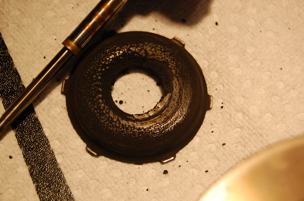

This is the shield that resides behind the turbine. Note the excessive buildup of carbon and coked oil residue.

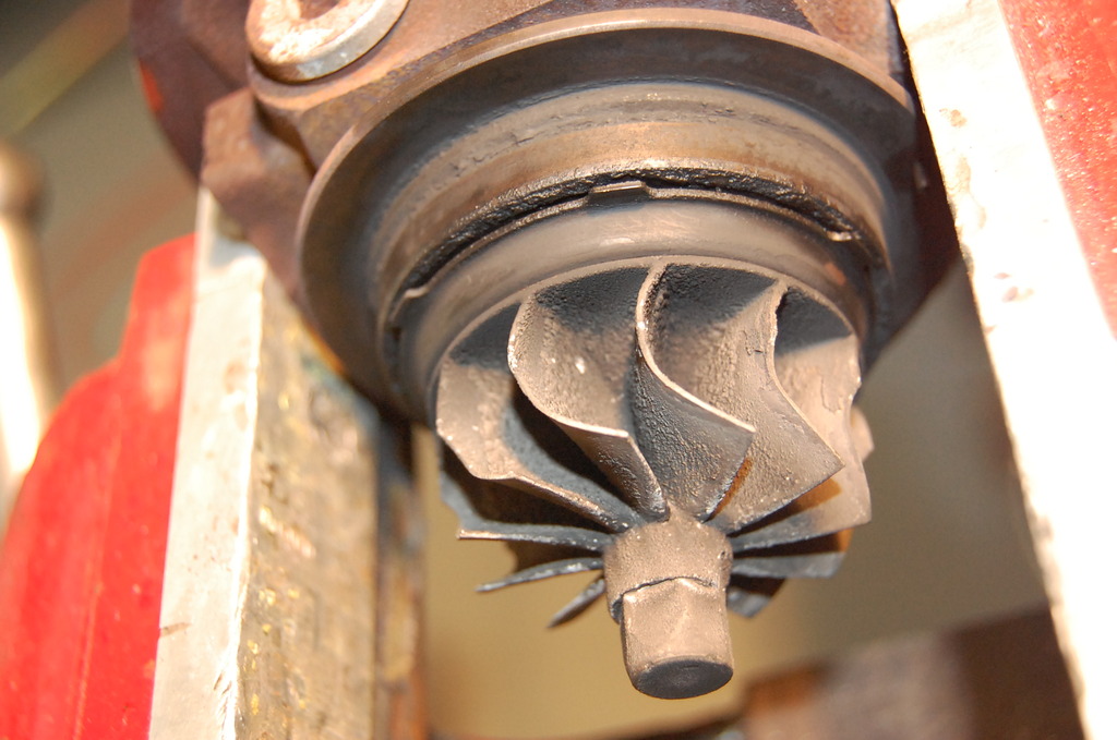

Here is the turbine, loaded with carbon buildup.

Check out the crud on the seal behind the turbine!
