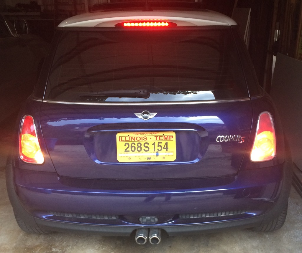

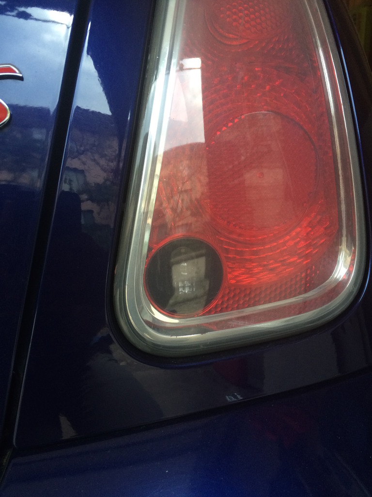

Secondly, One of the rear reversing light housing/bulbs looks smoked out, yet works fine. I am not sure exactly what is going on there either. It may be an aftermarket headlight, but the PN on the lens appears to be the same. Here are some pictures:

That's strange. Kinda looks like it's missing the back reflector.
10mm socket and 2 mins to pull the entire lens out to answer the question.
There's some decent aftermarket lenses out there for less than the OEM ones, and they pop up here for sale in the marketplace often.

I will definitely take off the rear light tomorrow to check it out, missing reflector is what I was thinking as well.

So when I took out the rear light it looks as if someone cracked the lens of, and spraypainted the reverse reflector black. Then they proceeded to superglue the lens back on, irrevecably sealing the assembly. So I will just look around for an OEM replacement.

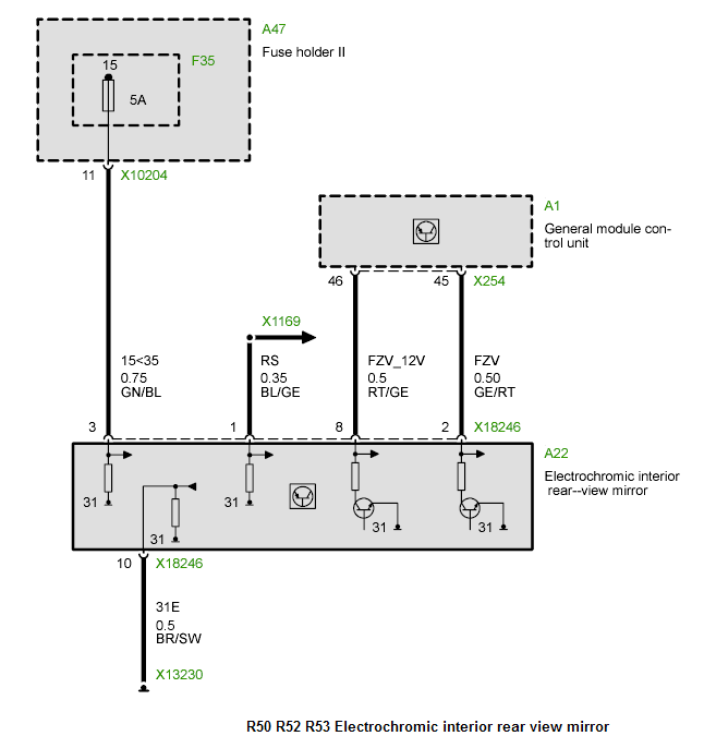

Here's the wiring diagram. The blue/yellow wire (BL/GE in German) is the backup signal, and when the car is in reverse dimming should be turned off. The signals from the control unit may be for headlights on. I might be wrong, but I believe dimming is active only when headlights are turned on.

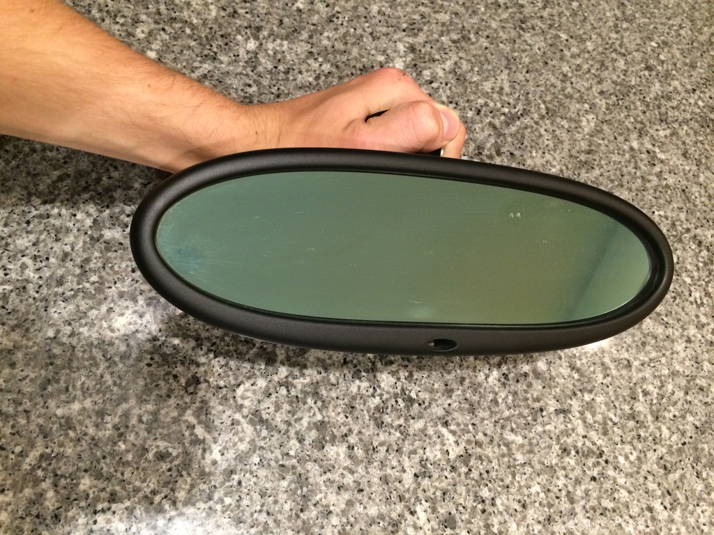

This is what the mirror looks like all the time:
I tried it in reverse, with the lights on, and nothing changes.

Without context, we don't know what we should be seeing in your photo, in comparison to a good mirror.
If the mirror doesn't reflect like a plain, undimmed mirror under any circumstance, I'd conclude that it is faulty and needs to be replaced.
The auto-dim mirror in my 2006 R52 wasn't completely clear in its undimmed state, but I've sold the car and can't give a direct comparison to your photo. My initial reaction is that it doesn't look unusual (maybe others can chime in). When it was dimming, my mirror became much darker than your photo and the effect was very obvious.
If its on its way out they sometimes get brown on the lens around the outside on the review mirror of the photo cell part of the mirror is bad and the mirror will not change ( dim.

For those taillights looks like the reflector or bulb has a black burn on it, sometimes when the bulbs are burned then reattached the filament you get a burn on the inside of the glass on the bulb which then reflects black into the housing.

Thanks for the info ECSTuning, I had already looked at a replacement lens/housing on your website. If you look closely, the left lens is completely clear while the one that was cracked open has fogged. I will definitely be looking at an OEM replacement in the future. Probably will do new bulbs at the same time as well.

When you get the new rear taillights they come with the bulb holder and bulbs, so gets both things fixed.
