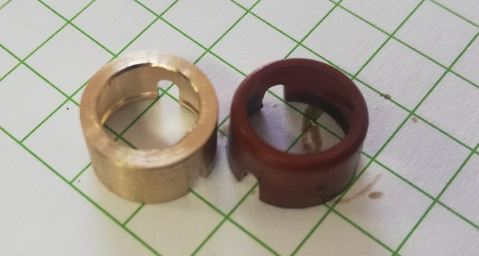

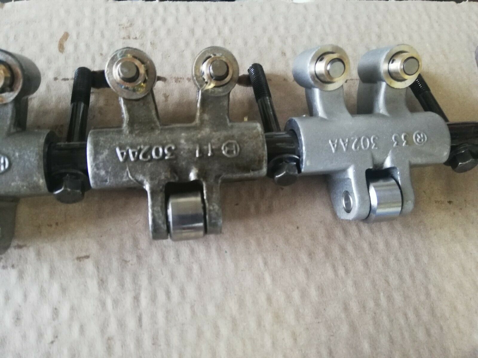

On topic of those plastic clips,
I've read that late 2006+ are fitted with metal variants, so mostly on R52's, if true, perhaps it would would be advantageous to grab the rocker assembly if you come across a 2006+ cabrio at the junkyard...
Also,
there's a guy in Bulgaria who has made some of these clips in brass:
https://www.ebay.co.uk/itm/392939944357
Also,
Hello. Im the guy from Bulgaria. The clips are still avaible. The are installed on my car. So far 30 000km no problem at all.
