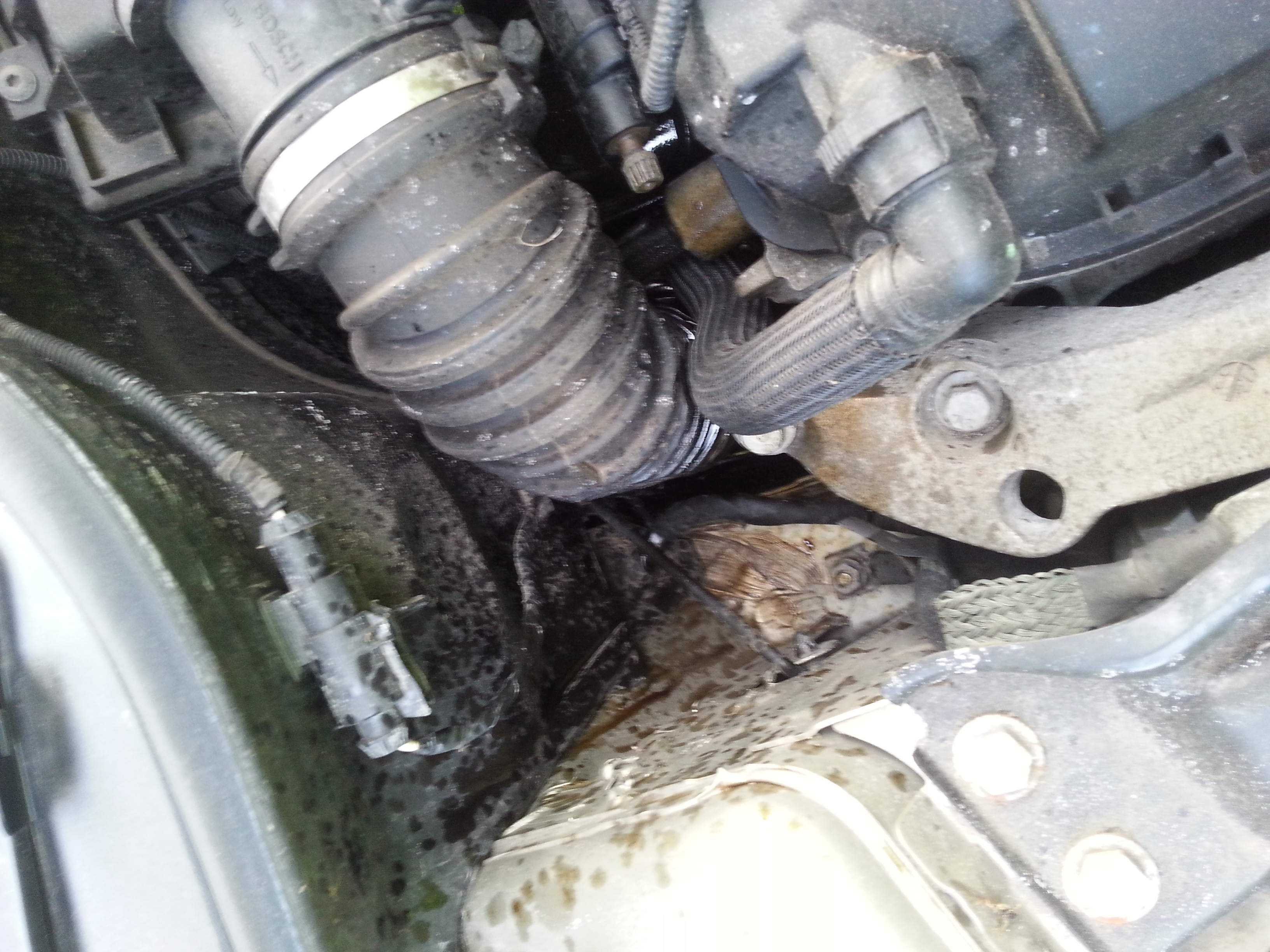

Hi,
My mini is a 09 stock and the other day the oil light came on and when i looked under the hood there was oil everywhere. huge puddle on the floor, and a trail of where I drove. https://www.northamericanmotoring.co...1&d=1434142419

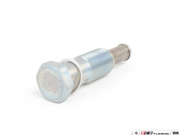

Looks like maybe the timing chain tensioner came out ? clean it up and look more into where it is coming from. Don't start the car or drive it, you have a major leak , ( which you do ). You will stare the engine of oil.
Looks like R56 MINI Cooper S 2009 ( NON S ) :
http://www.ecstuning.com/Mini-2009-Cooper-R56-Base-Coupe-L4_1.6L_N12B16A/Engine/Timing/
Here is the car and part. Please have it looked at by a shop or independent to see if there is something else going on .
Here is the section you need.:
https://www.northamericanmotoring.co...talk-2007-136/

Thanks! Yeah it's a non S. I'm trying to get it out now. Gotta take the throttle body off it seems in order to get the bolt out. Thanks again for the information!
