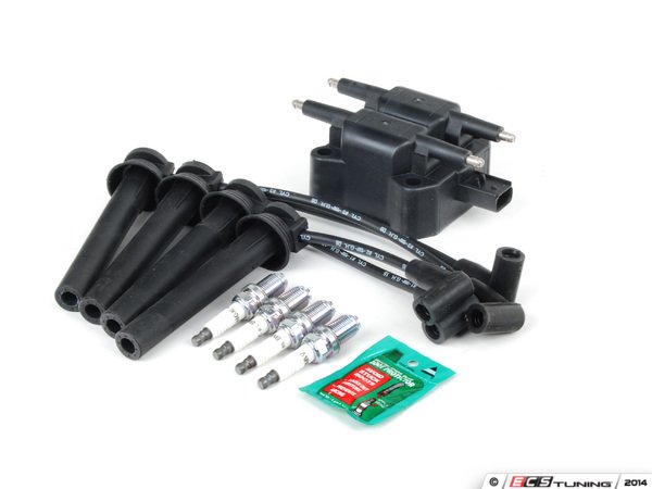

One of the output terminals on the OE coilpack - # 3, I believe - is prone to failure. Happened to me.
Old Jun 3, 2015 | 02:07 PM
Posts: 36,768
Likes: 2,553
Just replace the pack and get the plugs and wires done at the same time.
Watch unbolting the screws on the pack as they can sometimes seize on the nut stud. If they feel very tight , hit the stud nit with some PB blaster.
R53 Cooper S / JCW
http://www.ecstuning.com/Mini-2005-Cooper-R53-S-Coupe-L4_1.6L_W11B16A/Maintenance/Engine/Ignition/
R50 / R52 Cooper ( NON S ).
http://www.ecstuning.com/Mini-2005-Cooper-R50-Base-Coupe-L4_1.6L_W10B16A/Maintenance/Engine/Ignition/
