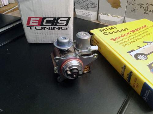

Once you get the codes post them up , for the HPFP there is a bunch of info here:
Your 2009 JCW has the same HPFP as this N14 JCW.
https://www.northamericanmotoring.co...r-r56-jcw.html
